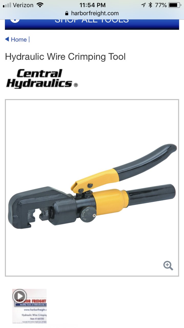

    Just got one of these. Crimped the heck out of a 4AWG lug.... so far works good.

    post a pic of the crimp!

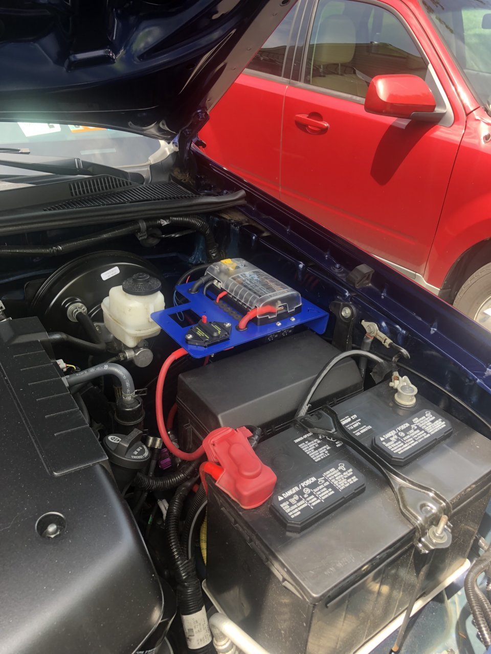

    Already shrinked em up but here’s a finished product - pos and neg terminals for the aux fuse set up.

    When I had my HF crimper I noticed that the die were not accurate to awg standards and I had a lot of flagging from over crimping.
    If you are getting "flagging" on the side of your crimps, then rotate the lug 90 degrees and do a second crimp.
    Just a tip I wanted to share.

    Thanks! A little bit of flagging but not terrible. I may go back and rotate as you've suggested.

    I've always heard it called flagging. Might be a more common term used.
    Here is a picture. Due to an overcrimp of the HF crimper, there are "flags" on each side of lug.
    A proper crimp will look like this.
