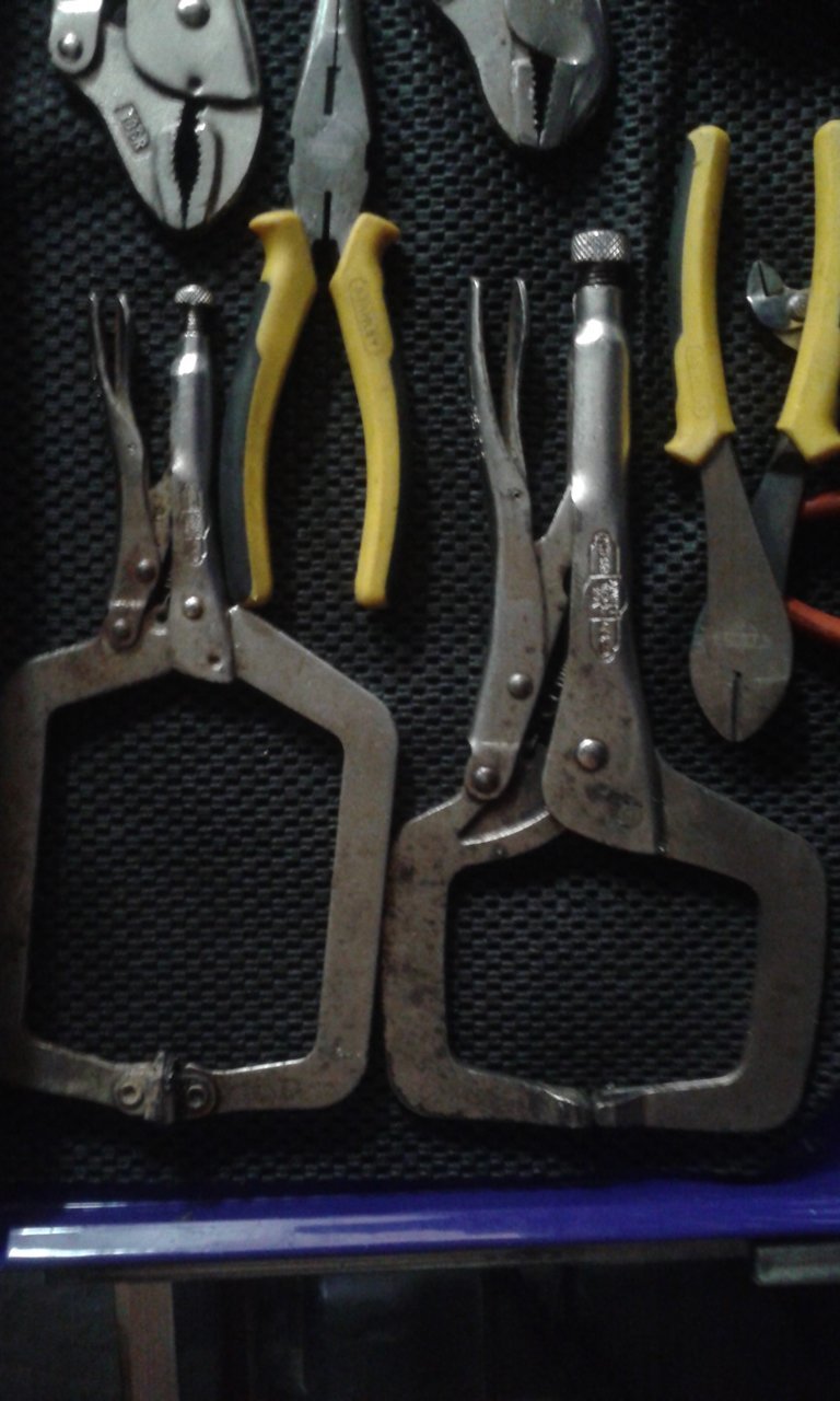

    I use the same one to make aux fuse mounting plates. I actually like using these clamps with it. They’re quick on and off and it helps to be able to space them out or add multiple clamps according to your workpeice. That’ll cure a lot of the flex you’re experiencing.

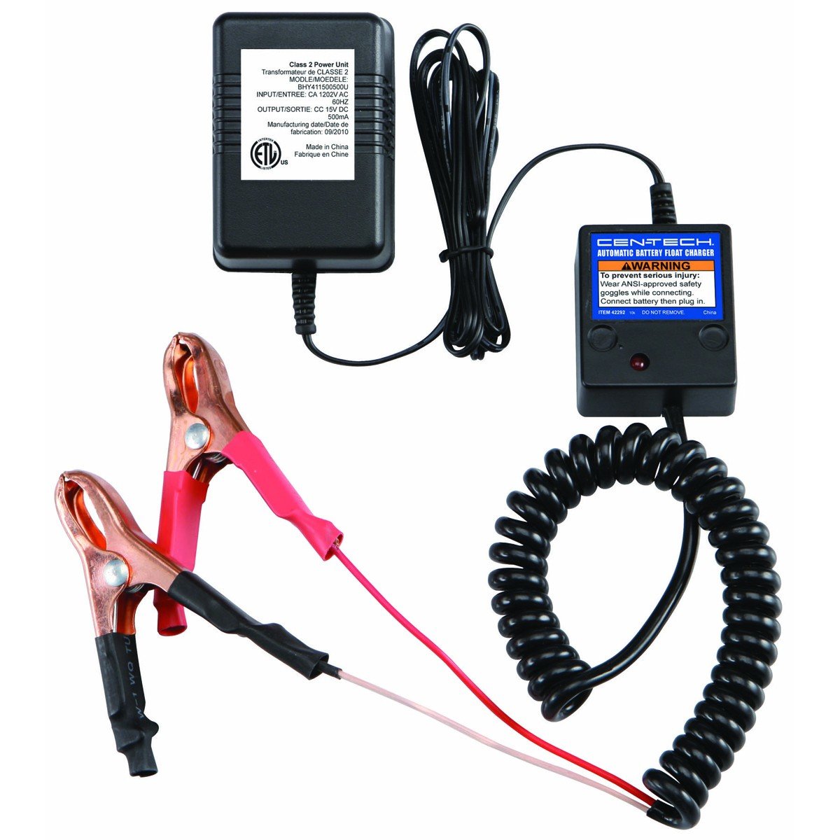

    I bought the Cen-Tech automatic battery float charger a few years ago and it performed as expected. A few months ago the wire broke that connected at the transformer (I think wrapping the wire around the transformer many times over the years caused stress to the wire), so I bought a new one. I noticed the few times I used the new one the battery would boil, causing acid to overflow which never happened with the other FC. I measured the output voltage which should be 13.2 VDC maximum output but was 14.2V. I returned the new FC and the replacement measured 13.08 which is less than the 13.2V stated in the owners manual, but I would rather have a slower charge than one that boils the battery and decay electrodes. Someday I would like to buy a better FC from a company with better quality control, in the meantime, this one will do.

    This is exactly the responses I read while researching it. Older ones are good but new ones are cooking batteries. I decided to skip on it and I’m going to pick up a NOCO. They have a .75a for $30 or 1.1a for $40.

    I think investing in a quality float charger would be worth it, especially considering the price of batteries and how much I use it. Thanks for the tip on which ones to buy. :thumbsup:

    I got a Noco G3500 for Christmas. I like the different modes it has, so it will do regular lead acid or AGMs at a slightly higher voltage. Plus a few other random types

    Why not just get the $10 harborfreight. Been using them for years no issues.

    I already had the battery tenders and battery minders for several years. Was just commenting on the above issue that people were having with HF ones to give better options as it seems the quality of the HF ones went down.
    I've got about 8 batteries I keep on float at my garage. Not worth saving $30 to trash a few hundred worth of batteries to me.

    Agreed, I also don't like the idea of any HF product being running whilst I'm asleep or out of the house.
