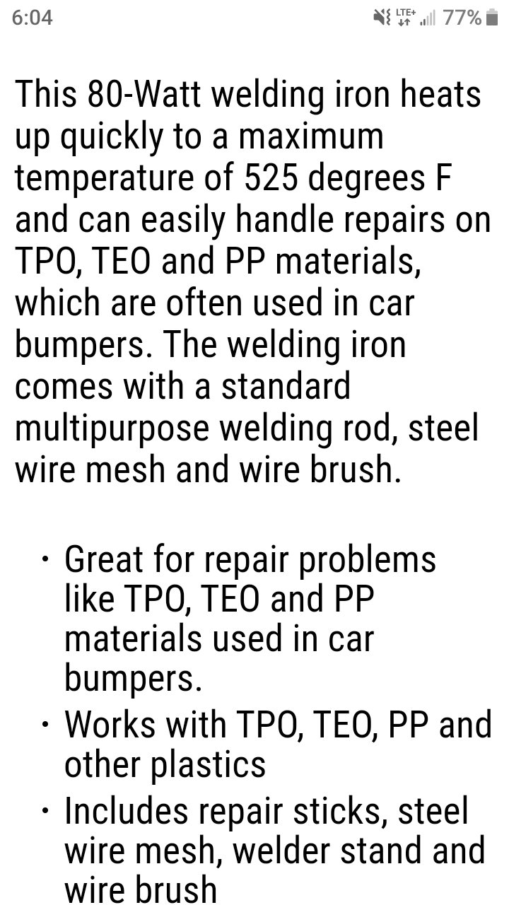

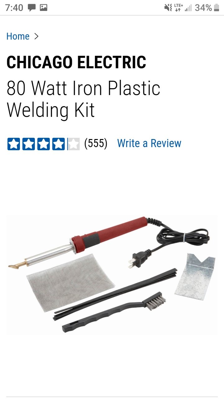

    What are some good applications for that plastic welder? At 80W it could surely melt some things, I guess it would outshine bondo, hot glue, jb weld, or epoxy putty when you need vibration tolerance, fast curing time, and waterproof— like a thermoplastic water reservoir or ATV body plastic. Anything else?

    Nailed it
    Atv plastic
    Especially camo, known for being brittle.
    Would also work on our stock front bumpers etc

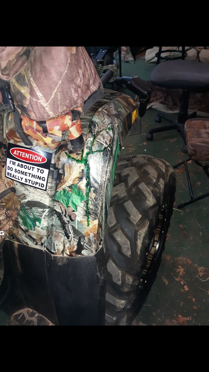

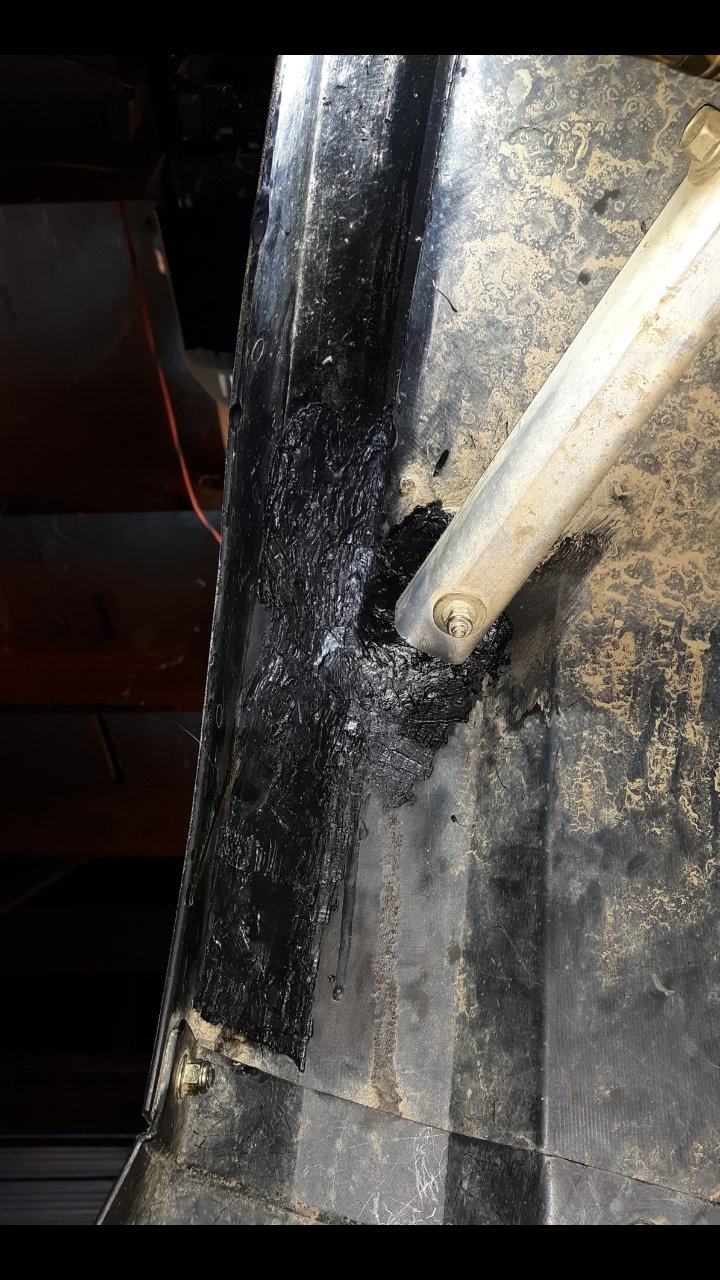

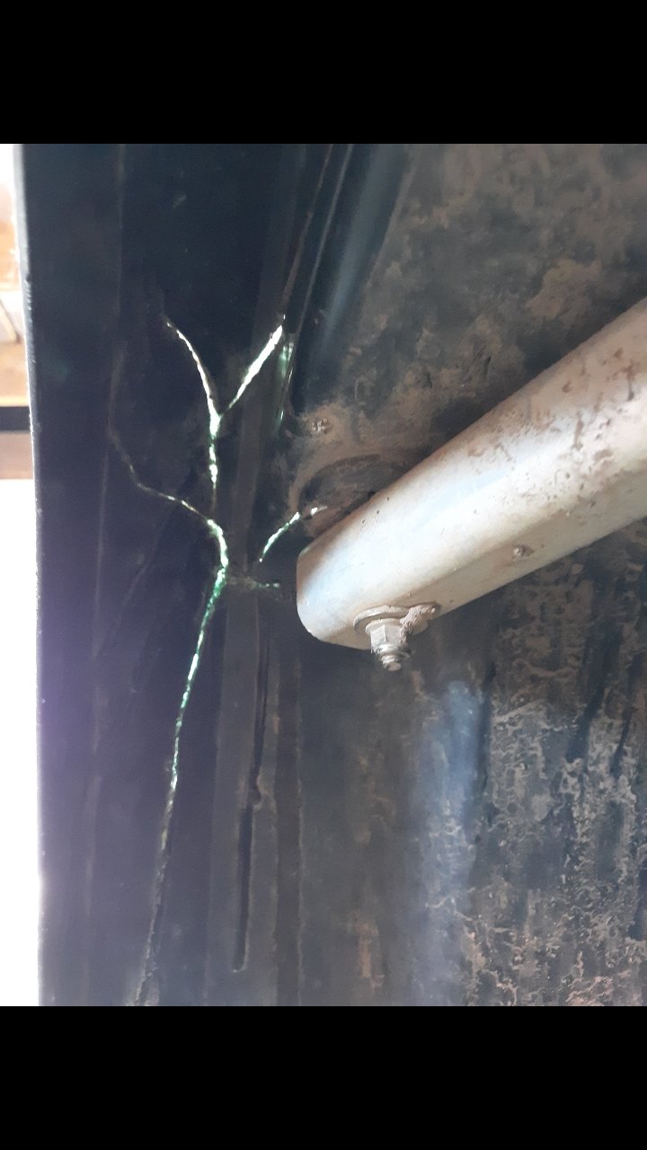

    https://youtu.be/PI5o8Cgr8T8
    Same principle except with wand instead of heat gun.
    Melted the steel mesh in. Covered and blended with the fill on the backside of the fender.

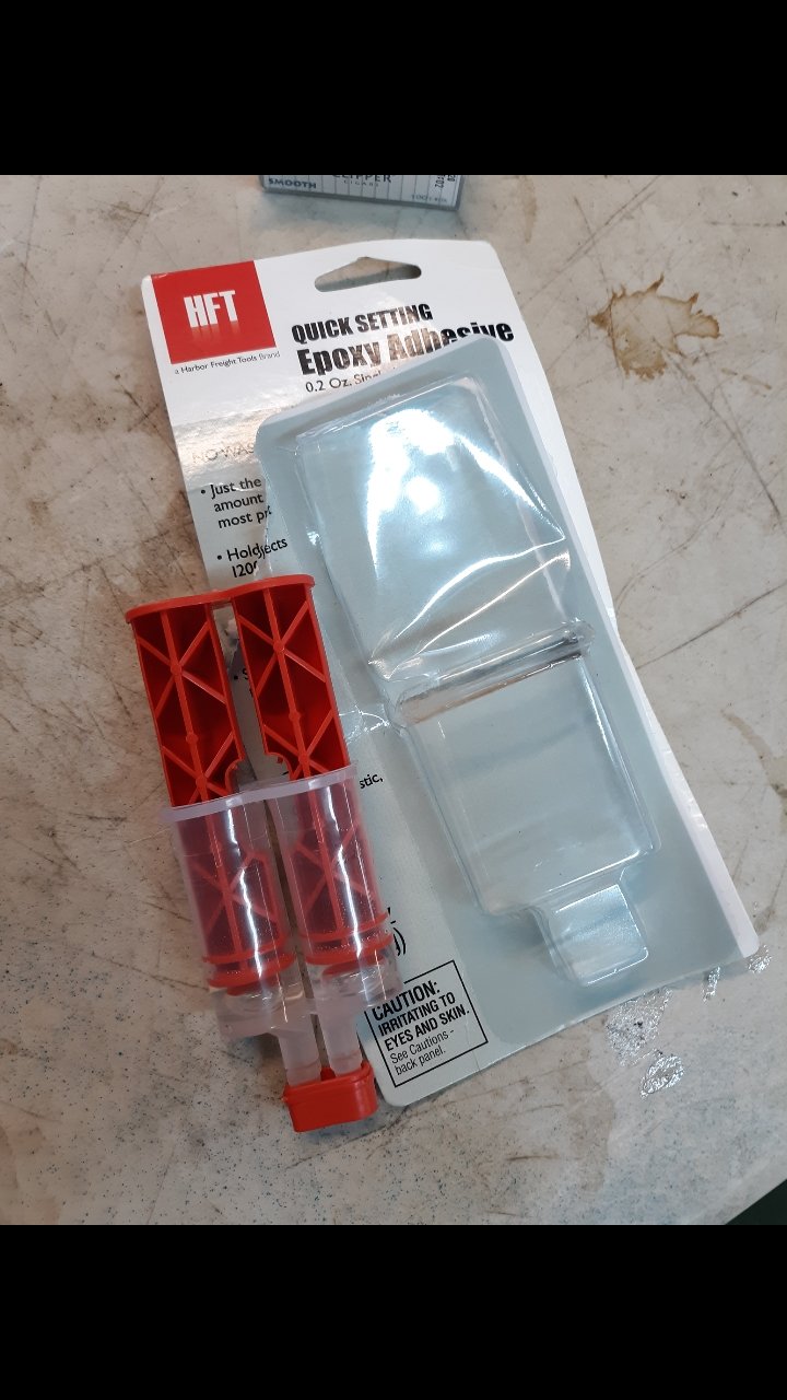

    Pulled the superglue (doh) and 2part epoxy that didnt work and just finished welding the outside.
    1st time welding plastic.
    Theres better options, but not for $16 bucks ;)
    Take your time, let the wand do its job, dont push too hard or itll bend and break off and fall down your neck in your hoodie.
    Oh, and watch your pantleg when you have the wand on the ground and your legs are under your quad.
    Other than that,
    Really happy with the result.
    Those cracks aren't going anywhere now.
    Thanks hf!

    I thought the epoxy my brother swears by and got me would work.
    Not a fair test on thermoplastic.
    The more I learned about repairing it and flexed mine after it dried the more I could tell it just wasnt going to hold up to the abuse Im going to give it.
