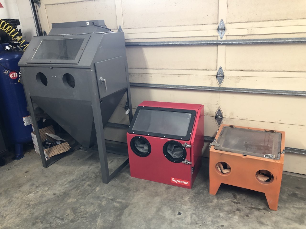

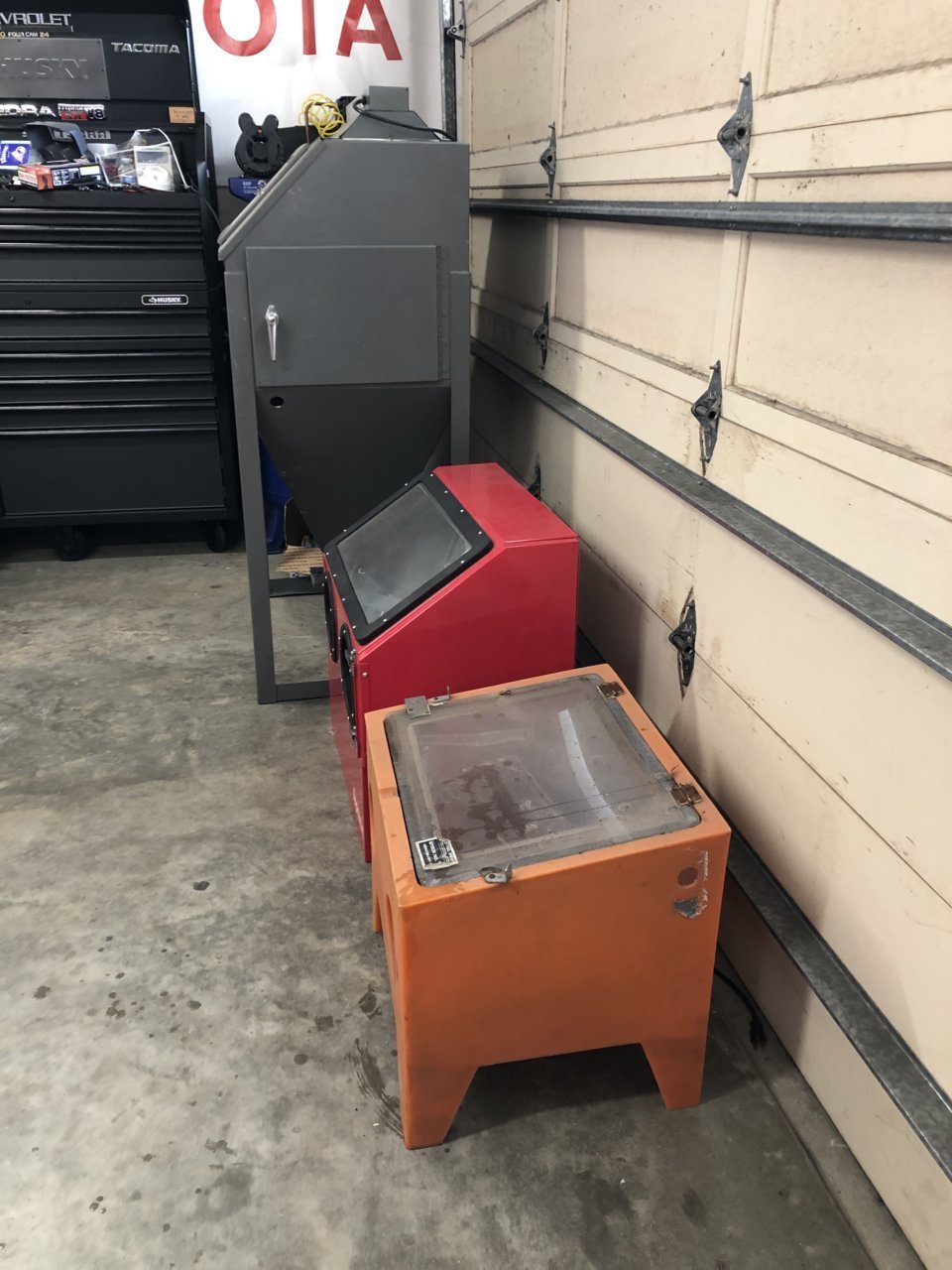

    Does anyone have either of the Sand blasting cabinets (bench top or floor) from Harbor Freight? If so, please give me your thoughts on it.

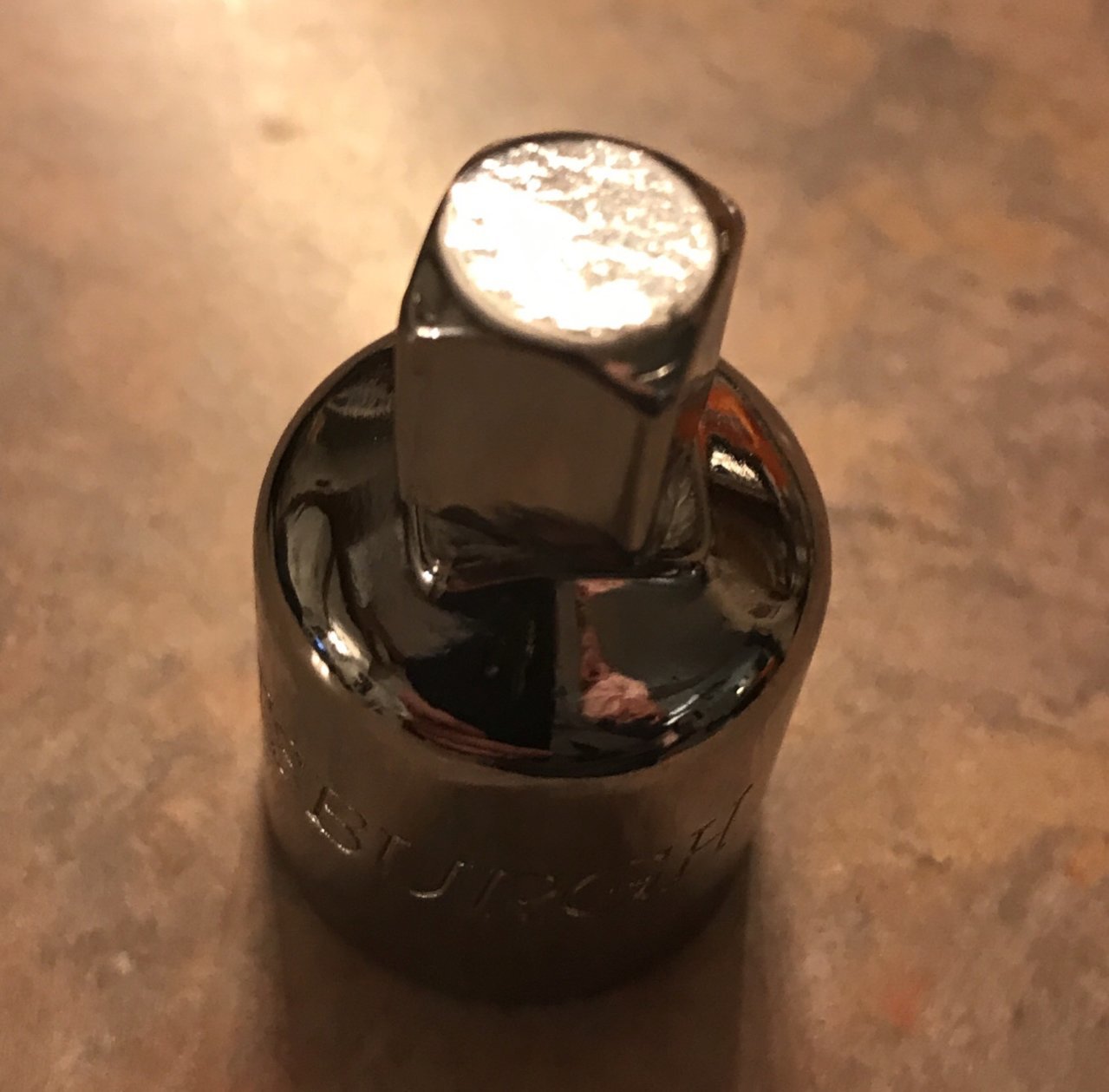

    First HF tool I’ve actually broken. It’s a 1/2” to 3/8” step down adapter. I was torquing my lugs down and my 1/2” 21mm impact socket didn’t fit between the cap and lug nut. I don’t have a 1/2” drive 21mm thin wall socket but I did have one in 3/8” drive.
    This yielded at about 65ish ft-lbs. It’s got a lifetime warranty, but what can I expect for $4.99 for 4 adapters before the 20% coupon, right? I’m pumped I caught it before it snapped off so I could get a cool photo.

    I have the benchtop blast cabinet, I'd suggest occasional use only.
    Main thing is to have enough compressor to run it. anything less than a 30 gallon and you'll be spitting water out of the blast gun and it will clog.
    You'll also need to supply your own shop vac, it goes instantly cloudy in the cabinet with no exhaust.

    Yup, but I got a big boy unit so I got rid of them.
    74A6CCF4-8D0A-4A2E-8418-81D417A87B2E.jpg 95DBE4A7-B638-46B5-A502-77F0BF61604A.jpg
    They’re good cabinets for general use. You’ll want to upgrade the lighting and get a dust collector.

    That should be plenty of compressor. Seals do leak a bit, but not bad. I have used professional units and most of them leak too. Especially when the abrasive starts to break down in size, it gets powdery and finds the smallest gaps.
    One more tip I always seem to forget... don't let the stream of sand ricochet off the part and blast the cabinet
    window, you won't be able to see out of it long that way :)

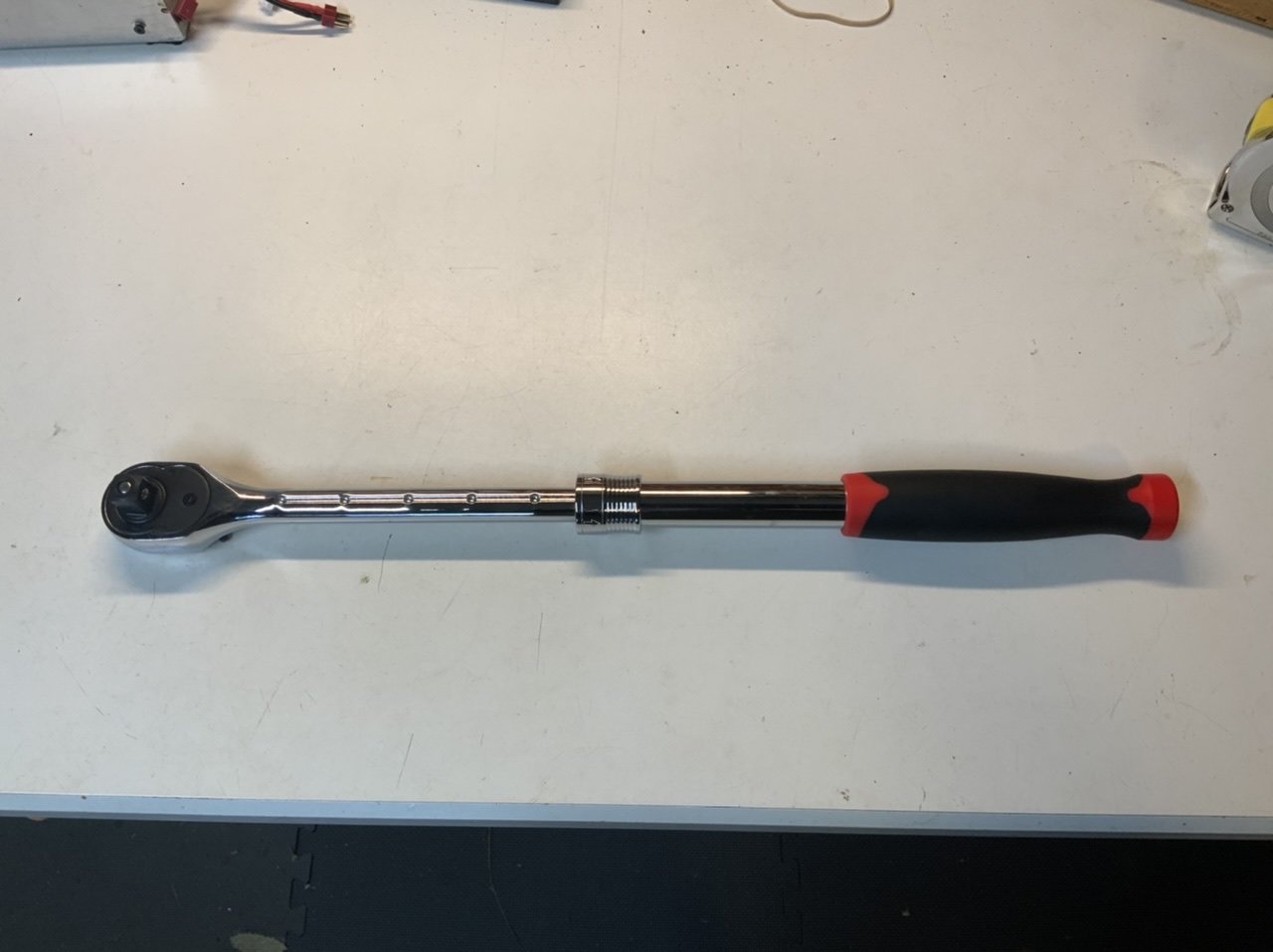

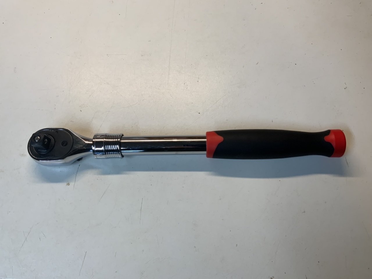

    Best f*ing $20 I have spent on tools. 13”to 18” extendable 1/2” racket.

    seems like it would be weak in the middle. any issues with bowing under torque?
