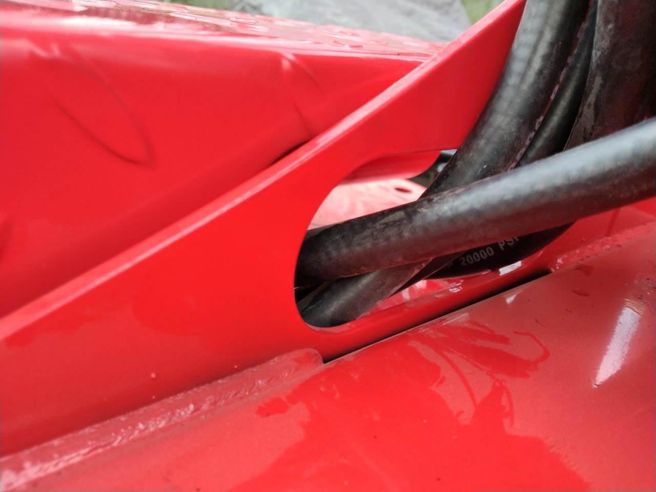

    For the hole that the hoses pass through why not make a ghetto grommet with some 1/4 or 3/8 fuel line split open length wise? I've done this a few times with firewall holes and it just takes a bead of silicone to hold it in place. Way easier than cutting & reinforcing your brand new toy.

    I thought about that, but decided I'd rather just make the hole bigger. After more thinking, I believe I can make the hole bigger without cutting the section out. Instead, I should be able to just move the hoses around when I get the cylinder loose and I will unbolt the controls to get extra slack. Then, just cut with a cutoff wheel.

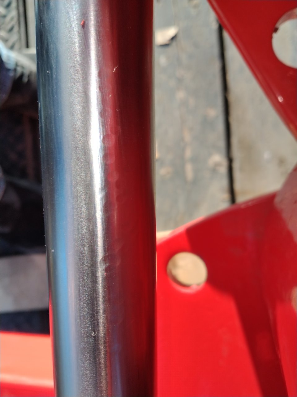

    Found an issue that I didn't see during assembly. While wiping the dust off the boom sway cylinder, I noticed something wasn't smooth on the shaft. I pulled it off the boom and turned the shaft 180*. That is when I found a bunch of dents in it.
    I already emailed HFT support and requested a new cylinder be sent as the dents are in a spot and there are enough of them that it will cause leakage when swayed left.

    That’s not good at all.
    That will leak for sure.
    Shouldn’t even pressurize the system…

    Those aren’t’ dents. That’s a feature: shot peened for extra surface hardness and strength. :)

    Someone peened the shit out of that, must have been reprimanded for something or is quietly quitting.

    None of the others have anything on them. I extended all of them out with no other issues found. I just can't sway left beyond center.
    Edit: replacement cylinder should be here in 3-7 business days.

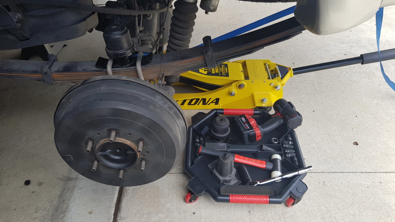

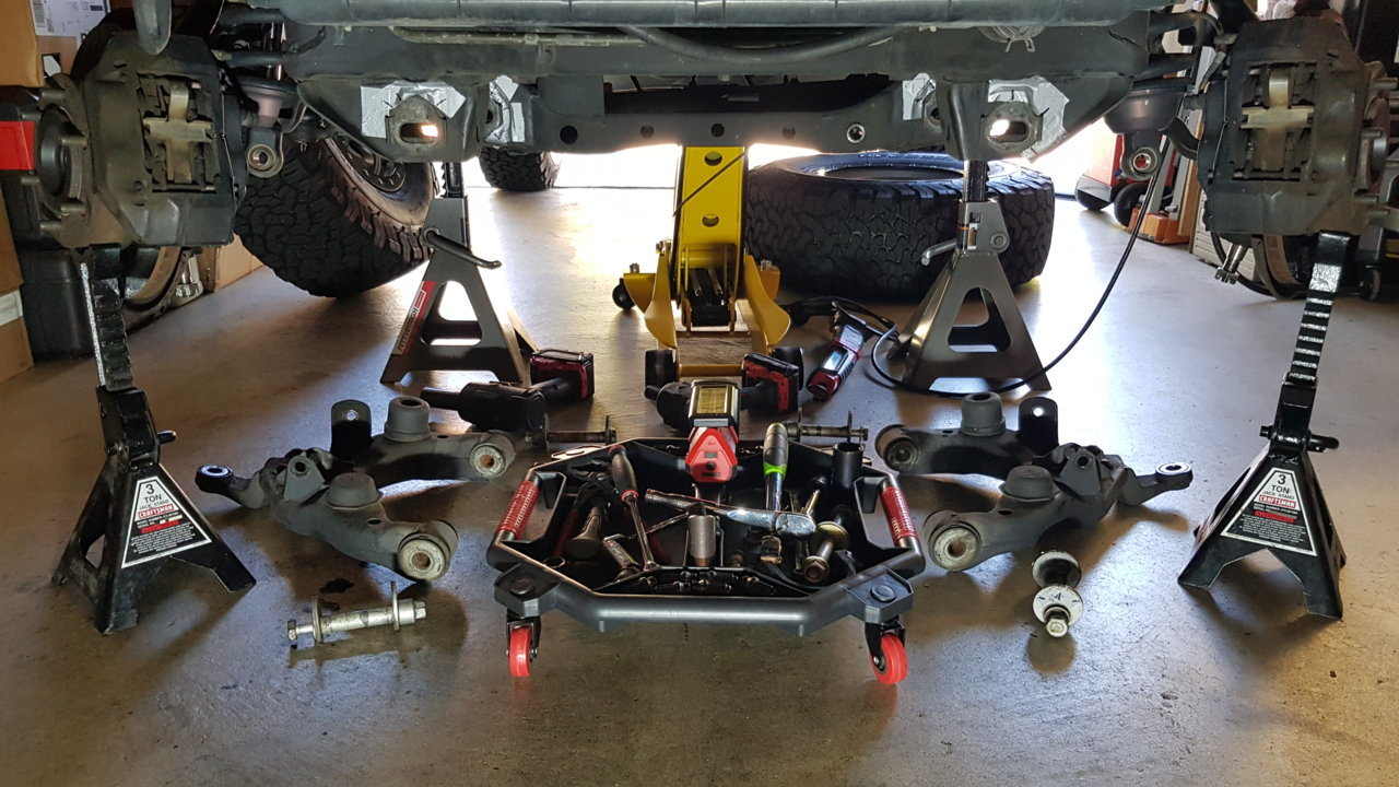

    The tool creeper is well worth it for me, especially for only $15. I had my eye on the Performance Tool one but it was double the price. Not only was the HF much cheaper, the casters seem better, also has the little steel plate to stick a flashlight.
    Was planning to wait till Labor Day sale to get it. But one Sunday night I decided to just pick it up the next day at regular price cause I had some work to do on the truck. Monday I woke up & had a 30% off $20 & under coupon in my email. Nice, perfect timing, got it for $10.50, couldn't be happier at that price!
    The one on the left, the one on the right I like a lot too, for smaller jobs, but it's not from HF.
    I love these things, never knew they existed, & never noticed it at HF. Wish I had one years ago.
