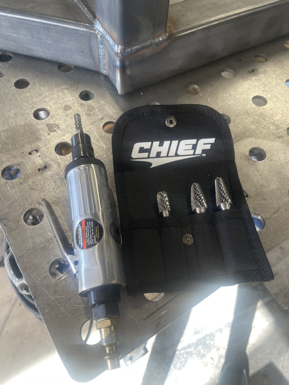

    7 times the price! Do they last 7 times longer?

    $8 for cutting wood
    $55 for cutting steel, yes probably would last 7x longer in wood

    I’m a machinist that uses the carbide burrs frequently , they work excellent on metal and have a very long tool life, not the greatest for wood. The steel rasp kit is way better for wood.

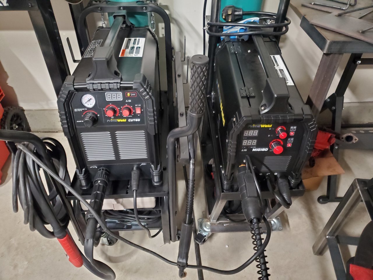

    PrimeWeld
    60 amp plasma cutter
    220/110v
    3 year no questions asked warranty
    $3-400 cheaper
    I use it very often cutting all sorts of metals in varying thickness
    Several people have received help *after* warranty period and even for non PW products

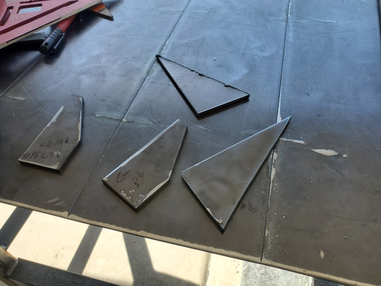

    It slices so well, no slag at all if you move at the right speed. Look at the right edge on the far right gusset

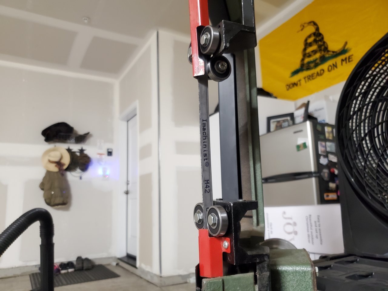

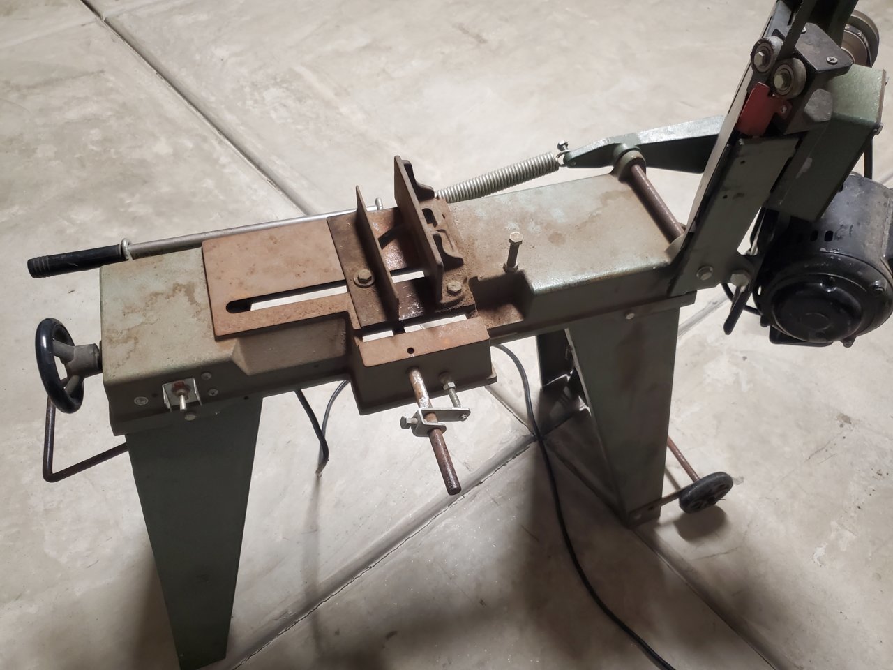

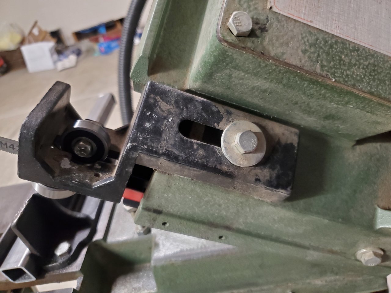

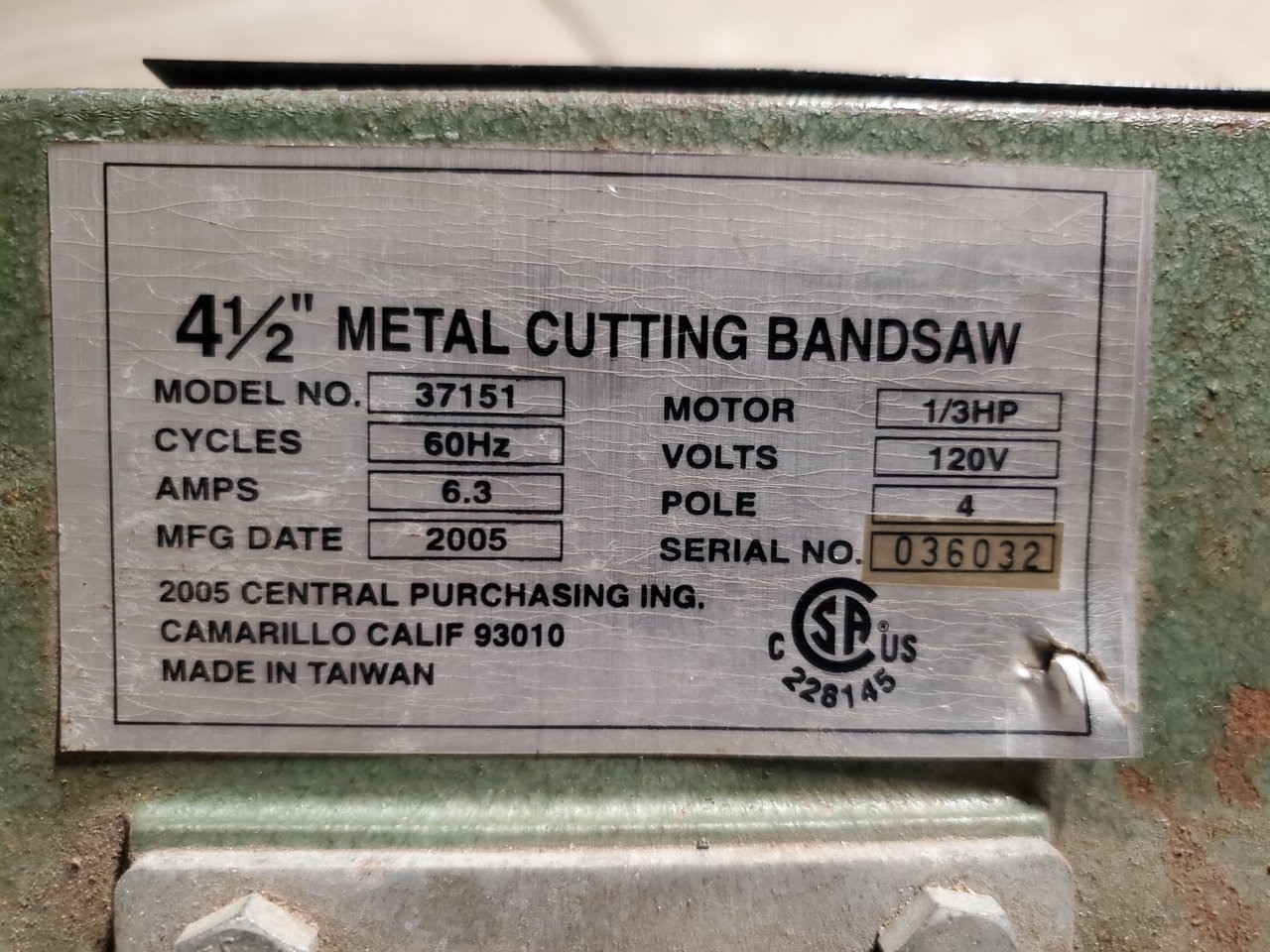

    Hmm, let's sum it up.

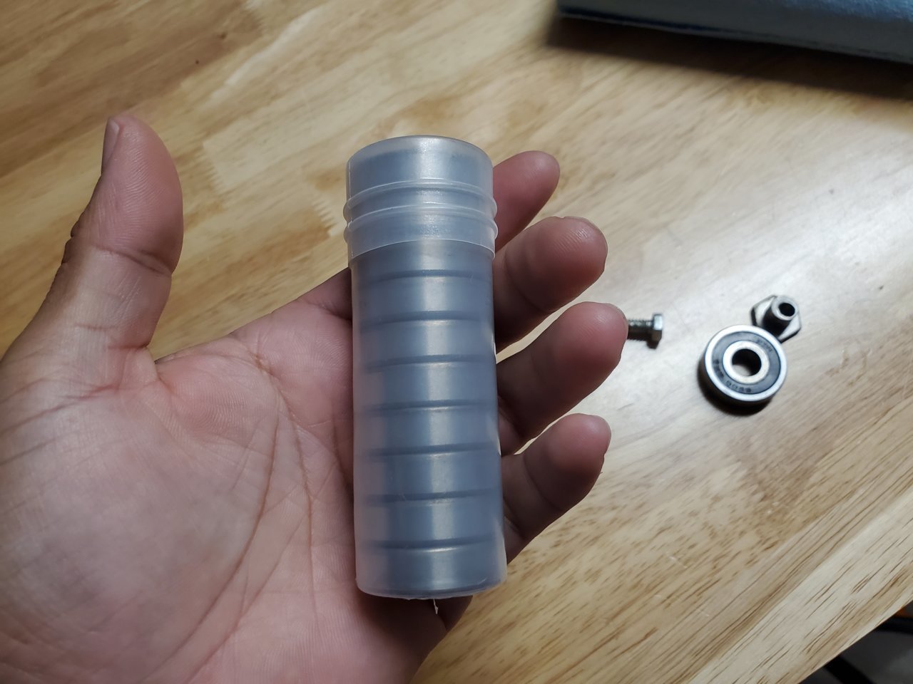

    About 3 weeks ago I got this HF bandsaw free. Being that it's about 17 years old, and of the Harbor Freight variety, I want any and all investment as minimal as possible.
    Here's when I got it -
    I spent maybe half an hour cleaning it up with a wire wheel on an angle grinder and a rag in other places.
    After my first test run, a few things were revealed. The blade was moving much slower than I needed it to so I moved the belt over the pulley for the fastest speed.
    I was able to cut 1/8" stock I had laying around, but I felt like it was having trouble.

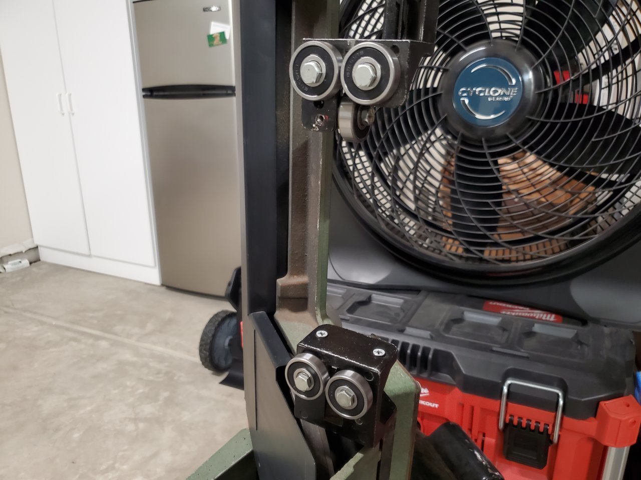

    Pulled the bearings off and found several seized so I bought new ones -
    The blade was really old and had lots of teeth missing so really I'm surprised it cut at all -

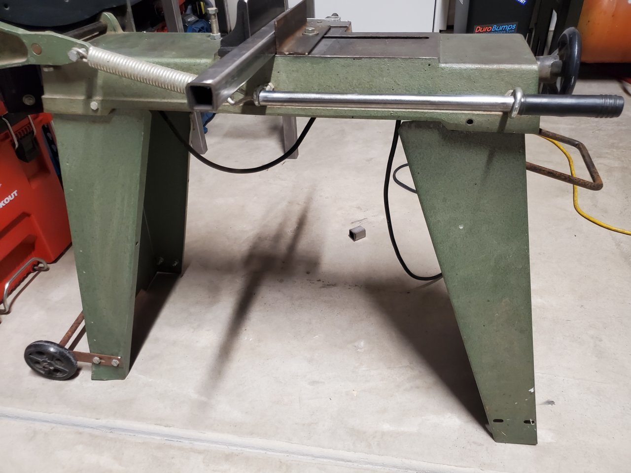

    A few other things to address are the 'legs' which are basically folded up bits of sheet metal. Bolts are missing so this thing is ready to collapse in on itself. I'm contemplating using some of my 1/4" thick steel I have to make a table for it and get rid of the folding legs -

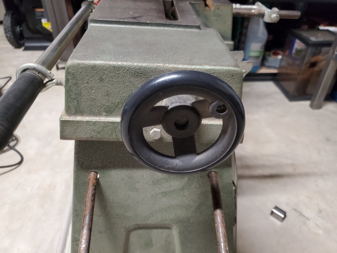

    The wheel for the vise is missing the handle at the end, but I'll figure something out for that later -

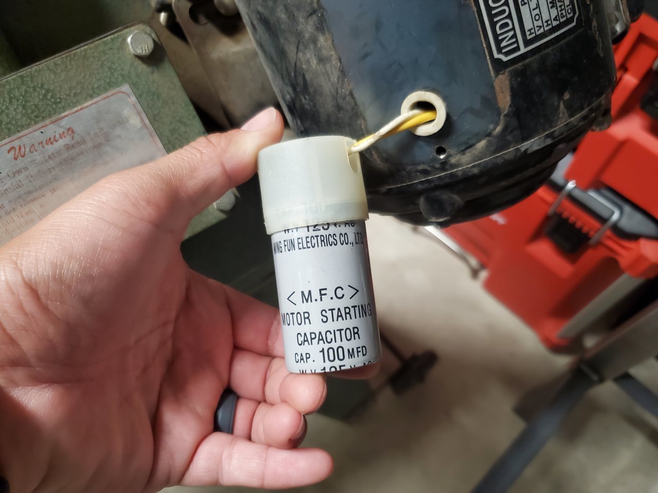

    The starting capacitor that needs replacing -

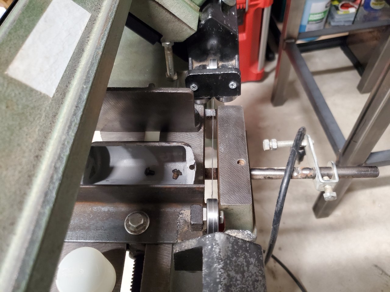

    However, the worst part about this whole setup is the lack of adjustment for the blade. You'll see the square tube clamped above, as well as the piece on the floor. After testing the new blade (which cut way better), I noticed the blade cutting at an angle so I needed to modify the guide on it -

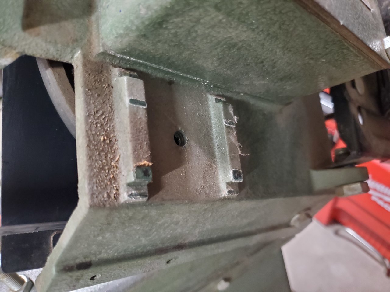

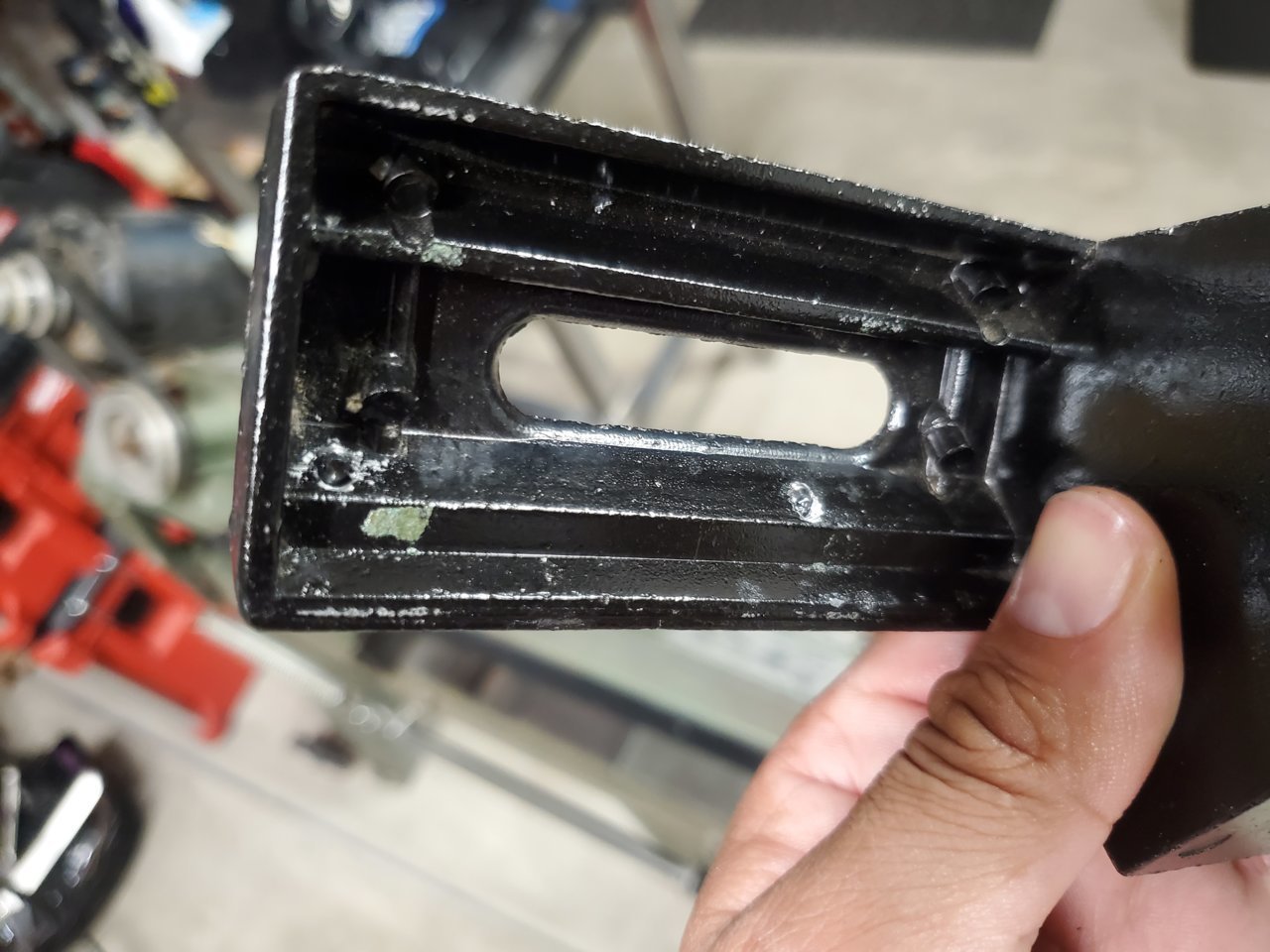

    Behind the guide are these 'raised edges' so I'll use that to my advantage. Just need to mark where they are on the guide plate itself -

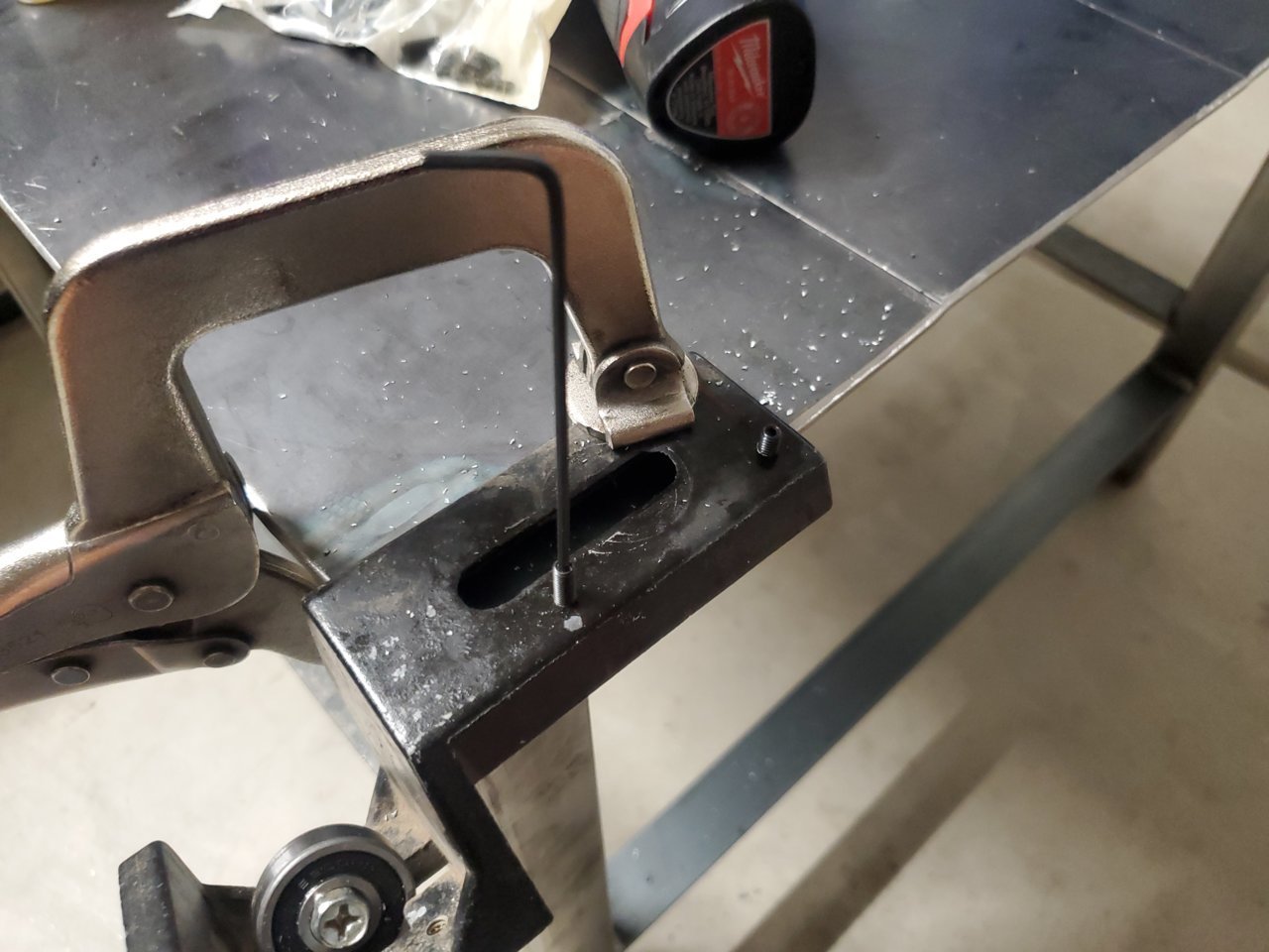

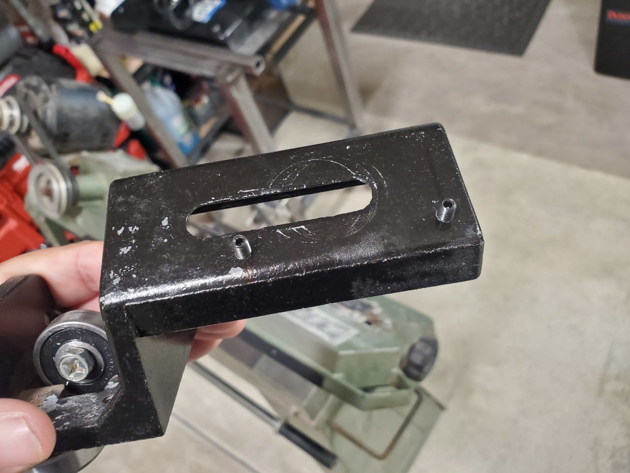

    With the plate marked, I hit it with a punch in preparation for drilling -

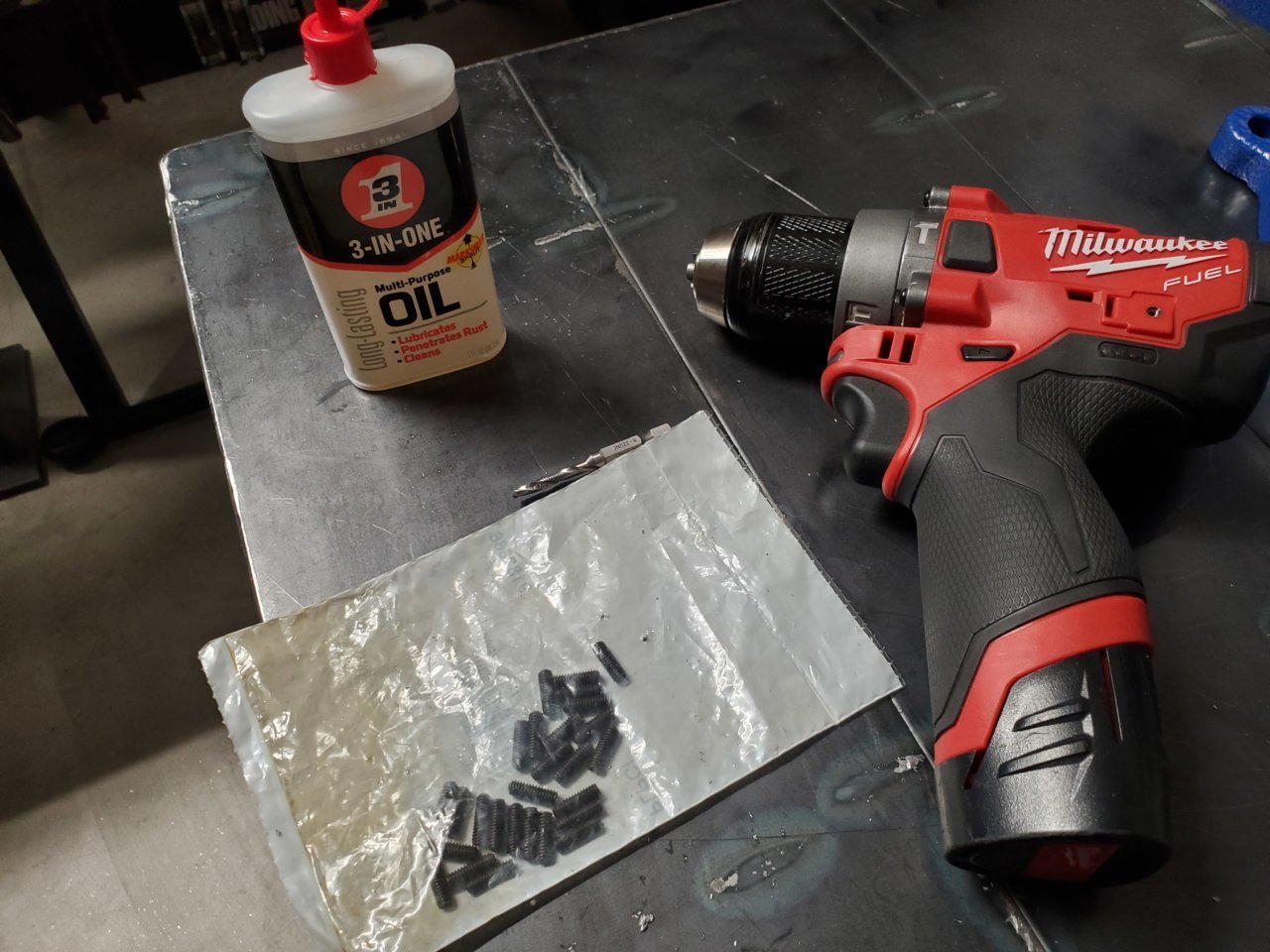

    Bought these set screws just for this little project -
    Once drilled, I tapped them for the set screws. Here they are going in place -
    They had stainless steel and black oxide; went black for a more low profile look -
    Nice thing is, the area behind the plate has plenty of material for the set screws to sit in place -
    After some messing around, it's as square as I can get it -
    All in so far I'm just shy of $47 for a new blade, bearings, set screws, and starting capacitor.
    I'm $3 away from being all in for the budget I set out for this thing. I figured if I'm going to spend any more than that, I could get rid of it for what I'm in it and just buy a new one.
    So in asking if anyone had a dead HF bandsaw, I was hoping to maybe get a part or two to use on my own bandsaw.
