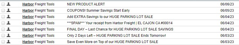

    Few and far between? They send them out at least every day, if not more:

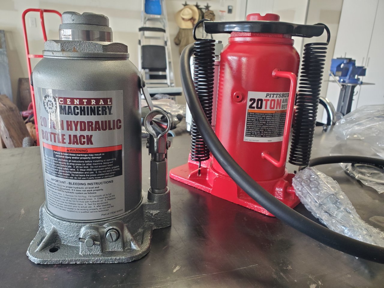

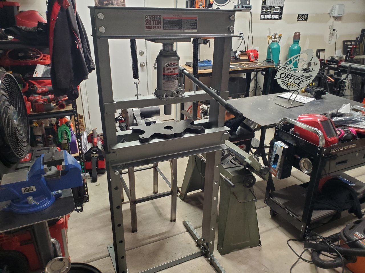

    It's worth getting if the item you want is on sale for track members only, and the discount is greater than the membership cost itself.
    Bought an air over hydraulic jack (recent release) for my 20 ton press and saved quite a bit.
    In fact I never posted it here in the HF Tools section.
    New press -
    New jack the next day -

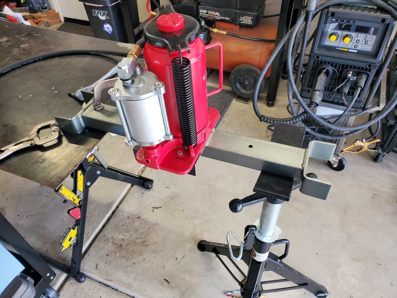

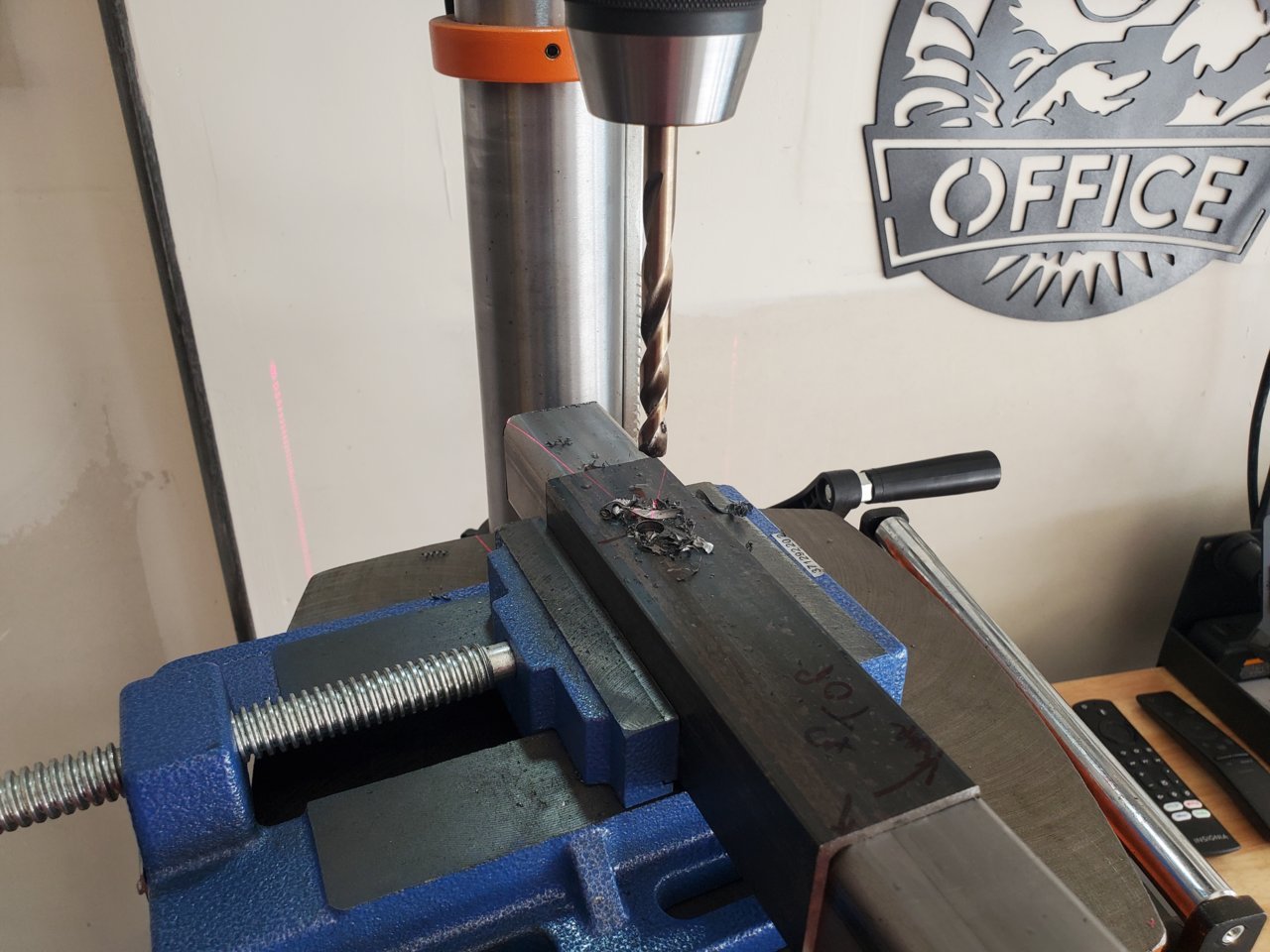

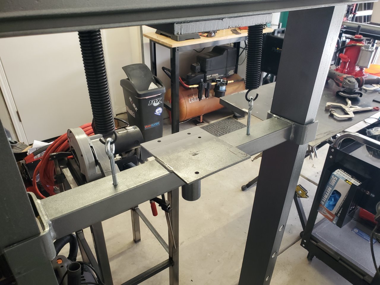

    Modification for said jack, some cutting, drilling, and welding -

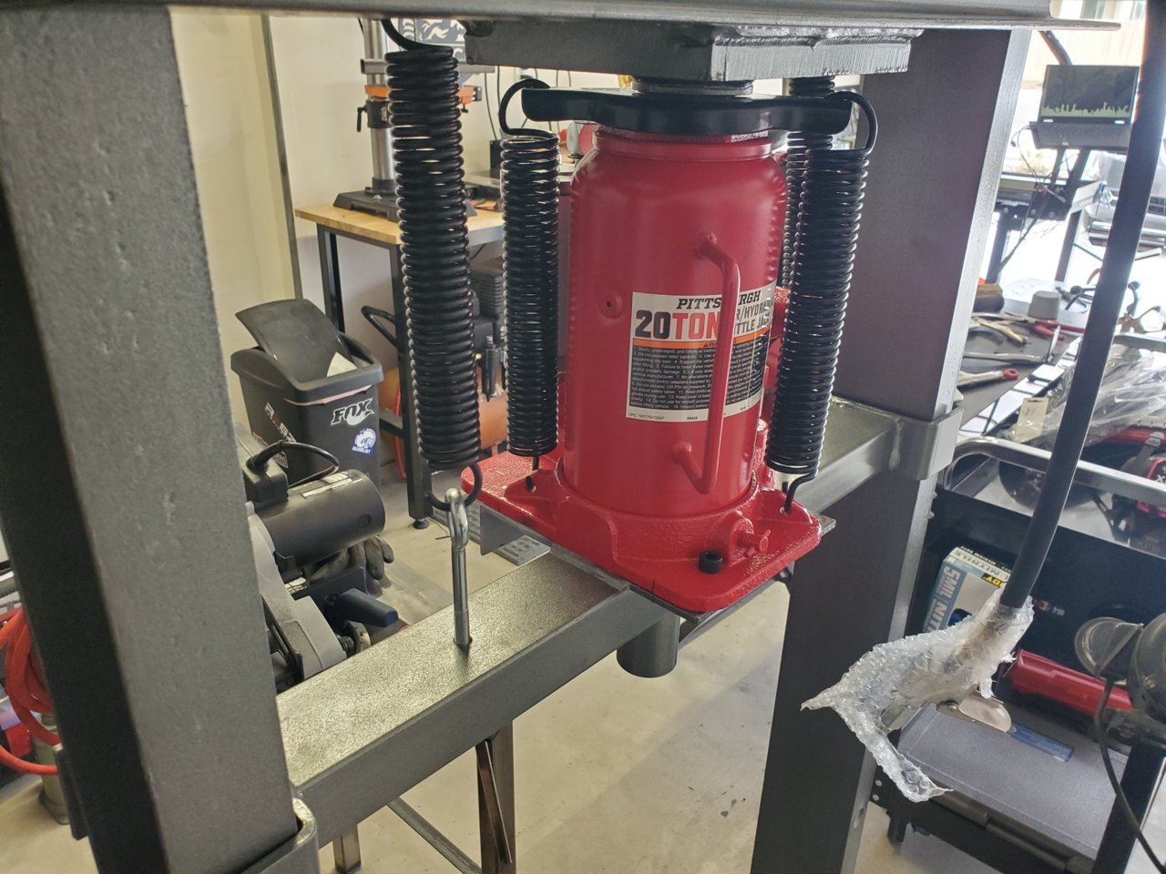

    Installed, but not done at this point -

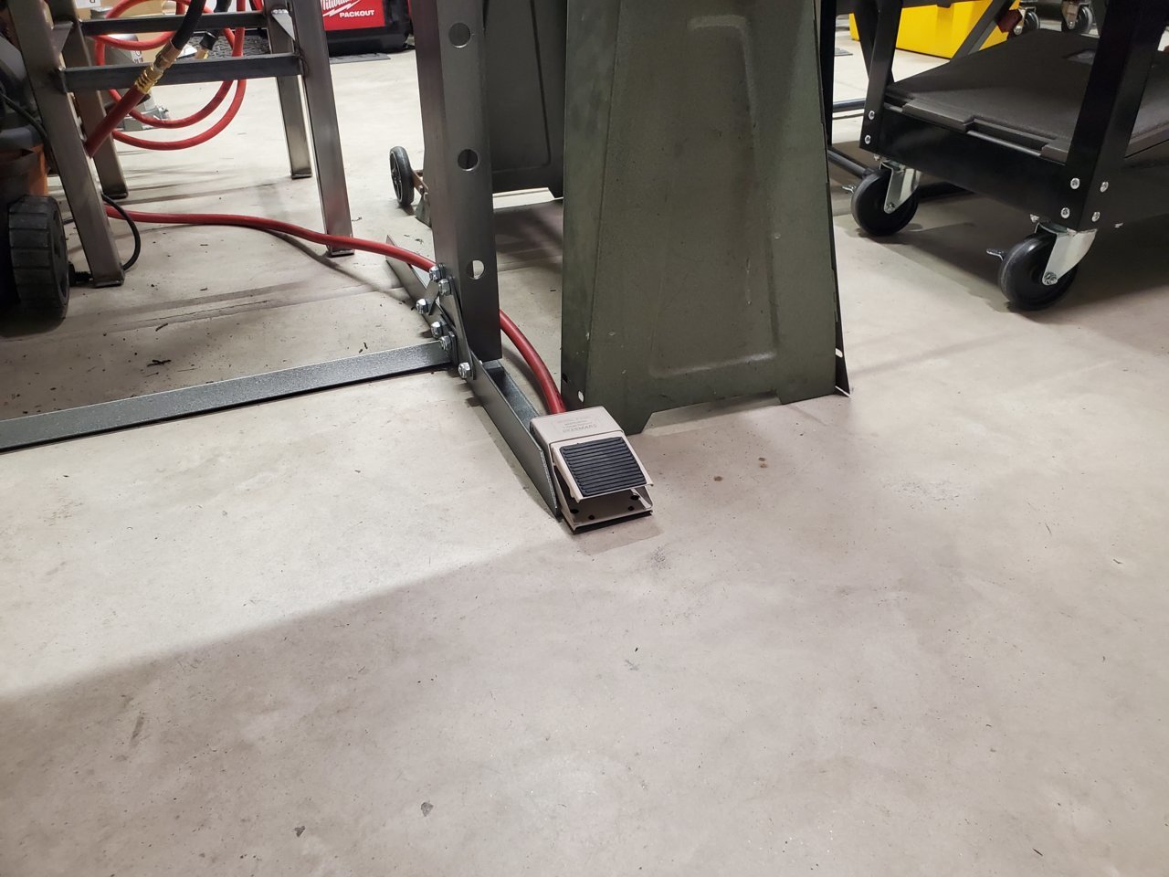

    I did away with the stupid hand lever and opted to replace it with an air hose and foot pedal at ground level. This would allow a hands-free operation and a safer means of handling a heavier piece of steel before starting a bend -

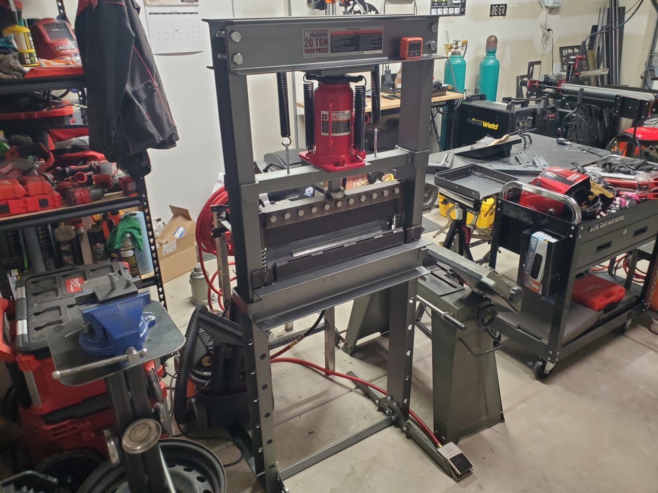

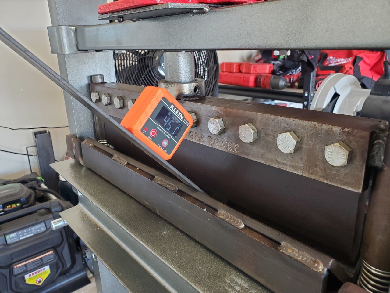

    Angle finder coming in clutch, hangs out on the press when not in use -
    Harbor Freight press with Swag Offroad Finger brake kit -

    I put casters on mine and I can roll it out of the way when I don’t need it.
    BTW, if you aren’t going to use the original manual bottle jack, I wouldn’t mind taking it off your hands.

    It's brand new and you're welcome to it.
    Yeah I've got maybe 2 extra sets of casters, even these "fancier" ones where you step on the lever and they lift up a heavy object they're attached too.
    It's been sheer laziness for me though :bananadead:
    You build a small frame at the bottom? I was thinking of using some square tube I have a bunch of.

    I've been thinking about this too, but haven't done it yet.. BUT I am moving the press from the old house to the new one this weekend, so it's on my mind. I've seen pictures of people putting them on casters with and without a subframe. I just guess my preference would be to make the subframe and weld the casters to that, and then bolt the press to the subframe so that if there was something I wanted to change about the casters and frame, it would be easy to do.

    If you're going to put casters directly on the assembly itself, opt to add a pair in the center.
    Too much weight to go unsupported, paired with wheels at the corners = bad idea as I imagine that angle iron will bend over time.
    Frame would be super simple. I'll take pics if I ever do it. I've got some plaque holders and bed stiffeners to finish up today :bananadead:
