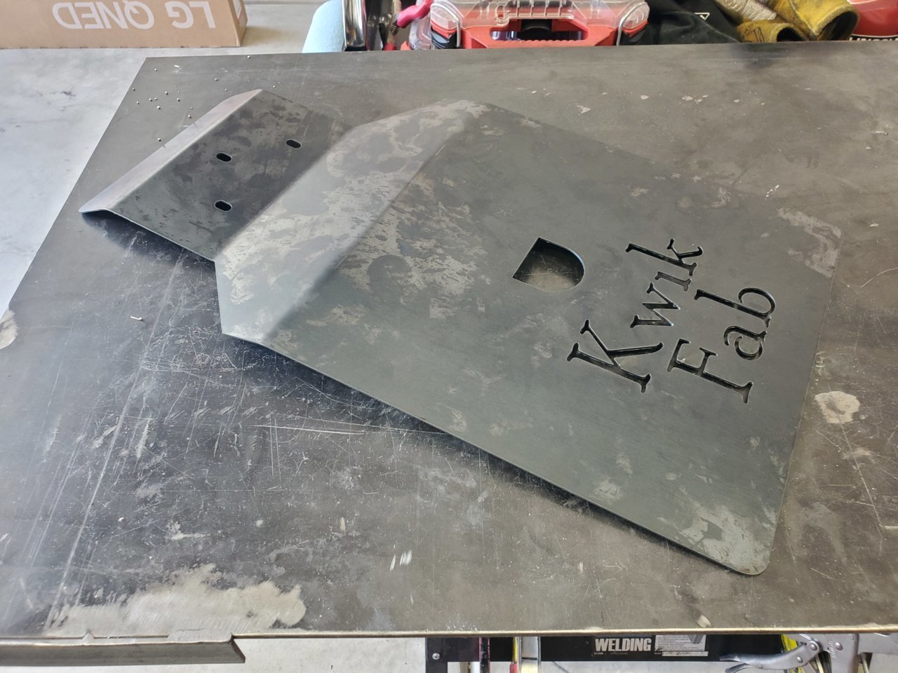

    OOF...
    Less than $40 here for a 4' x 4' of 16 gauge, 15mins away
    And it's funny you're doing a skid cause so am I; going to cut a prototype out of 16 gauge now before cutting the real thing in 1/4"
    And yeah I'm surprised how much those dimple dies are; look cool for sure though!

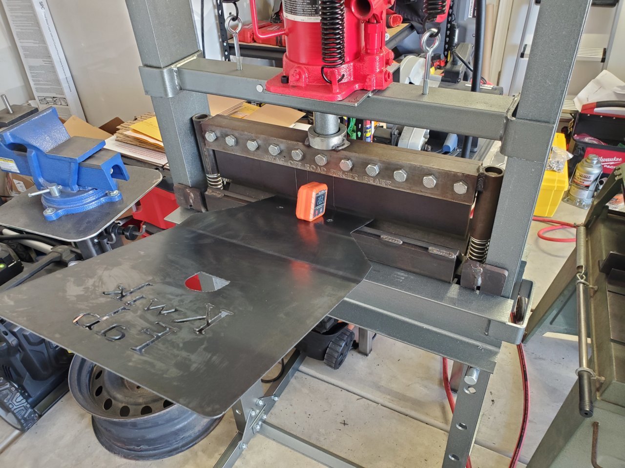

    I’ve been lazy and have had only casters on the corners for the past year or so, I’ll have to check if it has sagged. I keep the air over hydraulic jack as well as the swag press plates and press brake on there so it’s got some weight on there all the time haha
    Kwikvette[QUOTED] likes this.

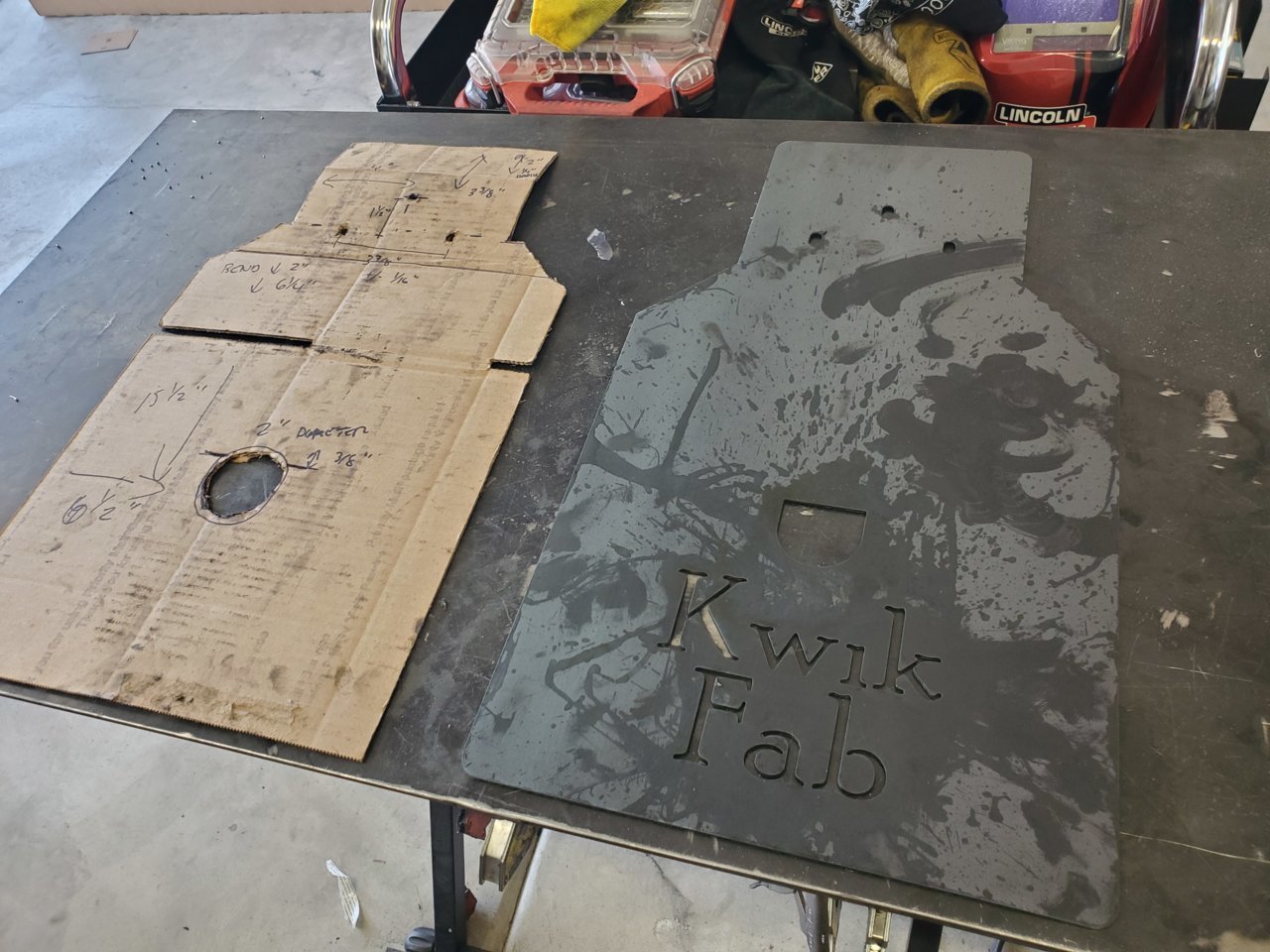

    Yeah my brake has been on my press too, but I only intended to use the two as such and never use the press alone.
    Using it just now reminded me how awesome it is -
    @spencermarkd I love 5 minute jobs :laughing:
    Too hot outside to mount it up; I cut it so I can mock up a rear mount to my frame so I can add additional holes or slots as needed.

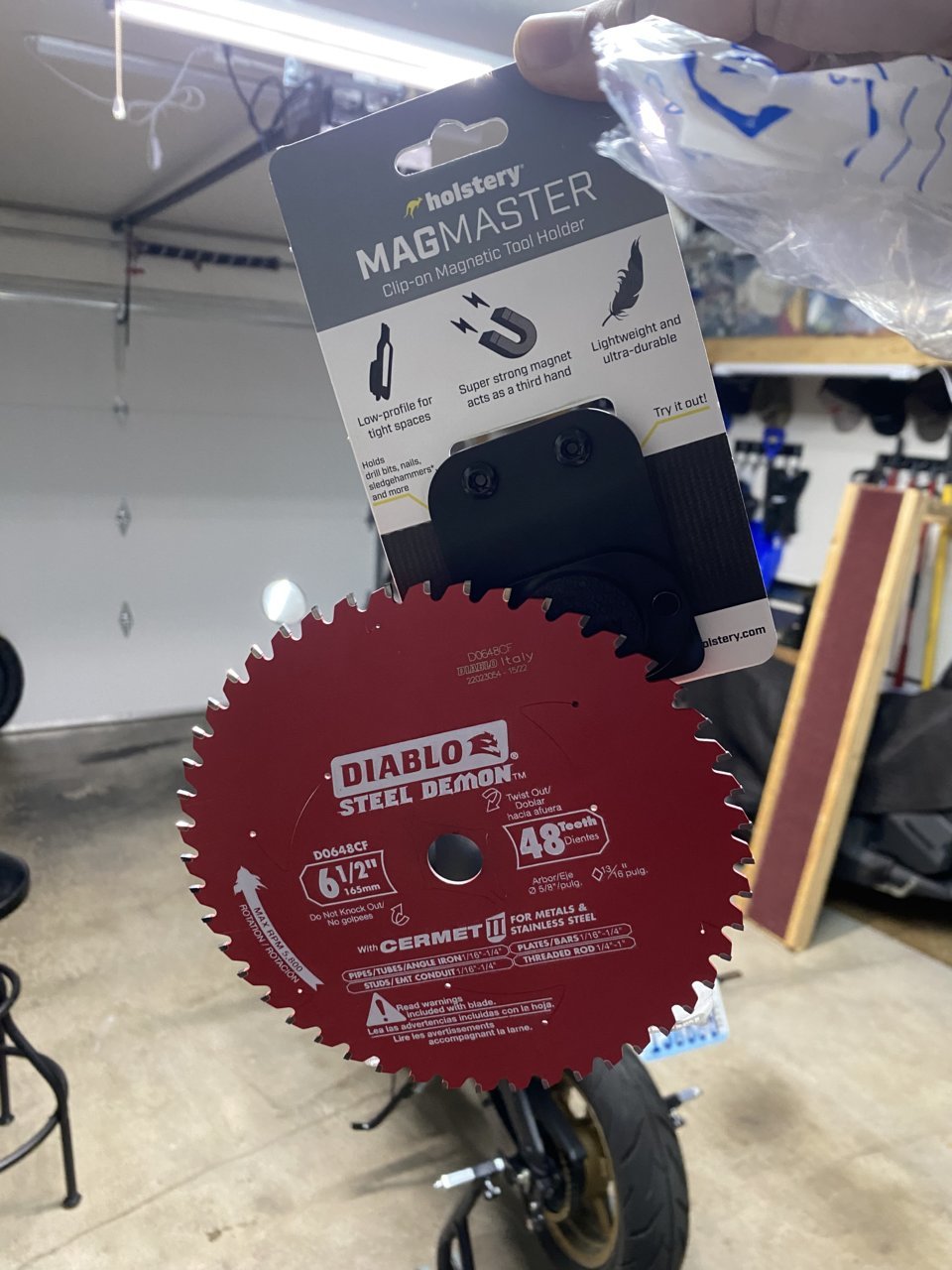

    Found it in 6 1/2” :thumbsup:
    Also found a belt clip with a crazy strong magnet on it that I saw an instagram ad for and was really intrigued by

    Diablo saw blades are legit, use them myself
