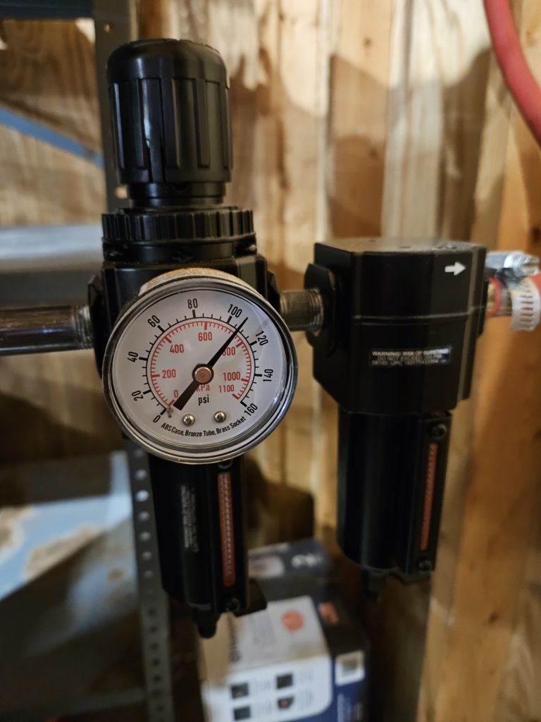

    Anyone use the Merlin 3/8" regulator on their air compressor? SKU: 58178
    After my compressor shut off last night I heard hissing. The regulator was reading almost full tank pressure. I bled it down to the set point ~105 psi. But a minute later it was back up to full tank pressure and hissing again.

    Any regulator will get contaminates in them. You are gonna have to take it apart and clean it.

    Is that the issue? I don't have any experience with that.
    I can make time to tear it apart, just seems a little premature. Got a grand total of 3.8 hrs on this setup. Regulator, compressor, etc all put together when I moved into my new space this spring
    308savage and koditten[QUOTED] like this.

    Regardless, you still got to take it apart. You are going to find either broke parts or manufacturing debris in the diaphragm.
    Looking forward to what you find.

    Probably not of any help, but i always set mine while it's under the load I am using it for. What it reads while sitting there is of no consequence, and generally always innacurate.
