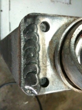

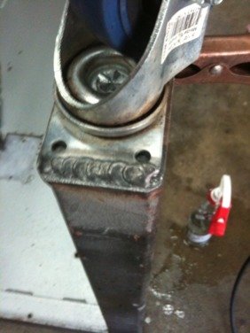

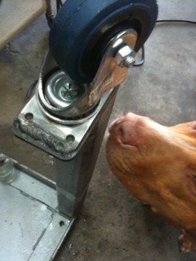

    I have the 220v welder. Mug or flux. I'm still using the stock flux wire with no gas for basic stuff. Here's a welding table that I put some wheels on.
