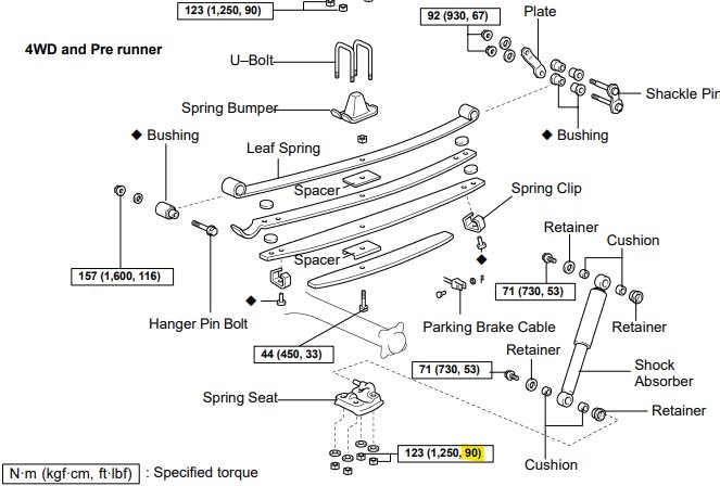

    The u bolts should not be coming loose at all.. They are over 90ftlbs...
    Wait.. didn't you say you got new leaf springs? Did you install them, or a shop? U Bolts can't be reused. If you or a shop replaced them, they need to be replaced ASAP.

    The threads stretch out at the correct torque value (90 ft lbs), and can't be reused.
    It's likely not causing your hard ride, but it could eventually lead to a u bolt failure, which wouldn't be the most fun thing to have happen.

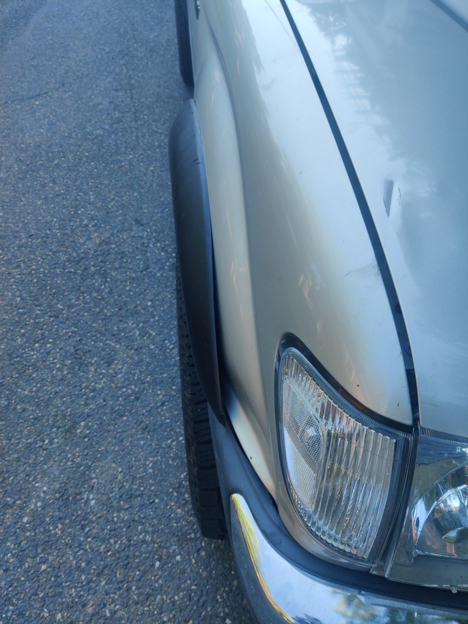

    With the body mount bushings I was reading that a sign can be misaligned fenders... Is this what they're talking about?
