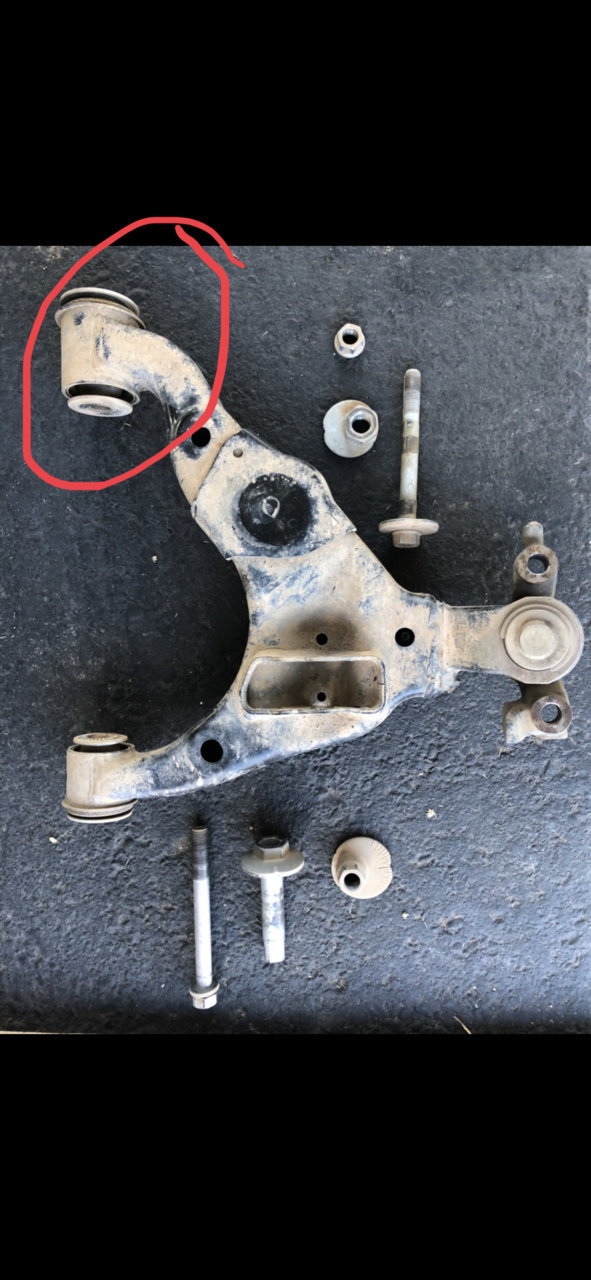

    While I had the LCA loose in the frame mounts I spun the cam adjusters and saw that the rear (loose bushing end plates) had a lot of dead spots. Turning the cam wasn't moving the LCA in or out.

    Really thinking I should hit up another shop tomorrow. Removed and reinstalled the LCA today and only found the loose bushing end plates. Lubed up the bolts and reinstalled/torqued all hardware. The loose bushing end plates don't really concern me though cuz when you torque the hardware it should squeeze everything tight again.

    end of the day the problem was a stripped cam bolt, rear LCA, driver's side. typically the bushing but it looked ok. if you're in that deep definitely inspect the bolt and back plate. apparently some moron in a previous alignment over torqued it and the threads failed later while driving. long story and Ultra frustrating in my case so maybe dig in and save time. sorry if this was already mentioned but I'm at the airport..

    Already done did checked it. Thanks tho!

    Driver's LCA replaced due to loose bushing washers. Long shot and it didn't work. Driver's side won't align.
    Driver's steering knuckle replaced assuming it was slightly bent. Didn't work. Driver's side won't align.
    Removed LCA again today to reinspect frame mounts and they still look fine. Cams rotate 360 degrees within the tabs which moves the LCA no problemo.
