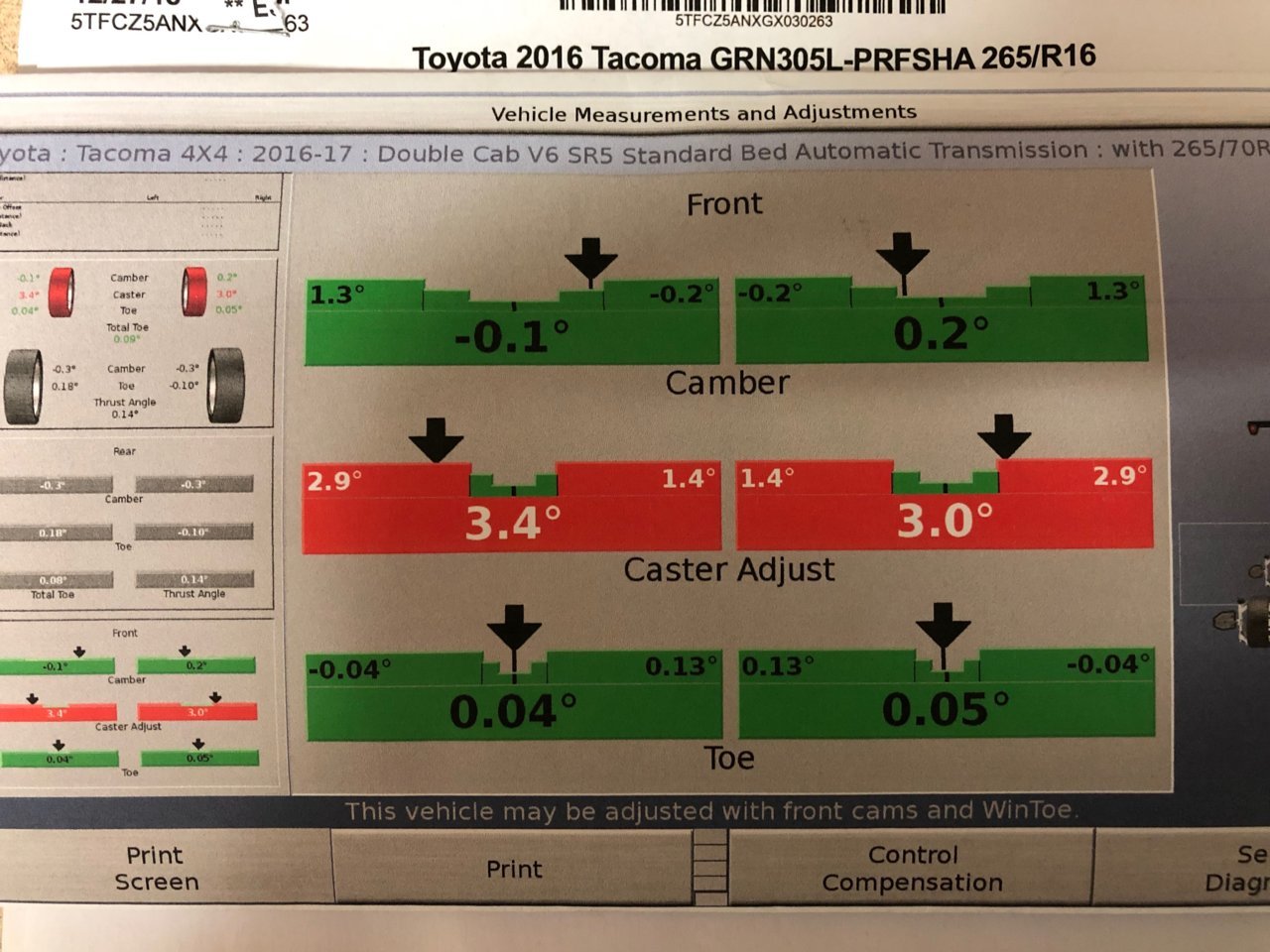

  4. Jan 15, 2019 at 5:54 PM
    #44
    chucklefunkk
    chucklefunkk [OP] Well-Known Member
    Jan 1, 2017
    #206229
    462
    So. AZ
    2016 TRD OR
    $80 SPC Cam bolts and she's back in alignment. Still feeling that this is a bandaid but I do appreciate this shop spending 6+ hours on my truck and only charging me $200 total for the cam kit, alignment and $40 labor.
    maxtherat and dtaco06 like this.

  6. Jan 21, 2019 at 9:53 AM
    #46
    veggtaco
    veggtaco Well-Known Member
    Mar 15, 2018
    #247394
    62
    2018 TRDSPDC
    Just read all of this thread.. glad you finally got it fixed. Question though.. Isn't the cross caster backwards?
  7. Jan 21, 2019 at 10:39 AM
    #47
    chucklefunkk
    Jan 1, 2017
    #206229
    462
    So. AZ
    2016 TRD OR
    What do you mean?
    That was the initial “fixed” alignment after a shop installed SPC Cam Bolts to get it back within spec. They managed to completely flatten my drivers front cam tabs in the process. I hate dealing with shops.
  8. Jan 21, 2019 at 11:38 AM
    #48
    veggtaco
    Mar 15, 2018
    #247394
    62
    2018 TRDSPDC
    Isn't the caster usually higher on the passenger side to offset right drift?
  9. Jan 21, 2019 at 11:54 AM
    #49
    chucklefunkk
    Jan 1, 2017
    #206229
    462
    So. AZ
    2016 TRD OR
    Usually. Can’t get that on mine. Dropping drivers caster increases neg. camber. Can’t get any more caster out of the pass. side.
  10. Jan 21, 2019 at 12:51 PM
    #50
    veggtaco
    Mar 15, 2018
    #247394
    62
    2018 TRDSPDC
    Gotcha. I think it might have been mentioned earlier in this thread, but if you end up needing more caster down the road, SPC UCAs will help. Hope it works out.
