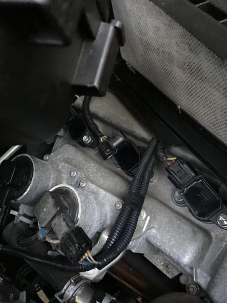

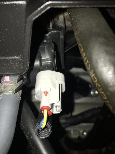

    PLEASE HELP
    I hanged out the spark plugs EXACTLY as described in the tutorial, cleaned the throttle body, the idle is rough as hell, the check engine light came, are the denso plugs the incorrect plugs?!!! Did I put them in at the wrong torque?! I used 180 inch pounds/ equivalent to 15 foot pounds.
    What could it be how can I fix it?

    Engine coil C P5303

    Did you forget to plug one of the connectors back into a coil pack?

    Everybody be cool move along nothing to see here just a little amateur hour
    Additionally the VSC needed to be unplugged gen plugged back in which turned off both the check engine and trac off lights. Holy crap what a freakin amateur show.
    Furthermore the truck is runnning smoother than it ever has now. the transmission still has he hard shifts so I supposed I'll try my hand at the flush and refill then see what that does after I forget to put the drain plug back....happy Saturday everybody
