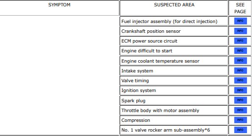

    does it fit your symptoms? here are items to check.
