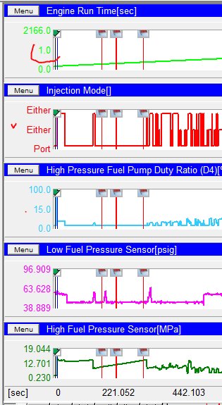

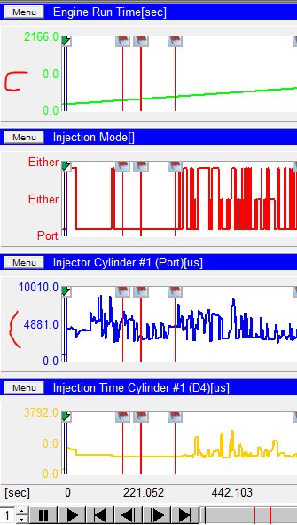

    The the engine fires up , it is in Port injection mode, then it goes to Both Mode for 25 sec., then drops to Port.
    Here are pressure values for 1st second of the engine run.
    and this is how long Port injections are spraying just before the engine fire event. It seems you may have Port injection issues, which lead to a faulty Lower pressure pump, etc.
