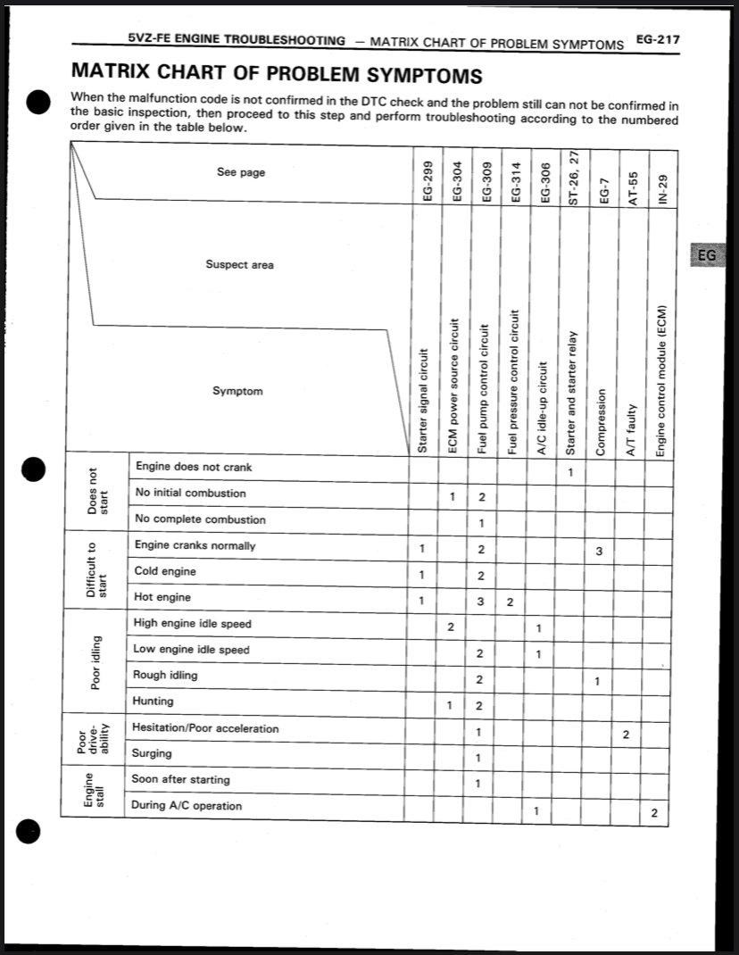

    1997 Tacoma 4x4 SR5 added alarm system, remote door locks, LED headlights, brush guard, painted with plasti dip, double din Bluetooth radio. Nothing really fun or important.
    Posting from IPad at 6 am so bare with me...
    1997 Tacoma 3.4 motor. 350,000 miles.
    I’ve been having hard start issues, not a starter or battery problem. The truck started gradually taking a bit longer to start last summer. Then the ecm fuel blew. Replaced the fuse and had no further issues with the fuse. A few days later the fuel pump went out. I replaced the pump but that did not change slow to start issue. The starting problem got a little worse so I replaced the pressure regulator (rear of motor behind the plenum). That did seem to help the problem a bit and it was a Toyota part, not a Chinese knock off. That didn’t really help much, still slow to start. So a couple days ago it got very hard to start. Now I can’t be sure of this but it may seem to start a little better after setting all night than it does after setting a couple hours. But the crank time is 15 to 20 seconds of trial and error cranking before it starts and when it does it sputters to life. After it starts it runs great. I’m looking at maybe something up with the relay under the dash. I had it out when I diagnosed the fuel pump issue. I also recently replaced the timing belt between the time of replacing the ecm fuse and replacing the fuel pump.

    its worth having a Factory service manual (FSM) and you can follow the troubleshooting for your issue.
    But look at the matrix I posted, if engine cranks normally whether hot or cold but doesn’t turn over then the process is 1-starter signal circuit, 2-fuel pump control circuit, 3-compression.
    If the issues is when it’s cold engine then 1-SSC, 2- fuel pump control circuit
    If the issue is with a hot engine then 1- SSC, 2- fuel PRESSURE control circuit, 3- fuel PUMP control circuit.
    it’s worth having a FSM so you can follow each process so you dont throw parts at your truck. Been there done that.
