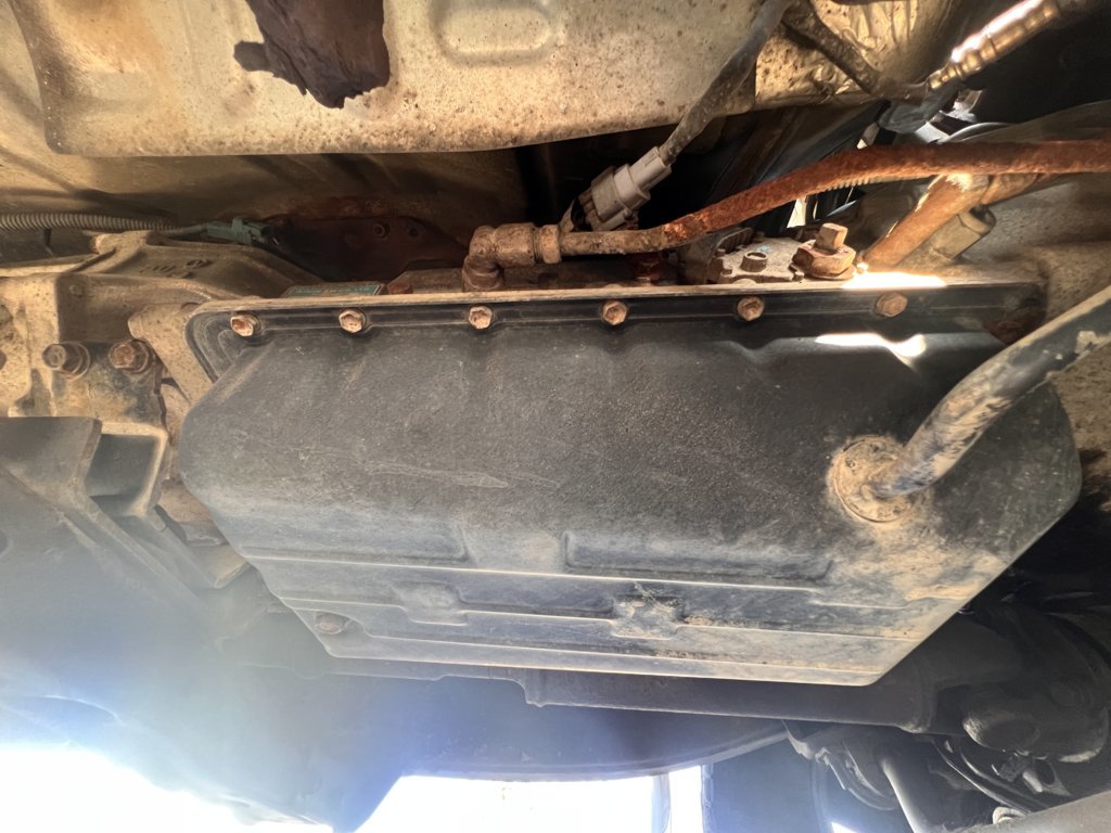

    Next time she doesnt start immediatly, slide under the truck and locate the skid plate under the fuel tank, with a rubber mallet, a piece of wood etc, smack the bottom of the tank/skid plate. As the fuel pumps gets towards its end of life it will get intermittant, jarring the pump via vibrations from the mallet/stick will move the armature on the electric motor enough to make good contact.

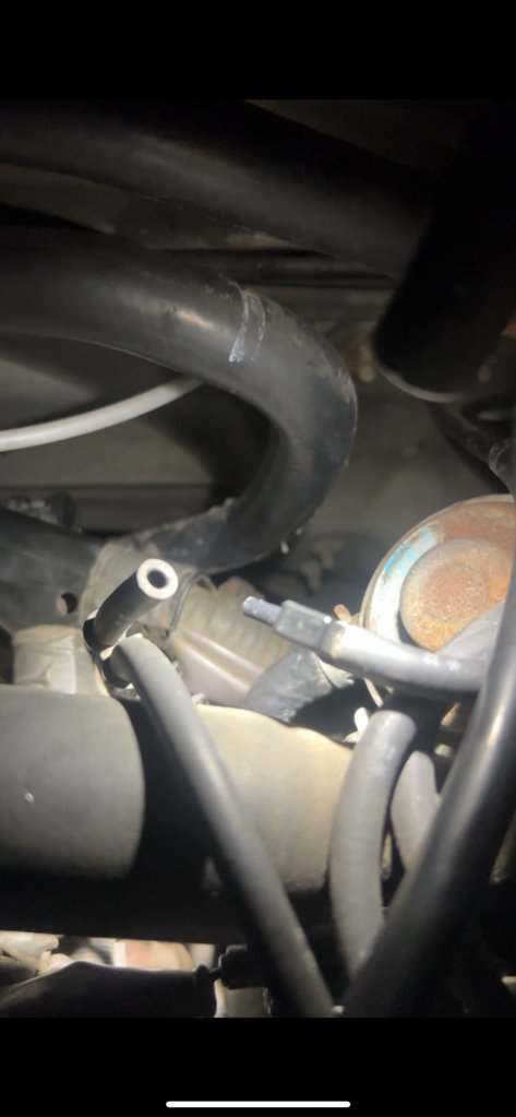

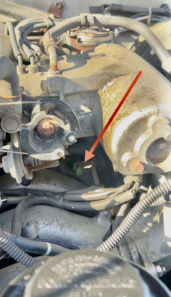

    there is some kind of clicking from that black box and then it also clicks/vibrates at that green clip
    truck will not start while it clicks, once clicking stops it will start up

    using the code I discovered the source of the clicking sound I hear after the engine stalls...
    the Vacuum Switch Valve
    just ordered a replacement which will be delivered today, in the meantime I will remove and clean the EGR valve
