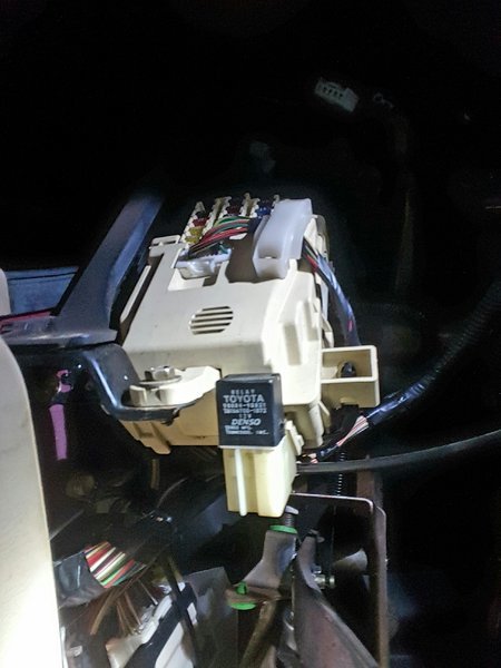

    Tried this and still doesn't crank after waiting overnight. just making sure I unplugged he right relay , I could only find one relay under the dash and it was mounted right beside the fuse block

    I've found a few searches on the internet that say its in outside relay/fuse box

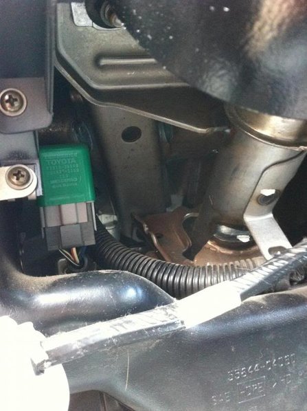

    Thanks for the pic of the fuel pump relay, for the 98 (2.4L)
    Best I could tell it is the relay under the dash, fastened to the side of the fuse block ??

    After closer look that is rhe flasher i believe, only has 2 or 3 wires. The relay will have at least 4 wires/terminals.
