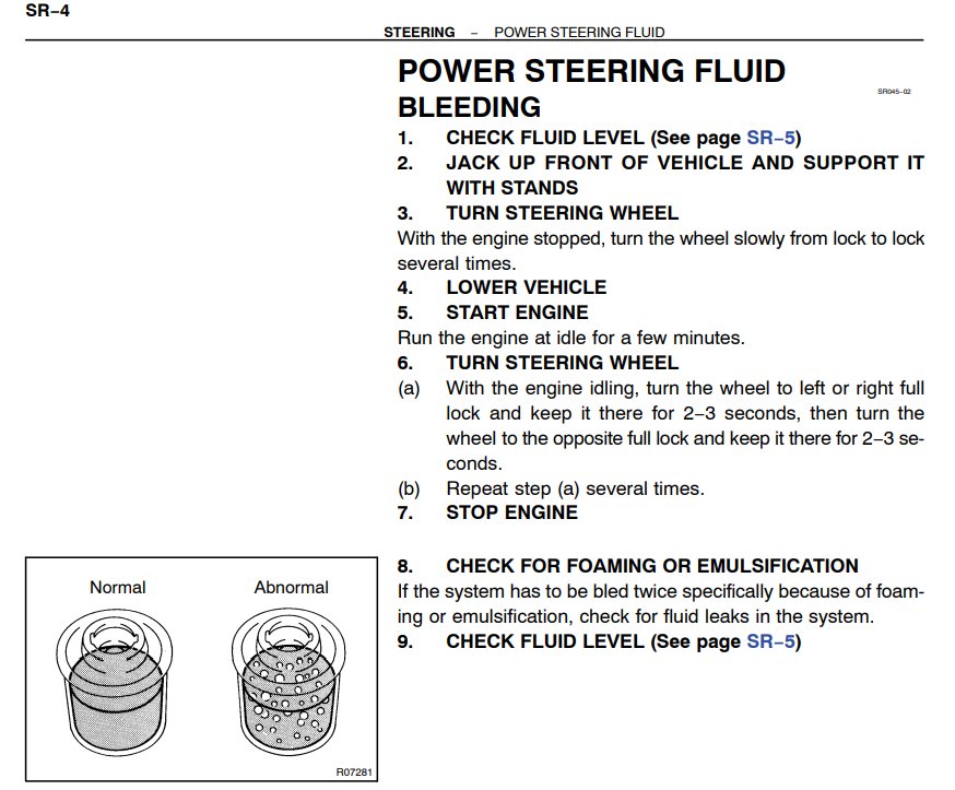

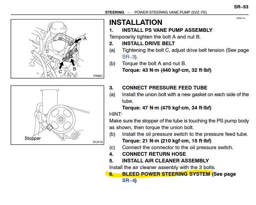

    If you didn't bleed the system, you need to do that.
    Goldie 04[OP] likes this.

    Update.. i didnt bleed the powersteer correctly.. now its way softer just a little noisy, i think im going to flush the whole thing and fill it up with actual dex3 and not just any cheap atf just to be sure that isnt it making it feel a little lagy still or maybe it will go away after driving
