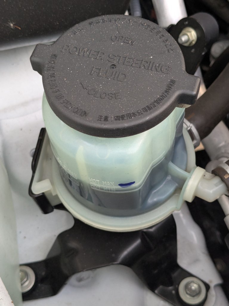

    Its a 2023. Its a all stock SR DC 4wd. Steering feels hard like its lost some power steering. Been that way for a while but not sure when it started but I don't think its always been this way. Fluid looks good. Any ideas??
    It has 15k on improved road miles.

    Wave the fluid in the reserve, it may look like its full but they are known to leak at the rack.

    Looks like it is full. Any other ideas?

    Any easy ways to test if the issue is in the pump or the rack? Doesnt look like any of the fluid is coming out anywhere.

    With truck running. Have someone turn steering wheel and watch reservoir for fluid fluctuation/ movement.
