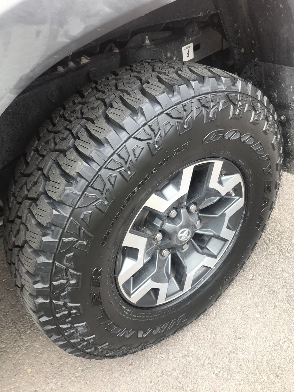

    i went from wildpeaks to the ultra terrains and I like the Goodyear way better worth the extra couple hundred bucks

    What is it about the Goodyear ones that you like more?
