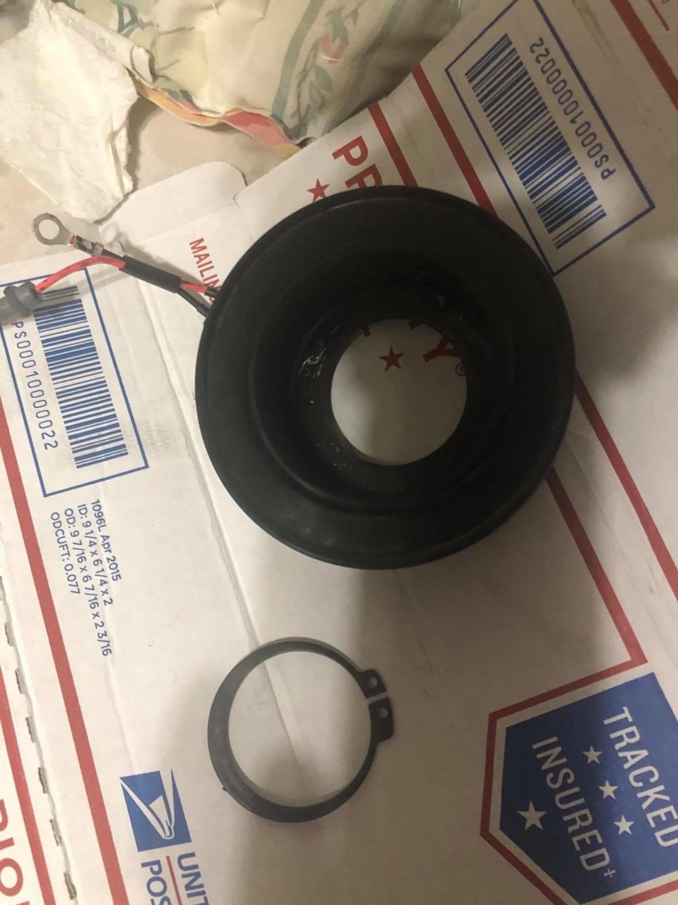

    Anyone got a trick to putting the snap ring on the Ac compressor clutch. I'm struggling to put it in. I have the snap pliers but I can't seem to get it in.

    So you can’t seat it into the hub of the hub of the compressor? You replaced the compressor or you just replacing the clutch assembly?

    just replacing the clutch assembly. hard to get the snap ring on.. when the compressor is still in my truck.

    Oh yes, can be a bitch to seat into the land area... it’s beveled the snap ring is correct? And you have it going in the right direction....

    It’s been a while since I tempted this in the truck BUT once you get the snap ring close to seating , sometimes you can take a flat head screw driver and a small hammer to tap it into the ring land

    I just did a compressor and clutch replacement but was on the bench when I put those together. Struggle some to get the snap rings into place. Just make sure it’s seated correctly before you start the truck.... shit can make noise and ruin the new parts installed

    yes its bevels. I have the bevel side face outward

    Ok... so how far can you seat the snap ring?

    You got a pic of it somewhat installed?

    no. I can't get it to seat with clutch on. I can get it on with no clutch when I was testing it out. Might just have to try it some more tommorow

    Does the snap ring seem close to being seated? Hard to tell probably?

    it was close.. but I might try pushing it in with something

    Have you googled this? May be of some help? Is the magnet in?? The first part that goes on, then the pulley and the. Clutch... which part is the troubled part?

    i'm having trouble putting the magnet on. Thats the part I took a picture of.

    Ok. It lines up with a notch on the compressor ... I’m sure you got that?

    yeah i line it up so it doesn't move
