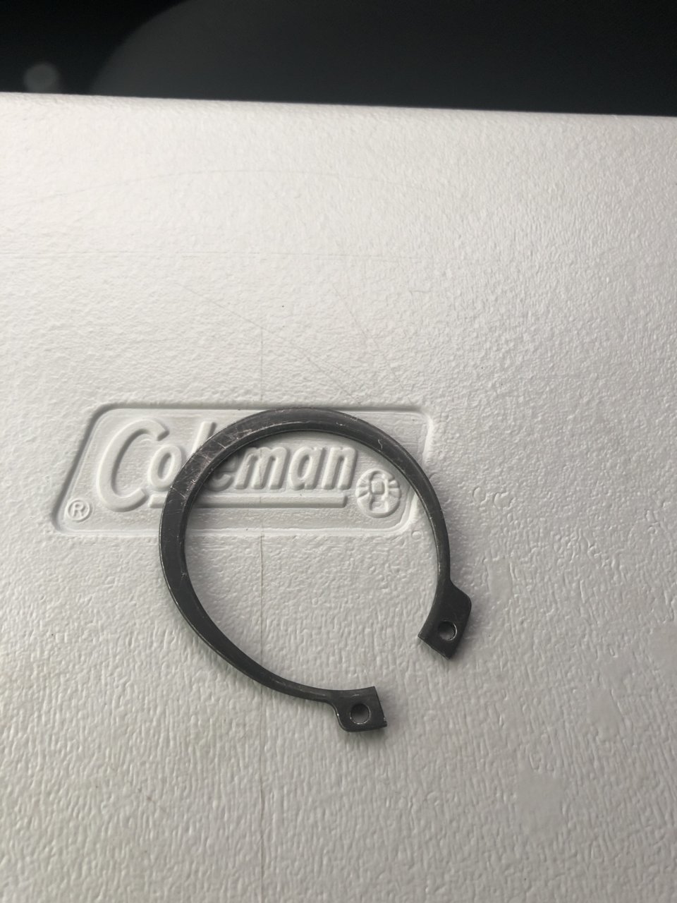

    Not good I bent the snap ring. I bought a heavy duty snap ring plier and bent the snap ring. Now I got to wait until Wednesday for the dealer to get some.

    Found my spare snap ring that I dropped in my driveway. Clean the mating surface and magically it goes on 1st try. Everything runs good. Quietest I have ever had it. I did change all the idle pulleys also.
