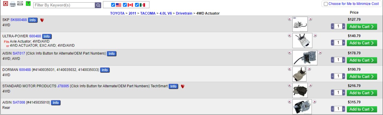

    does thoses replacements are good?

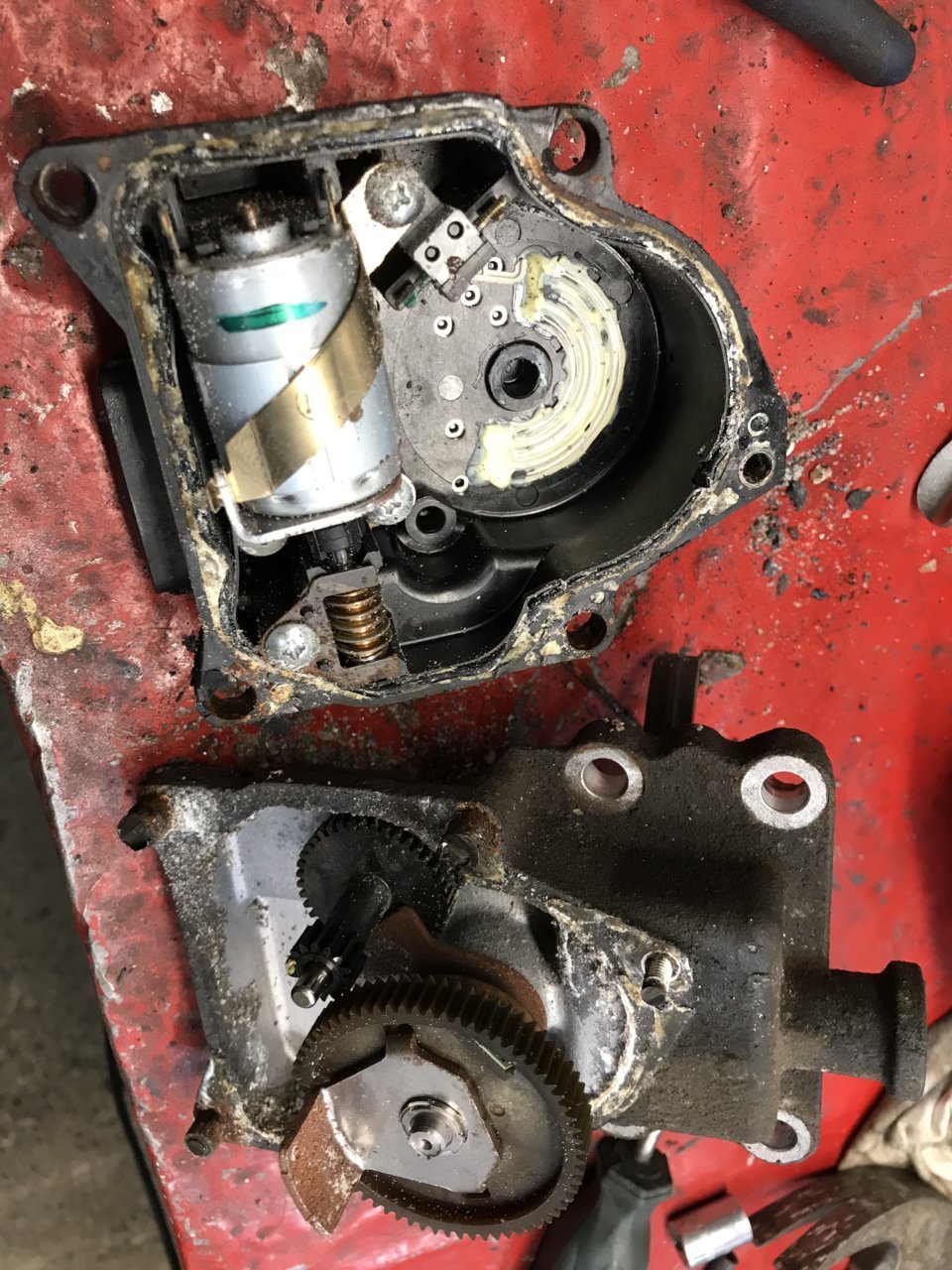

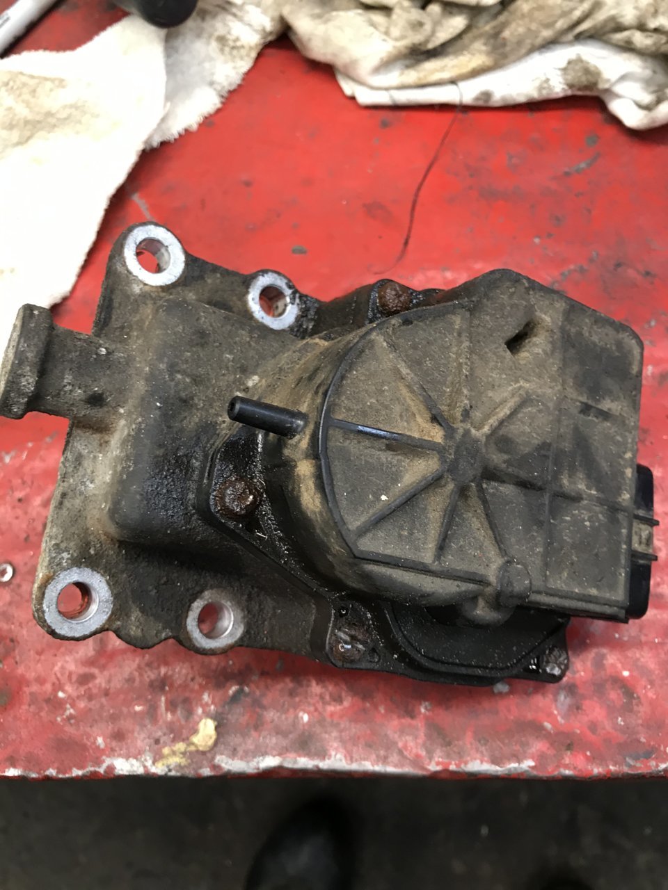

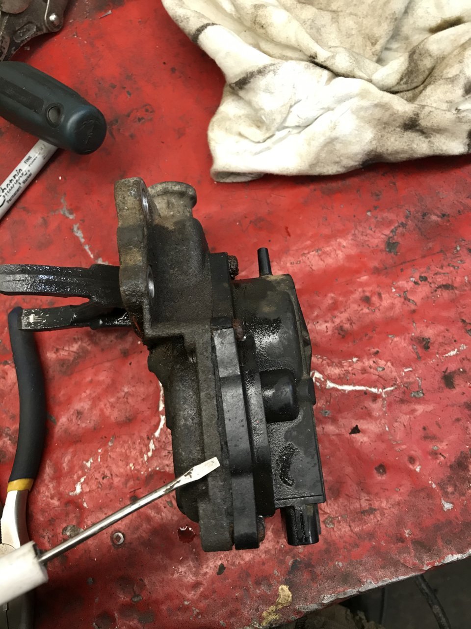

    i can’t remove the plastic cap, but I think the actuator does not like Canadian winter!

    Mine was not repairable, rust inside, rust had broke the plastic cap

    Wow .
    Did you take your truck swimming a lot ?

    No swimming! Winter and salt on road! 10 winters

    I get just as much salt as you .
    My ADD is still going strong in my 2010 , but I can imagine what it looks like inside .
    Maybe I will take it apart and solder the connections for fun this summer
