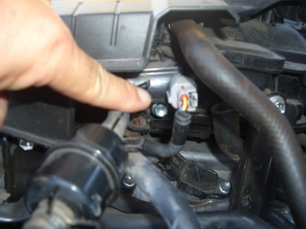

    Remove the vacuum line going from the canister to the purge valve, and also unplug the connector. Turn the engine on and check for vacuum at the hose nipple. There should be none at all. If vacuum is present the purge valve is leaking and needs to be replaced. If leaking it's basically a intake leak that sucks vapor into the engine. It could be throwing off oxygen sensor readings and setting the P0420. The p0441 is trying to say the purge valve isn't working correctly and the 455 is large leak I believe

    It’s on the driver side of the engine bay.
