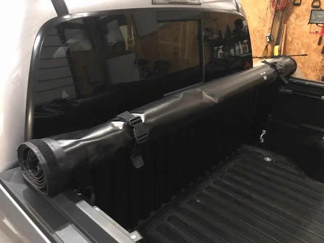

    I bought a softopper because I didn't think I'd want a shell on all the time sucking gas mileage. However, I'm starting to think a hard top might be overall more practical for some things but since my truck is also my daily driver I don't really need a topper 95% of the time.
    For those who went with a hard top:
    1. What sort of impact do you see in gas mileage - especially if you have one that's taller than the cab?
    2. If you need to haul branches to recycle or anything larger than the internal space, how much of a hassle to remove it? Do you do it often or only if you really can't avoid it?
    3. If you do remove, what do you do about storing the topper?
    4. What do you primarily use it for? If it's largely unnecessary a lot of the time (e.g. your daily driver) do the few times it's useful outweigh the downsides of it always being there?
    5. Do I need to add a leaf?
    6. What did yours cost (brand/model) and what features do you feel are necessary? Side windows seem a given so my dogs at least can get air and offer some side access. What else?
    Thanks.

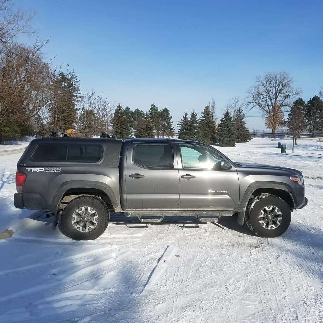

    I have a ARE CX series on my 2016
    1. Little to no impact on mpg, I get 13.5-14.5 regularly... 285s did that.
    2. 4 bolts and it’s off, third brake light is wired with a quick disconnect (4 pin trailer plug) requires 2 people.
    3. Removed only once, and set it under my carport out of the way.
    4. Got it because I always wanted one, and I can keep all my gear back there between trips securely and dry. Do I need it on all the time?? No, but I think it looks sweet anyways.
    5. I didn’t do any rear suspension mods, I was a bit higher in the back before... and now it’s about level.
    6. Mine has sliding fold-down front window, sliding side windows, roof tracks with Yakima feet. But as far as cost, I cannot say due to buying second hand off Craigslist for $900.
    Overall it was a worthwhile investment, only thing I’ve had to haul that was a pain was my factory side steps when I sold them, too long to close rear window all the way... too big to put through sliding window. Other than that, I love it and I’m super happy with it.

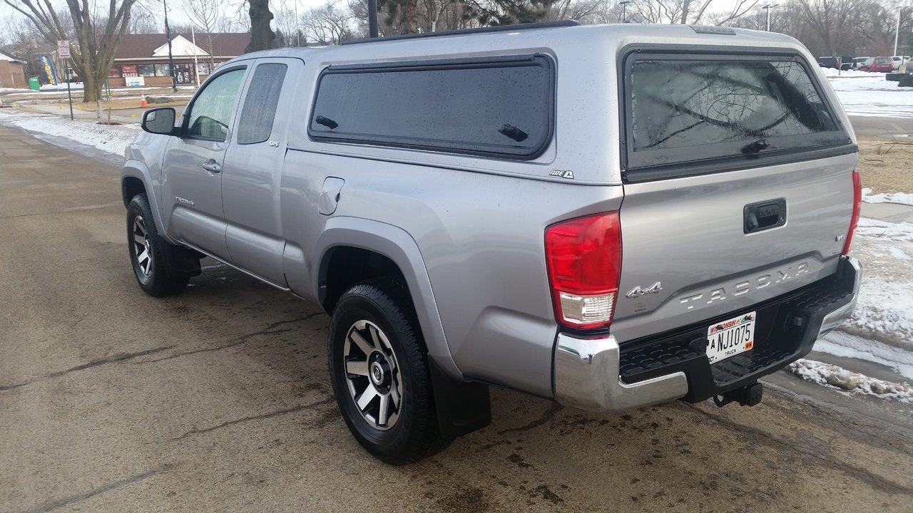

    2016 tacoma trd ord
    ARE cx hd it was 2k new
    No real mileage change a fuzz lower
    I’m on stock suspension so it’s level now but when I pull my pop up and have the rtt on the bars is squats.
    Everything is high and dry and locked up.
    Mine is daily driven I don’t take it off and if I need to haul some junk I go get a U-Haul trailer for 30 bucks.

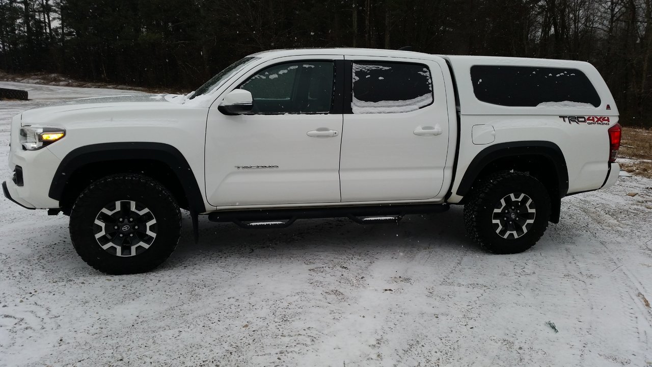

    1. No impact to fuel mileage.
    2. You tend to make stuff fit in the space you're given. Removing it is a PIA, and even if you plan on removing and replacing it often you'll end up either leaving it on, or leaving it off.
    3. If you do remove it, just lay it on 2x4s anywhere it won't get damaged or stolen.
    4. If you haul anything of value that you can't or don't want to watch 24/7, its more than worth the cost. Same if you haul anything that needs to stay out of the weather.
    5. The cap leveled my truck, and any additional cargo makes it sag. I added Airlift airbags.
    6. My ARE CX was $2600 new with windoors, roof rack tracks, interior LED strip that lights when you open the hatch, and a fold down, sliding front window. If you have a long bed get the Windoors, unless you like crawling into the front of the bed whenever you need something. Get a roof rack if you haul canoes, kayaks, ladders, 2x4s, etc.

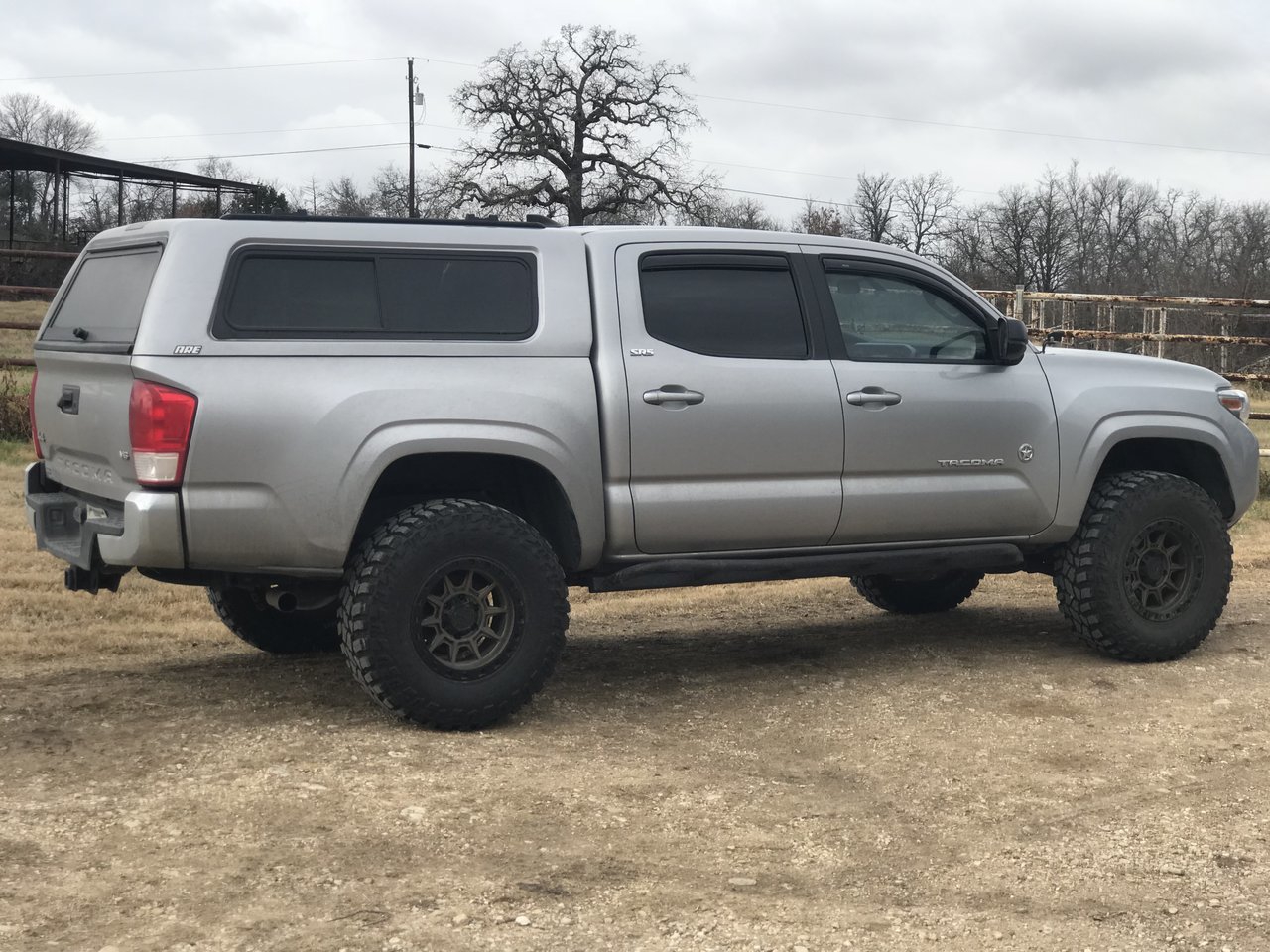

    I have a ARE Overland
    No difference in MPG
    I haven't done any hauling yet but I'll probably use a trailer if I need to.
    When I need to remove it I'm going to set up a pulley system in the rafters of my barn and hang it from the ceiling for storage.
    My truck is a daily driver and I enjoy being able to lock up my valuables, have my dogs ride in the back, and I'll probably do some camping storage cabinet build stuff in the back.
    I didn't add a leaf, I may on the future do something.
    I paid $2600 For the ARE Overland with carpet, led light, sliding front window, sliding side windows with mesh and Yakima rack. In retrospect windoors might have been cool but I like the shell.

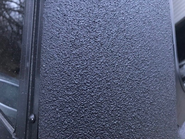

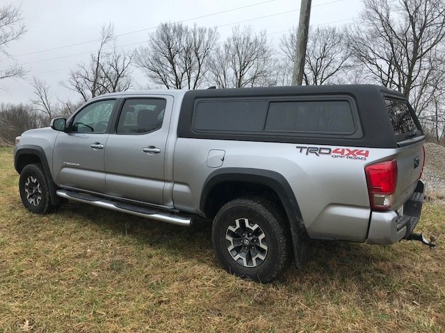

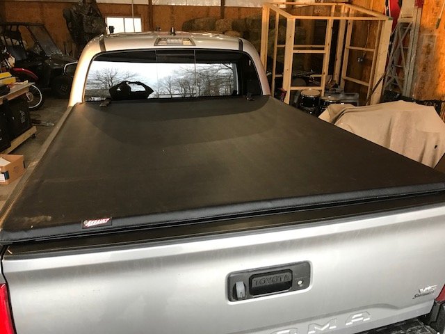

    I have the best of both worlds. I have an ARE shell professionally covered with Scorpion coating that is guaranteed for life. And I have a soft roll-up tonneau cover. I had been looking for a long time for a topper but wanted to find one used. I hated to drop the minimum 2 grand right now. So I bought the Tonneau for $149 on Amazon and 2 days later a used topper came up on Craigslist. I don't need the topper all the time, but I play drums so it works great when I have gigs, or if I plan to haul something valuable in the bed I want out of the weather. 90% of the time though I will just run with the tonneau. For $149 I have in to it, I am just gonna keep it. My truck is on stock suspension. It HELPED my mpg for highway driving by about 2mpg. (I drove 275 miles to get it and got 16.4mpg at 76mph on all interstate driving. On the way home I got almost 19mpg with same route and speed). 4 clamps lets it come off...the same 4 that hold on the tonneau, so that is really easy. Small plug to undo for the interior light and 3rd brake light. 2 guys can handle it pretty easily. You do not need an add a leaf. It weighs probably about 150 pounds.

    What finish is on the outside of your shell? Did you do it or have it professionally done? I have one that is Scorpion coated from a shop that specialized in spray-in bed liners and the like.
    MECtacoOR[QUOTED] likes this.
