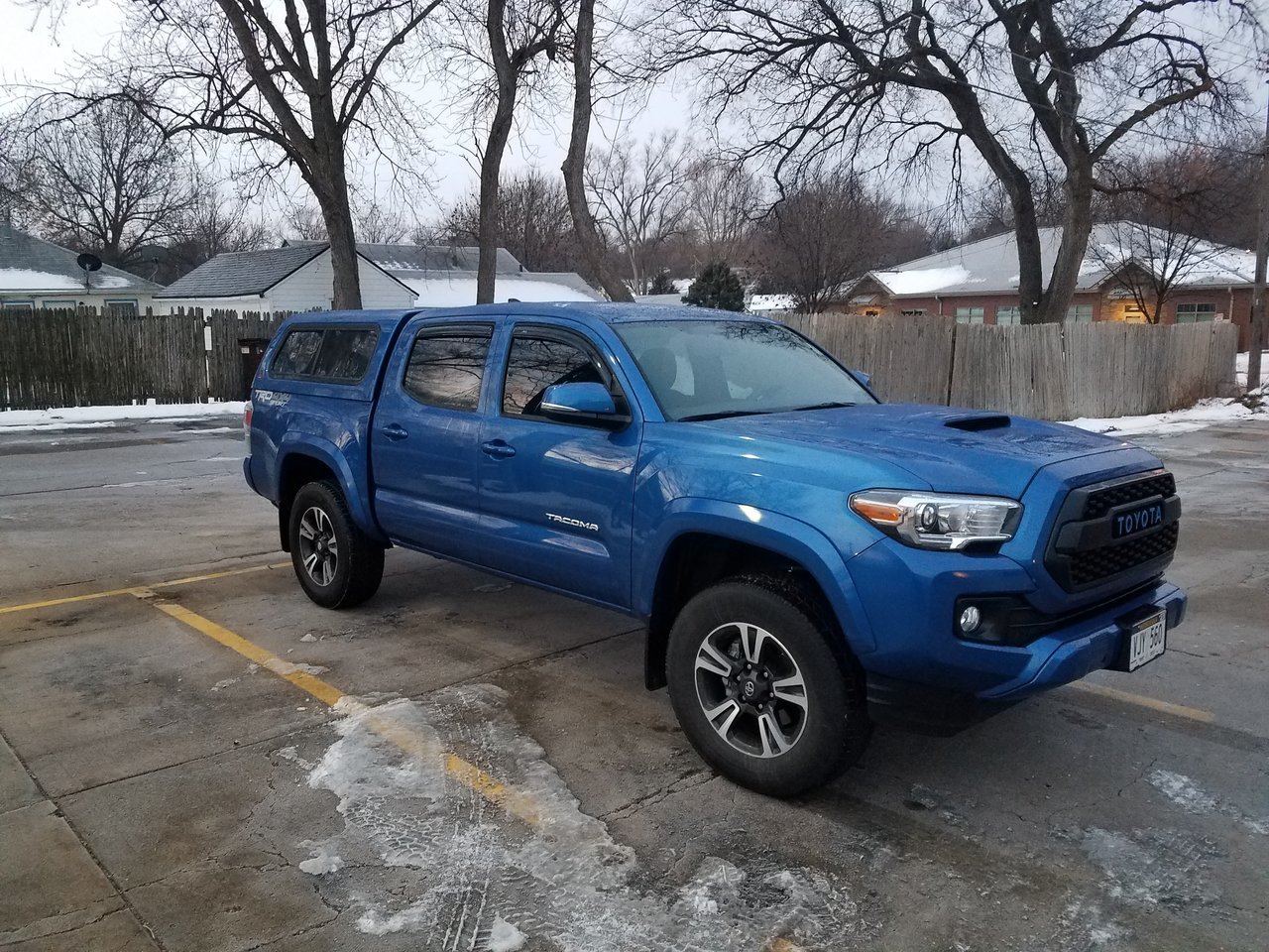

    2017 Blazing Blue Pearl Tacoma Sport DCSB
    I went with a Leer topper (legend series) based off of price and what I am going to use it for. Love the added security, ability to keep the dogs in it (Husky and German Shepherd have too much hair to be in the cab), and camping. MPGs have not been noticeably affected and ride height seems to be level now with this on. Removal will probably not happen to be honest, I will just borrow a friend or my dad's truck if I need to move a fridge. Total cost was $1374.58 after tax installed, which was cheaper than Century and about $400 cheaper than ARE. Super nice being able to keep my hunting clothing, boots, and bow all back there and still have space in the rear seats for people and the baby come August (that is the argument that I convinced the wife that the topper was a good buy).
