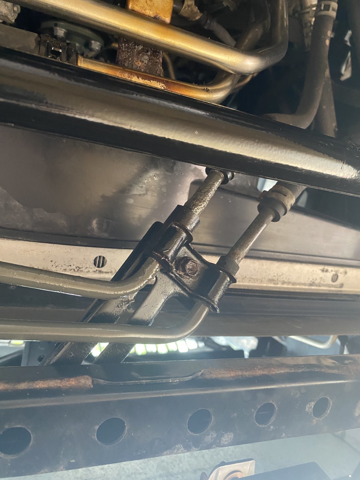

    I have a 2017 off-road sport, the transmission cooler lines underneath the front of the car, underneath the fan have started to corrode and are slightly leaking, If anybody’s experiences before, are you guys replacing them with the same same hardline or switching over to rubber?

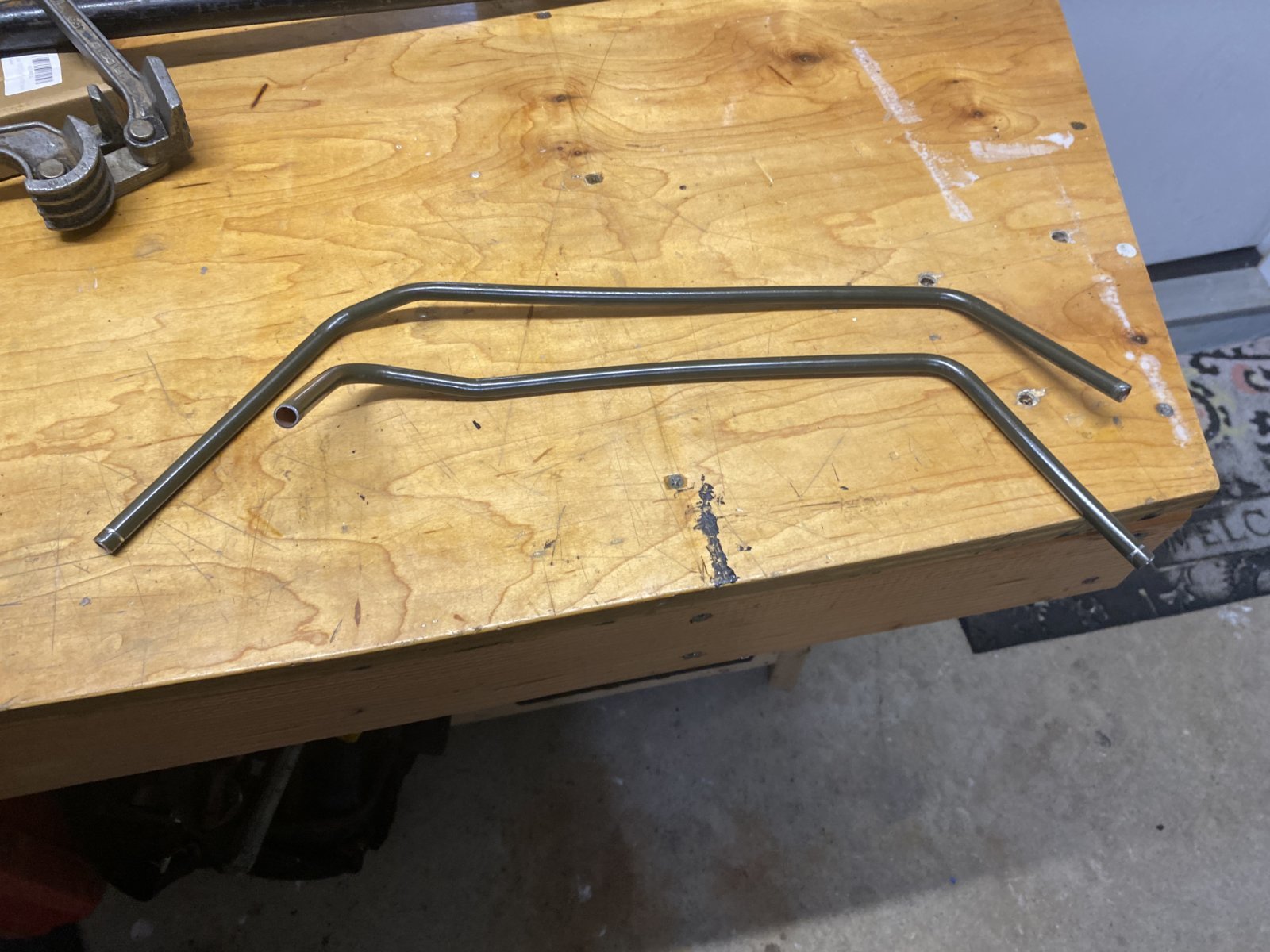

    Just bent these up

    You sure thats the source of the leak? Granted it doesn't look good, but the lines above it are also soaked.
    Also for what its worth, Id avoid rubberized coating. Seen it fail more time than I care to count.

    Oh yea, I’m sure, I cleaned underneath with degreaser, then wrapped the suspected lines with an oil absorbing rag, drove around and everything stayed dry…..except that absorbing rag. I didn’t see the flex seal hurting, worst case I have plenty of tubing to replace it with.

    also you could buy the pipe and a bender, or shops that build hydraulic lines could make the pipe part

    That’s what I did, those lines in the picture are the ones that I bent myself, $32for a 25 foot coated roll

    Yeah, that was the price that I saw, once I clamped the hose onto the hardline I really gave it up twist and pull and it seemed pretty solid.

    ]It’s a pickup, not a high performance car, I used what I had available at the time‍ at 1/3rd the price, same result in. The end to the leak I had, plus it’s more fun making the part than just buying it!
    If this were a “Jerry rig “I think it would be made out of copper or maybe vinyl tubing haha. I literally used the same material that Toyota uses, but What do I know, I’m just a simple man trying to make ends meet
