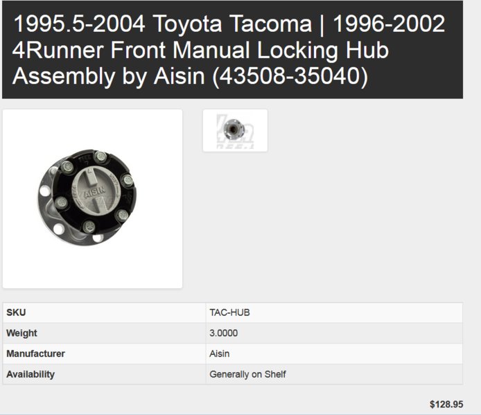

    Okay, worst case, I run the crappy Autobone CV and end up having to shell out for one of these...
    That's not terrible, but it'd be nice to find someone that had one laying around and wanted to unload it. :D

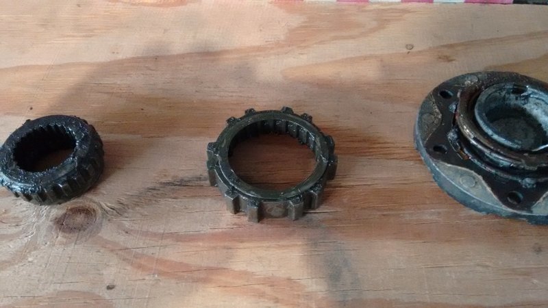

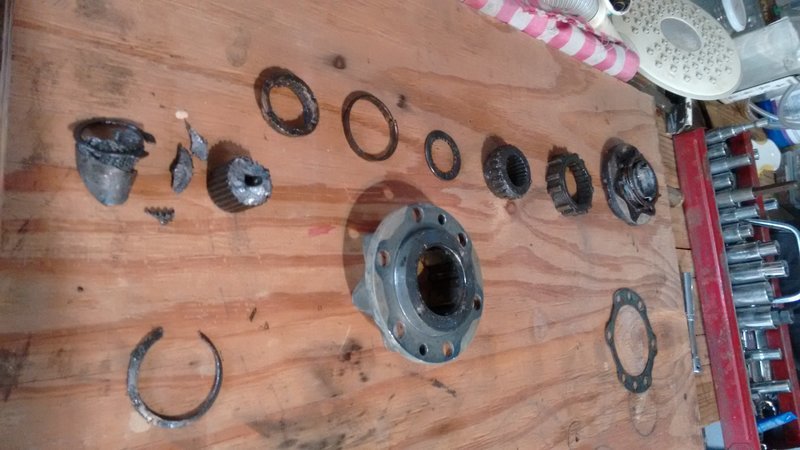

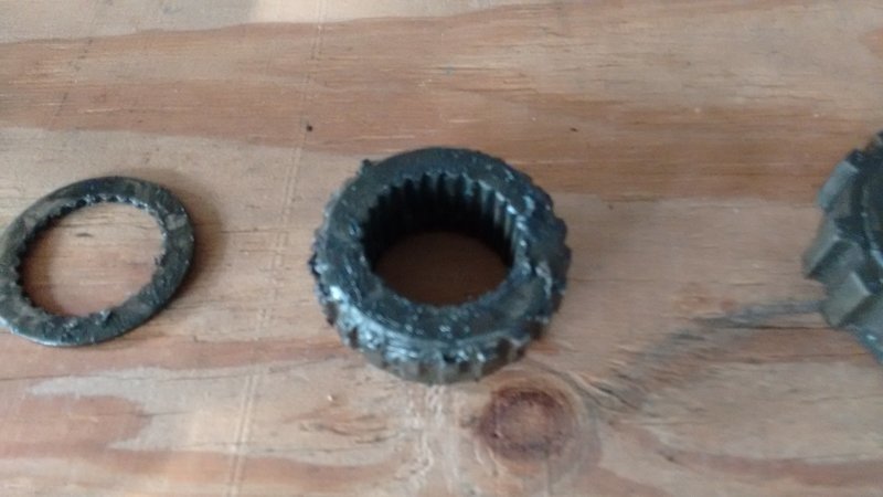

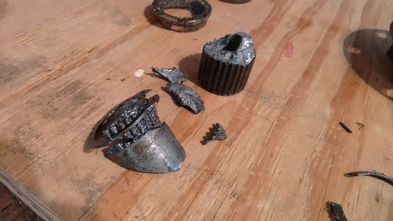

    Lee, what all actually broke in the lock out hub? You may want to see if you can get some 300M gears for your's and rebuild them. If the face broke and they're the same as a solid axle ( which I think that part is) I may have a replacment you can have. The gut's won't work though.
    Taco No Baka likes this.

    Haha, I think the hub body might be salvageable. Pretty much everything else came out in pieces. I haven't really looked too closely at the bits to see if it can be put back together or if it's all a right off. I know the snap rings and the bronze bushing-looking thing are all pretty mangled but the sliding gear might be salvageable, maybe. But with my luck, probably not.
    Haha, I was kinda hoping you still had your IFS lockouts. I thought maybe those would work, but I'm not sure.

    I actually used my IFS hubs (with Longfield 300m conversion gears) on my solid axle. The ones that came with the 83 axle were beat to shit, but the faces and selectors are fine.

    If the whole inside is destroyed you're going to need a whole new hub. I don't see anyone that makes good replacement gears for the IFS hubs. Junkyard may be your best bet.

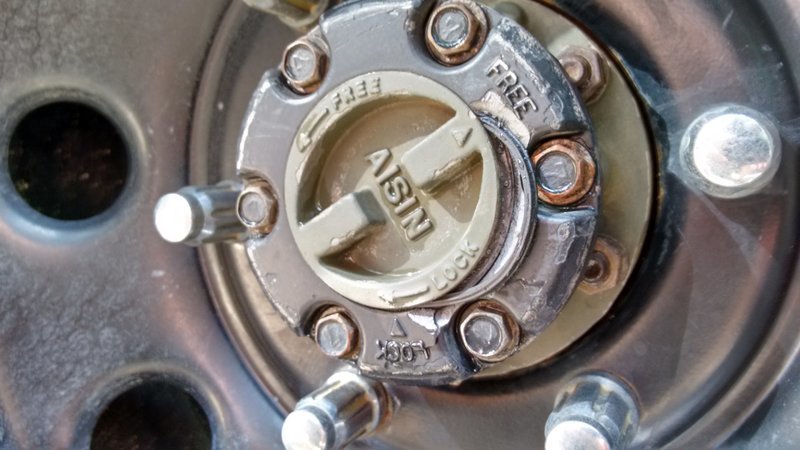

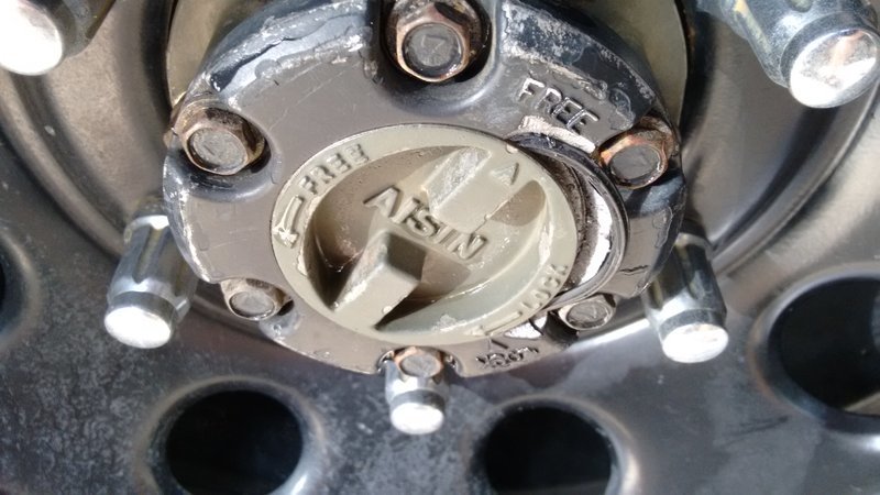

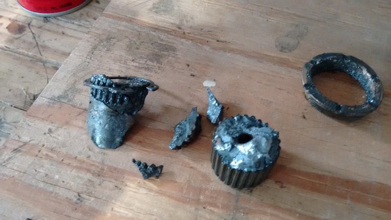

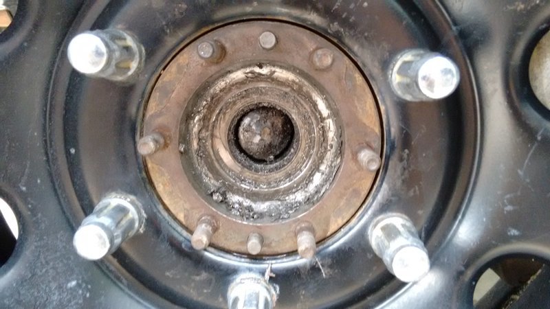

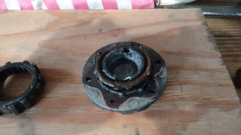

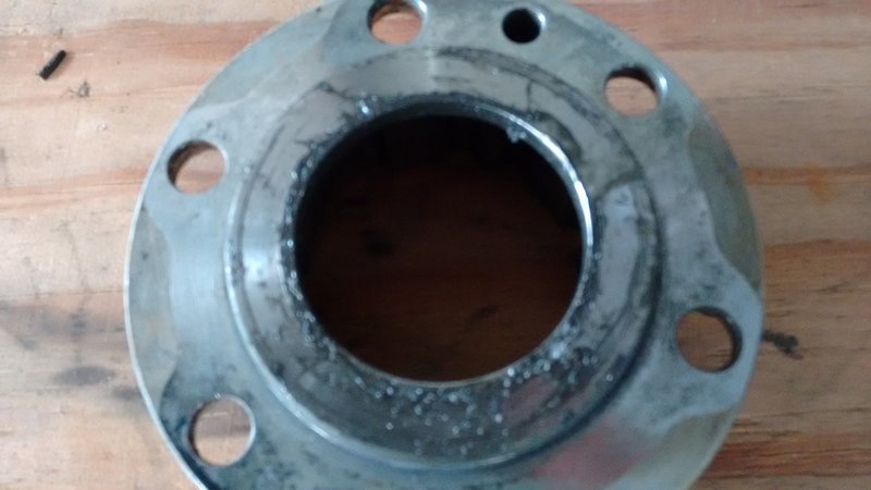

    k, well, hmmm...I'd definitely need a new selector ring face. The selector dial looks like it's toast as well, and hopefully it didn't break and let that stupid ball and spring detent escape, but I know I can get another one of them from Marlin Crawler. The hub body is probably salvageable, so I'd just need to get another axle gear, bushing, and maybe the sliding gear although it doesn't appear to be damaged that I can tell.
    IMG_20170430_172004151.jpg IMG_20170430_171936813.jpg IMG_20170430_171941780.jpg IMG_20170430_171948312.jpgIMG_20170430_171957083.jpg

    Car-parts.com is an online salvage yard search. I found a used 4x4 non-automatic disconnect hub for 40 bucks. Bet they would ship it too.
