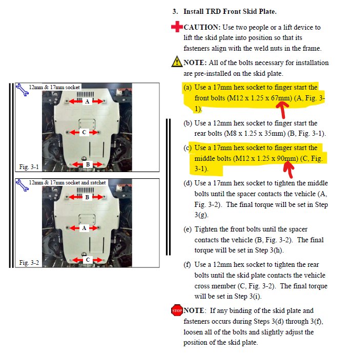

    Hey folks,
    Can someone kindly let me know which holes take the big spacers, small spacers, etc. on the TRD skid plate? Thanks in advance!

    Longer spacers/bolts in the middle... See attached install instructions.
