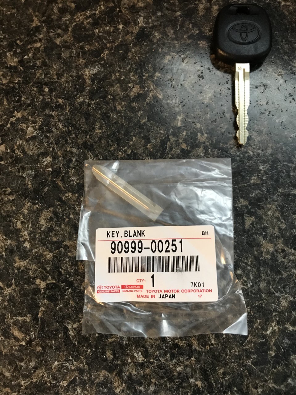

    He was doing me a “favor” by cutting the key for me. I just wish he knew what he was doing.
    Update: New key from eBay has been shipped. I’ll let everyone know how I make out once it arrives.

    Got a freshy in the mail today.. gonna bring to a Lowes or HD tomorrow. This key says “L” on it though. Hope that isn’t a problem but we’ll see

    Alright boys.. did a little more researching and found I actually need the “dot” key as mine is a 2005. So technically the “G” key wouldn’t have worked anyway. Just ordered these on Amazon.
    2 NEW TOYOTA REPLACEMENT UNCUT TRANSPONDER 4D CHIP CAR IGNITION KEY - WITH LOGO https://www.amazon.com/dp/B01GBT9OSW/ref=cm_sw_r_cp_api_egVQBbZV37RRM
    I am pretty sure I’m SOL with copying the valet key myself. But I’m going to still try for fun. Worst case I’ll have to go to the locksmith or dealer

    Ok the two new “OEM” keys came in the mail. I’m not sure they exactly OEM but they look almost identical and were $16 for 2 on Amazon so who cares.

    I ended up returning the second key I ordered from eBay because it wasn’t the correct transponder key. Thanks to Muddinfun for pointing that out.
    Went to Home Depot tonight and bought a cheapo key for $5 just to open the doors and he cut one of the blanks in the process. He was using one of those machine rigs and was worried about messing up the transponder blanks so he recommended I keep the second one for a backup which I did. Got out to the car and both keys cut only turned the door lock to the lock position which was a bummer. They did however both turn the ignition which was the important part. I checked my original key in the door and it also wouldn’t turn the door.. hmm it worked last week just fine. I will have to troubleshoot that later.
    I get home and bust out my keymaker and highly well written instructions...
    I decided to go with this write up for instructions instead..
    https://www.tacomaworld.com/threads/tacoma-key-programming.238286/
    It worked first time! At least I think it’s working. It started the truck and ran for a few minutes no problem a couple of times. I’m pretty sure the transponder has to be in the actual ignition and it isn’t just pinging the original in my front seat. Pretty happy and only about $50 bucks in including the first key getting jacked up. Plus now I can copy friends if needed.
    Now to just cut and copy the second key. I’ll update this thread if I get stranded down the road somewhere tomorrow haha.

    The reason you are having issues with the door lock is the key duplicator at the hardware store copied your old key, including the wear. A digital key machine cuts the key to the original specs, but is an expensive bit of kit used by locksmiths.
    I’m sure the key jiggle method will make it work in your door if ever needed.
