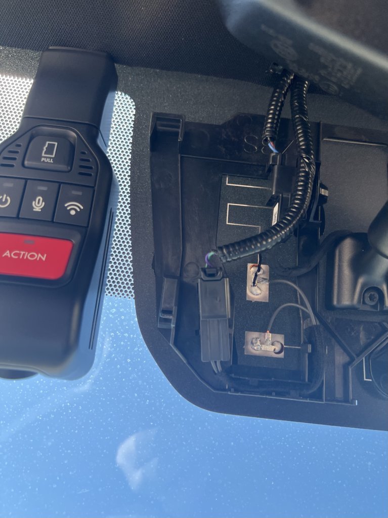

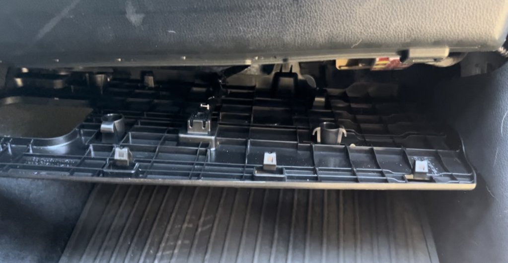

    Not anymore at least. I have the Toyota dashcam already, it came with the truck when I bought it without the option to remove it. Anyway, I have a Thinkware F200 Pro I want to hardwire for front and rear cameras with parking mode. Since the OEM is already there, I’d prefer to just add the Thinkware and have two front facing cameras. The fuse box under the glove box is too tight of clearance to use an add-a-circuit like I did for my wife’s Civic. I’ve read some forums people are using the port for the OEM dash cam - but there is no parking mode for this?
    Do I have any options? Or should I take this to BestBuy to have them install my Thinkware - if they can?

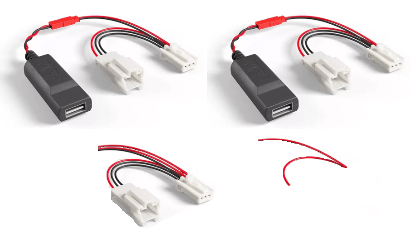

    Spoon feeding here now.

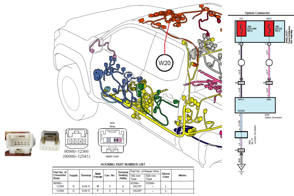

    The connectors required and the info (schematic) shows fused battery and fused ignition source and chassis ground. There's even a picture where the connector is.
    For those with a bit more skill, the parts can be purchased and assembled. With a little skill, one could buy 2 DONGAR's and de-pin the wire and terminals to complete the required T harness.

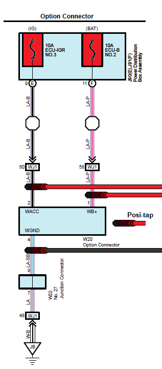

    Something like so:
    Or just purchase some posi-taps and tap into the wires.

    Get posi-taps.
    Follow their instructions on use.
    Use last diagram to tap:
    IGN (wire #2) to Red Accessory
    Battery (wire #1) to Yellow wire
    Ground (wire #4) to ground
