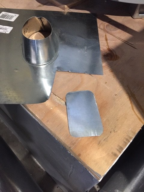

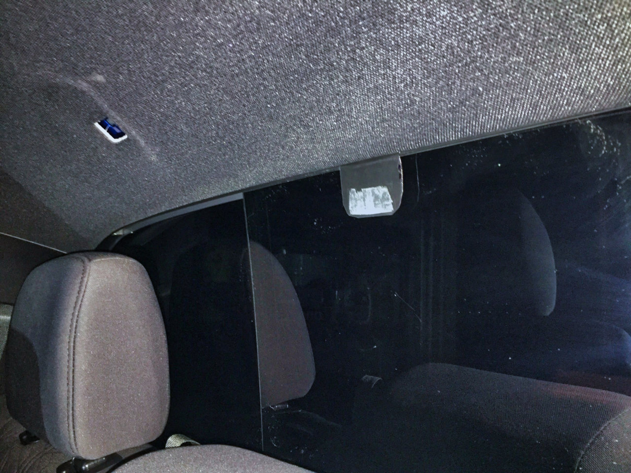

    I ended up buying a cheap roof flange and cutting out a small piece that I fashioned into bracket that slid up behind the headliner and used 3M automotive grade double-sided tape to stick it to the roof's interior. The headliner helped to jam it there as well, but I did spray paint visible parts of the bracket flat black which sticks down about 2 inches and it's plenty strong enough to hold the rear cam. The rest of the install based should be easy enough based on the video and photos that you provided.

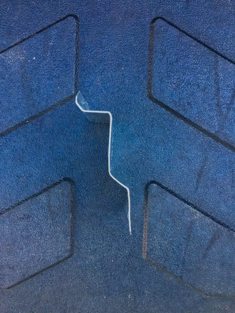

    I bought a roof flange from Home Depot since they were cheap, stiff ( but pliable ), and easy to cut with the tin snips I had. I figured out the basic size that I needed, rounded off the corners, and then started systematically bending the ad-hoc bracket into the shape I needed by constantly going back and forth checking fit and seeing if I was achieving enough "touch points" for the 3M 30lb. adhesive double-sided tape I planned on using. Once the basic shape of the bracket was done, I spray painted the exposed parts of the bracket that would be seen below the headliner and I even left a blank spot of exposed metal so that the rear dash cam would have something more solid to attach to. Make sure that you thoroughly clean the metal with soap/water/alcohol to ensure a clean grip by the rear camera mount. So far, the video is not showing any bouncing or appear to be experiencing vibrations.
    Also, I didn't run my cables up/down the pillars, I just tucked them behind the weather stripping, but I did go behind the pillar panels near the top in inside the door sill covers like you did. Between the two of us, I think we have a good solution.
    I hope the photos help.
