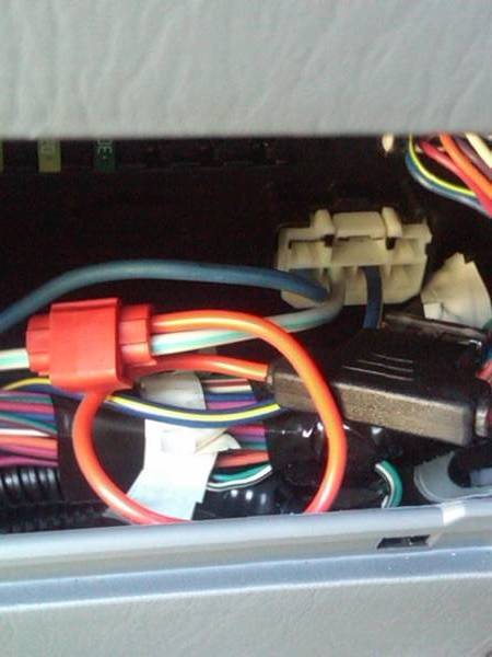

    I did this mod about a year ago, just forgot to post about it.
    I opted for a hardwire Sirius power kit, this one in fact:
    http://www.tss-radio.com/products/sirius-vehicle-power-hardwire-kit
    Check your Sirius model, mine is a Starmate I think that needed less than 12v going to it to work correctly. You can create something from radio shack, but this kit to drop the voltage is better.
    I had enough cable with the kit that I attached it to the wires coming out of the fuse block under the steering wheel. Used a small voltmeter to find a fuse that was on only when the key was on ACC or Run. That way it doesn't drain the battery, it shuts off with the vehicle. I forget what color the wire was will look and let you know.
    I also recommend getting a RF connector that allows you to connect your sirius in through your radio's antenna connector on the back. the wireless transmitter doesn't work very well.
    Edit:
    Here is a pic although its turned 90 degrees for some reason.
    The blue and white wire on my 07 Taco provides power as I stated above. I used the red piece of plastic to tap into the existing wire without having to cut it. These taps can be bought at radio shack. The black plastic part on the right is a fuse block from the hard wire kit I have. That way if the sirius is shorted and draws too much power, the fuse will break the circuit vice catching the interior on fire. You can hide the rest of the hardwire kit easily up under the dash.
