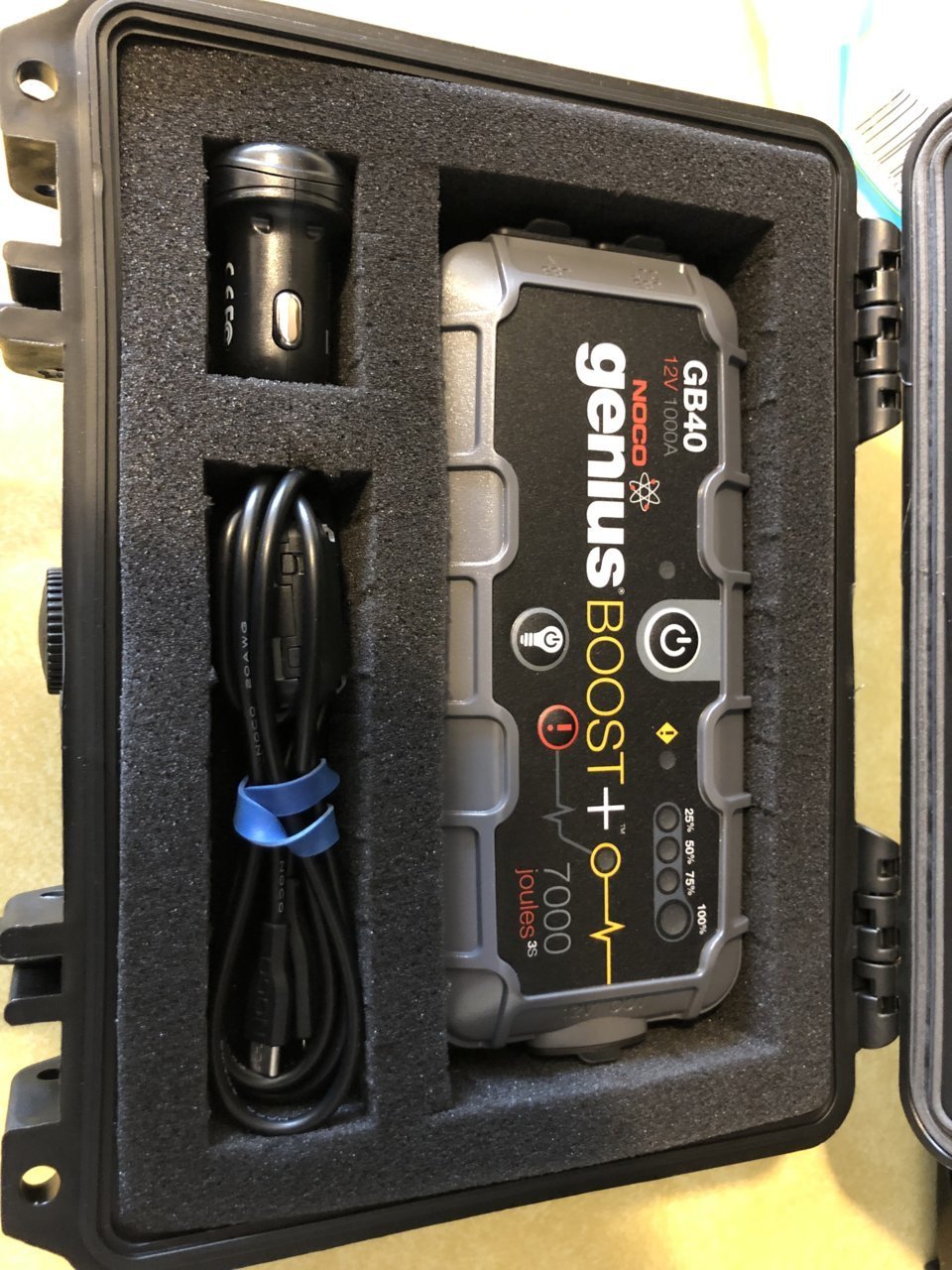

    Always have an emergency battery starter. Saved my behind in several remote locations. Costco sells one.
    Edit: And every time, it's praying... please, please work.

    Had same exact one. But the microusb charging plug got mangled. Looking at it now on my workbench all gutted out. Trying to find the part. In the meantime have the Costco one that I can return.

    That's cool. But they are all basically the same. Lithium battery with capacitor assist and circuit board. Noco encloses theirs with a "rugged" style case. But that is meaningless when things like the charge port is made of pot metal.

    I keep mine in a Harbor Freight Pelican Knockoff.

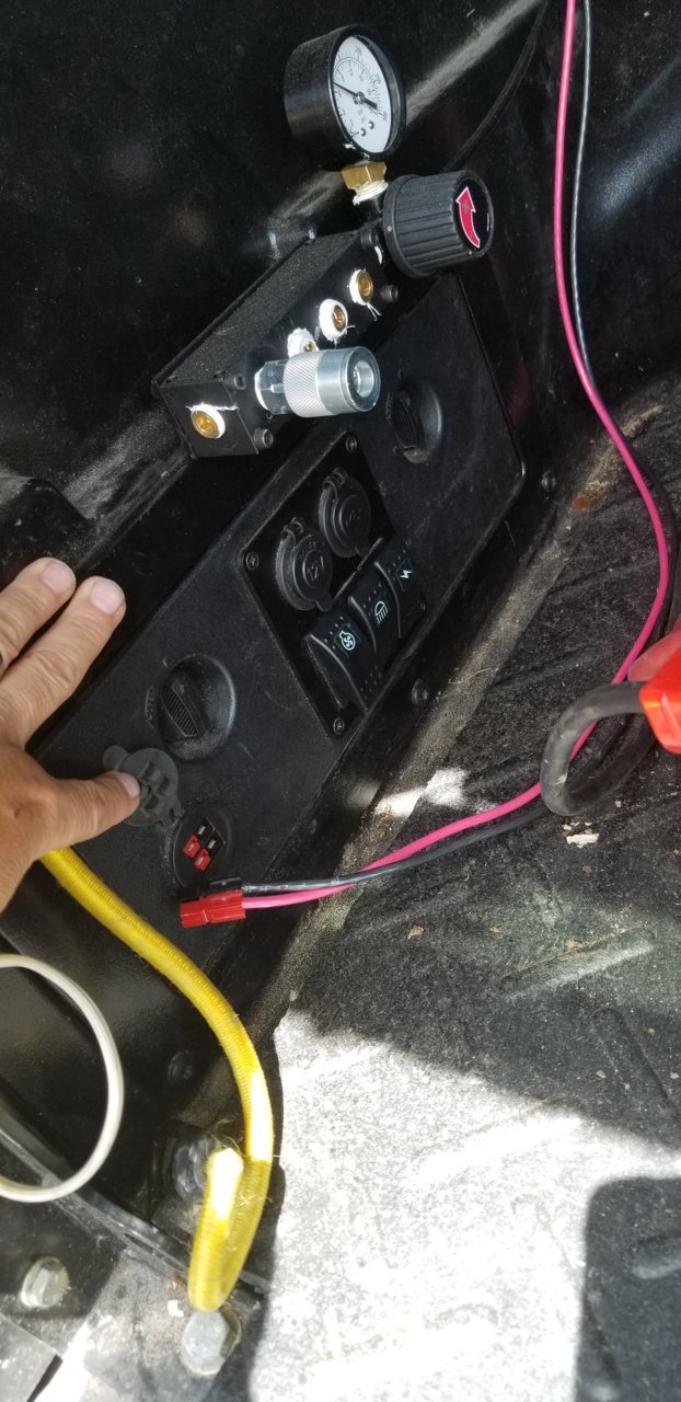

    I made my whole cubby into a panel. I put an A/B switch to switch between truck bat and deep cycle. I plug the fridge into the powerpole outlet when I need to use it. I put the Li battery in a pelican case with charger and solar connectors on the outside. Never have to open it.

    Do you have any info on the panel you used? Did you wire in a fuse?

    Not to thread jack, but did you run air lines to each tire from that block for easy fill up and air down?
