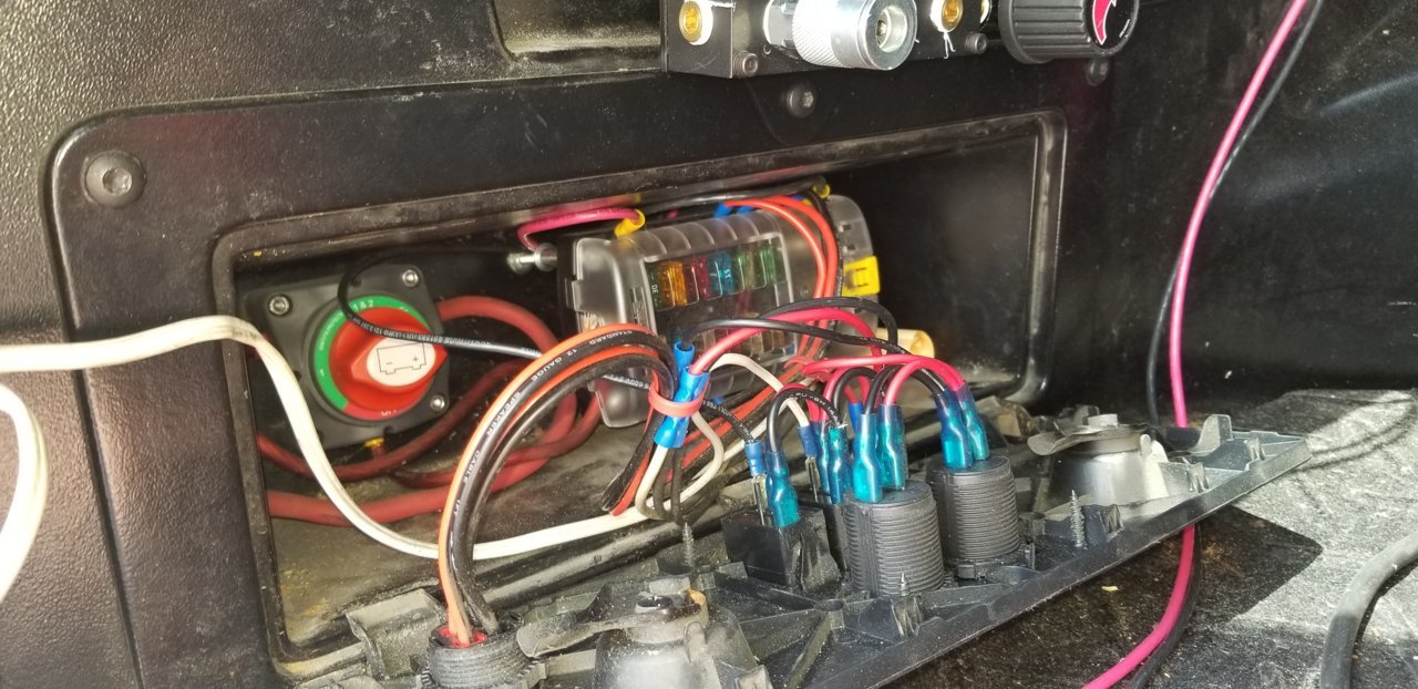

    A blue sea fuse block. The external battery pack has a 60amp circuit breaker in it. The switch panel is a cheapofrom ebay.
    The air manifold is from the compressor in the front of the bed. So I can plug hoses in easier.

    Yeah, Toyota replaced my battery when I bought my truck so it's only about 8 months old. I'm going to make the switch over to a deep cycle dual battery system.
    I figured I'd pick up an amp install kit locally and run that to the bed cubby. Those usually come with a fuse to run inline and decent power wires from my experience(been a few years though).
    Another possibility is installing a blue sea fuse block up near the battery and getting that out of the way (future upgrades will probably require one). That way this motorcycle power block I picked up has extra security in case of a short.

    What gauge power wire did you use to run from the battery to the rear of the truck?

    4g. At that distance it's good for about 60amps. I'll never need nearly that much.

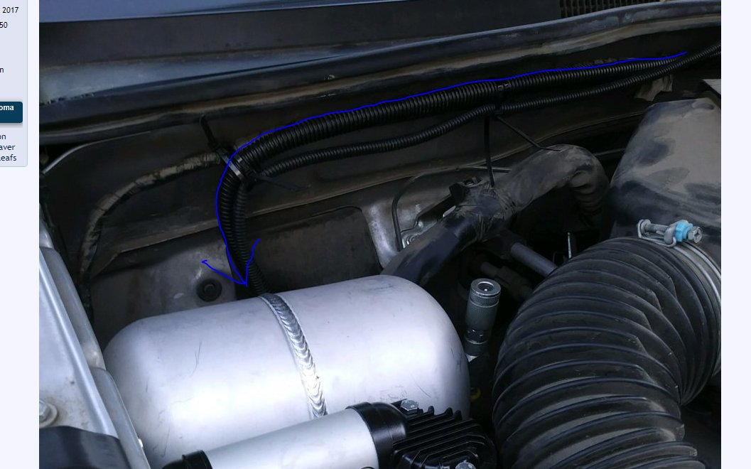

    From truck battery around back of engine bay, down to passenger frame rail where I ran it in the C-channel of the frame.
    This isn't my pic, but where the blue line is is how I ran the cable out of the frame. From there I ran it behind the fender liner and in through a hole I drilled in the passenger side bed cubby above the fender well. The red circle is approximately where I mounted the ground. There was a large bolt sticking up in that locale, just took the nut off, placed my ground, and put the nut back on.

    Looks good Ryan, thanks! What brand of fuse did you put on it at main battery?

    I thought it was like a bussman AMG style fuse... But... Umm... My hood is up and I don't find a fuse...:confused:o_O:(
    Just texted my buddy who helped plan and wire this thing to ask if we put one in. I swore we decided on that, even though I originally purchased a 150amp blue sea breaker...

    And after doing a lil more research I think we might have decided not to fuse as we were originally planning it to run a winch and was gonna need fused at over 450 amps so we just decided not to. Not saying that was a good idea... We just did our best to protect the cable from damage.
