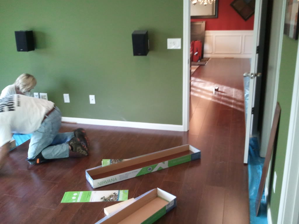

    Cutting the jambs and sliding the floor underneath is the proper way to do it. Cutting around the jambs always looks sloppy and unprofessional.
    Lay a scrap piece of the new flooring down and use that as a guide to cut the molding.

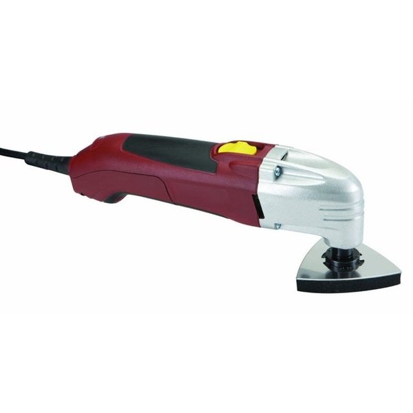

    I'll second the multimaster tool. I used one I got from Harbor Freight for $17 to cut all the door jambs when I did my flooring and it worked awesome.
    Here's a pic of the door moldings cut from when we did my laminate floors.

    Good insight, just want to add to that, if it is a floating floor then you shouldn't cut the jambs, at least that is what i have been told, i still cut them most of the time because it looks better.
    Lol $17!? My multimaster was over $300, that was before any knockoffs were being produced. That floor looks real nice, what kind is it?

    Yep, $17. It still works too lol. I also used it to scrape up all the glue off the slab in my foyer where I pulled up the glue down hardwoods. I definitely got my $17 worth out of it. I think after buying extra blades, I probably have $30 in it now.
    I wore out two wood blades during the project... mainly from hitting nails and stuff.

    Or buy one of these for $20, it will pay for itself after a few cuts lol
