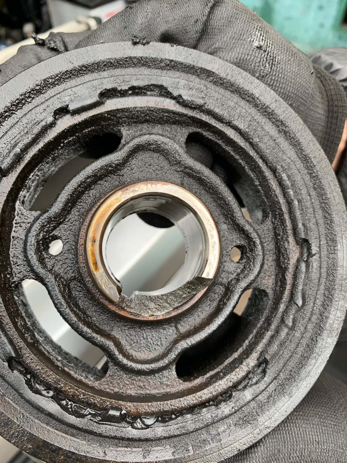

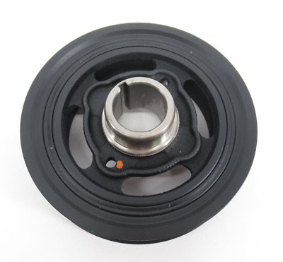

    something like a FluidAmpr would be the best
    according to google images the difference between those part numbers is one has rubber while the other looks all metal.
    or the second one looks metal in the center but rubber on the far outside judging from this other pic of a failed one

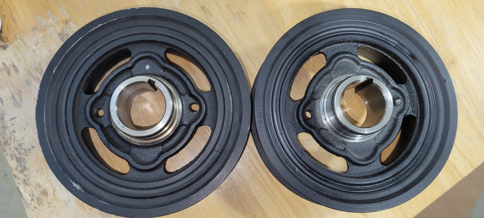

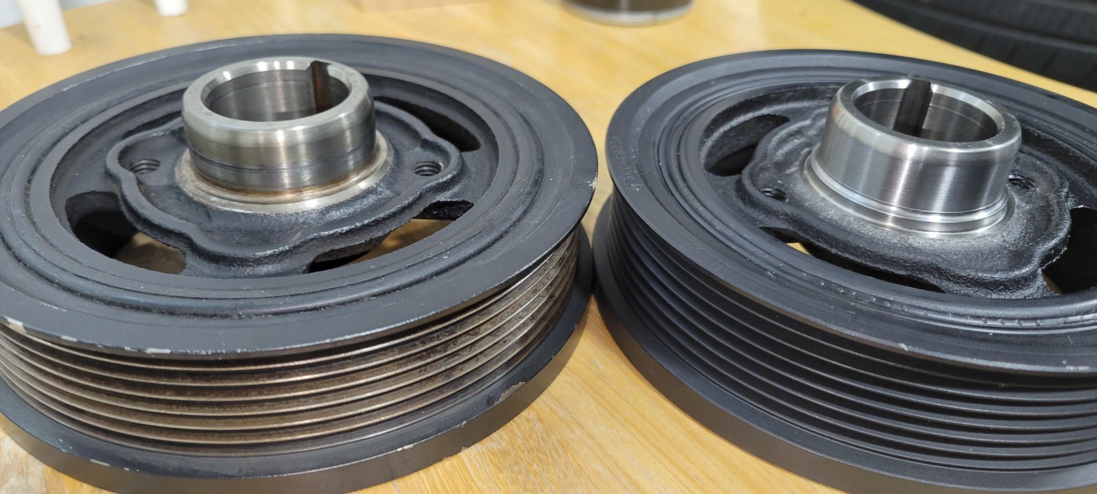

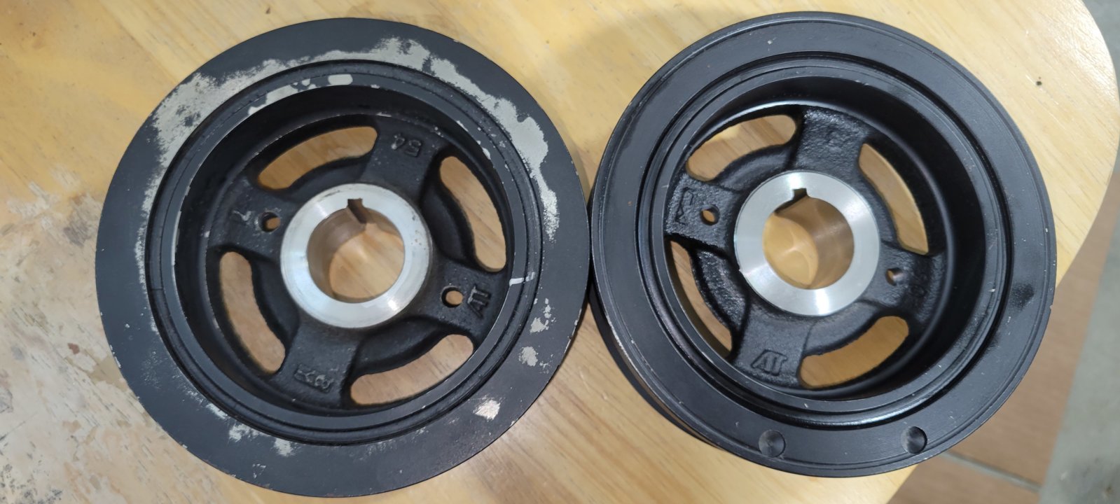

    Here are some photos. The pulley on the left is the old one Toyota OEM part 13470-0P010 (which is L for locally sourced) and Toyota OEM part 13470-31014 (which is J for Japanese made and sourced). One the Japanese pulley, there are two partially machined holes on the face of the pulley and slightly more material on the shaft that faces the engine. The L version has no machined holes and the shaft material is a bit less. There are no clearance issues with the J version part 13470-31014. Both have the rubber for dampening.
    Both part numbers on Toyota parts vendors show both fit my truck. I verified the numbers on not superseded.

    The 2-drilled holes on the J version are how the balancer is balanced.
