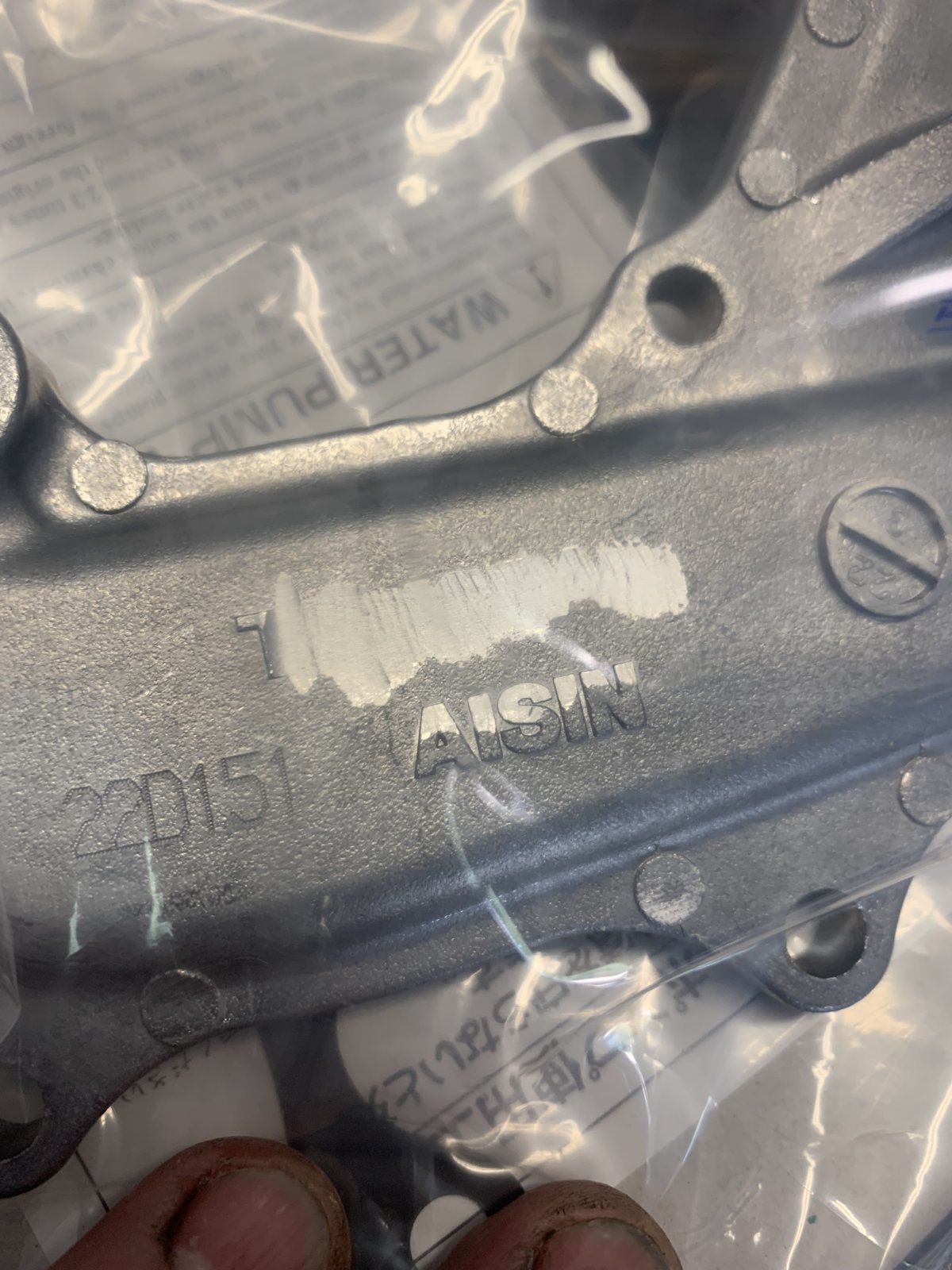

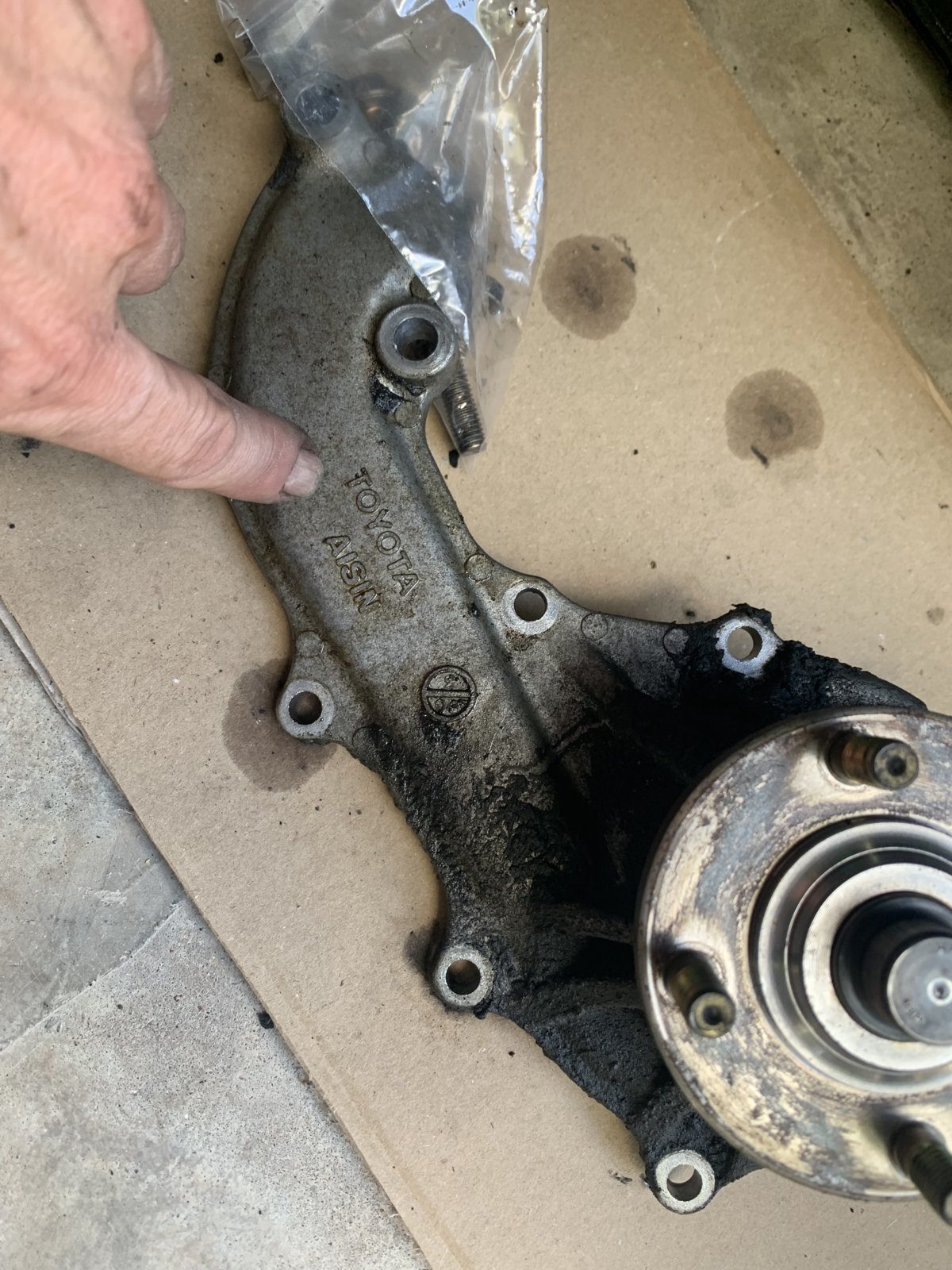

    Might be too late but I would RR oil pump/water pump while your in there
    And
    The rockauto h20 pump is the OEM!
    (I have proof!)
    Just 10-12 bolts

    Original water pump

  13. Jun 15, 2024 at 4:28 PM
    #33
    ControlCar
    ControlCar My Moto: Help & Learn…period.
    Jul 22, 2023
    #429578
    3,472
    Steven
    Sugar Land TX
    1996 Taco 2.4L 2wd Automatic
    Clock Volt meter/LSPV Delete/Hyundai 16’s/FP gauge/after 9months of wrenching ZERO oil leaks
    The OP from RA came with a pressed on crank seal as well and new Allen head fasteners
