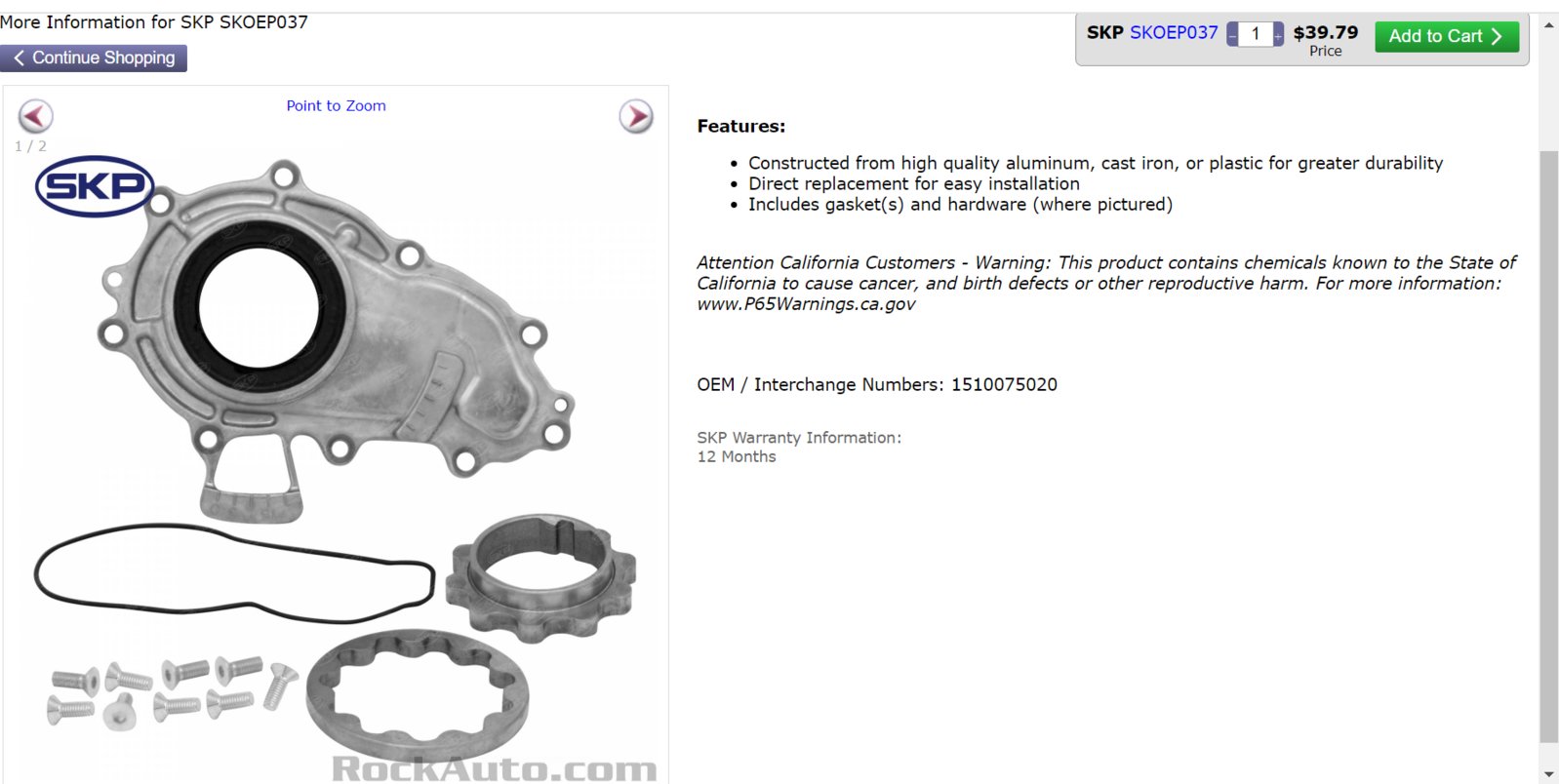

    i would just RR the oil pump assmy for $40 from RA
    includes gasket and pressed on seal already!
    new allen head bolts and pump gears
    both Thatt and I stuffed Vasoline(petroleum jelly) in the gears to pre lube
    (as recommended)

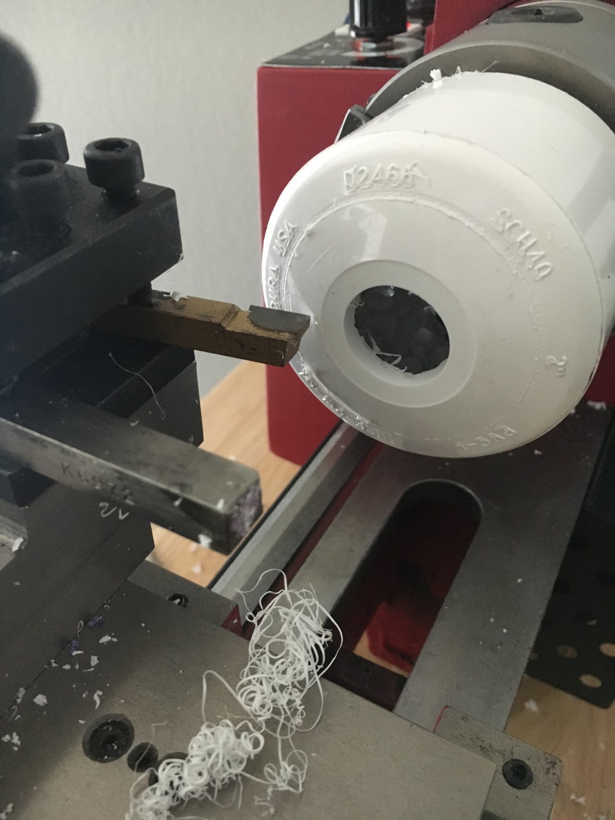

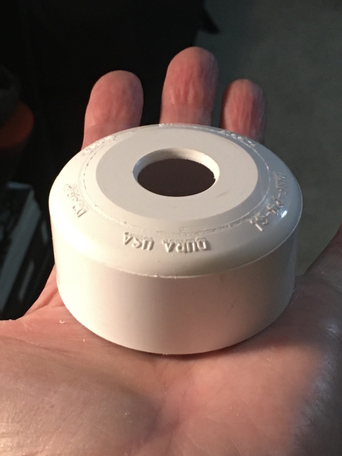

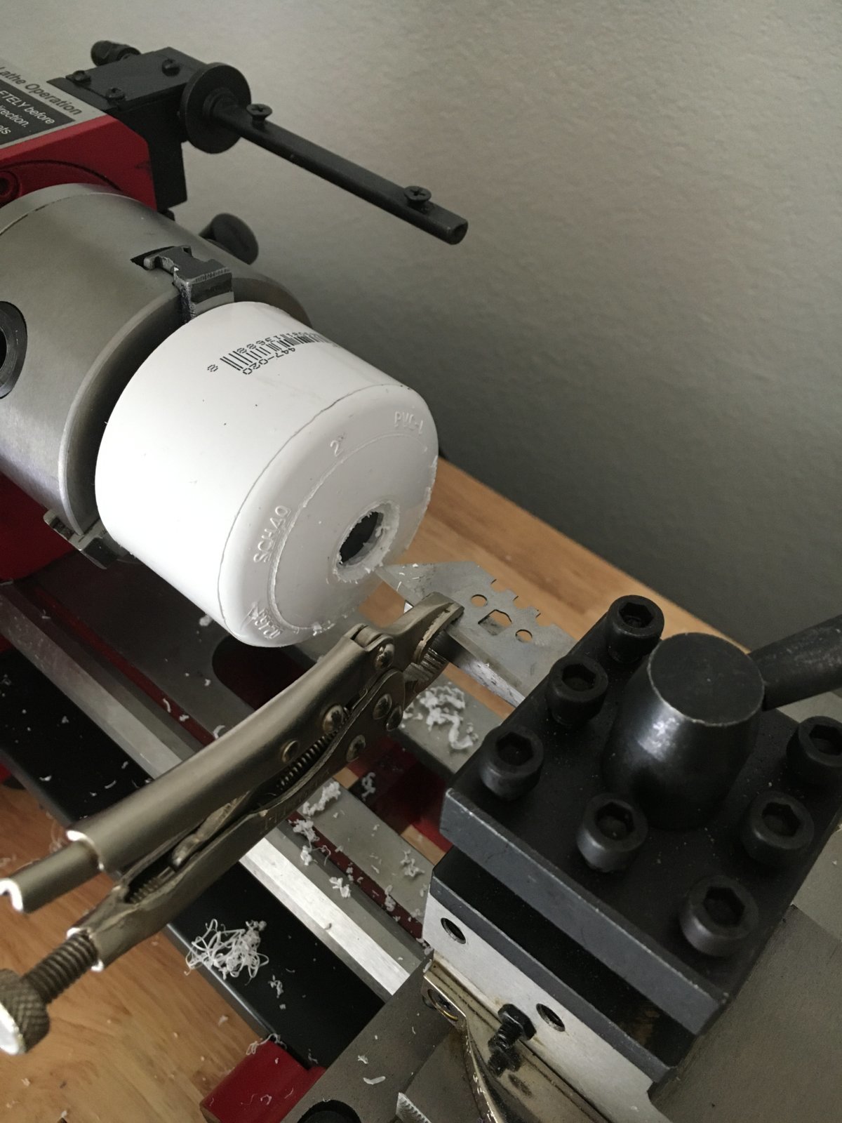

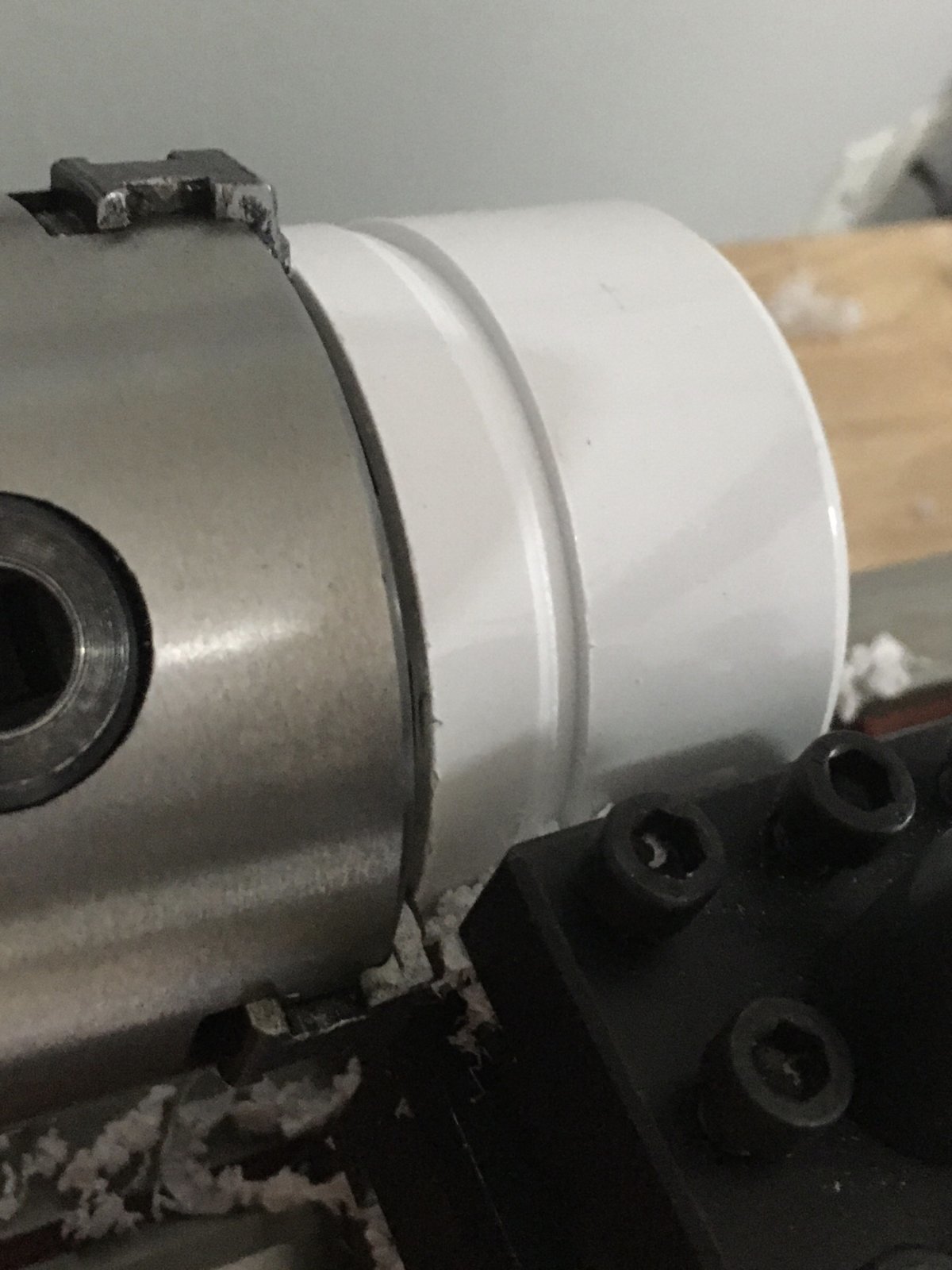

    I have access to a Harbor Freight mini-lathe here, so during all this downtime I made a seal-pressing tool that will be driven by the harmonic-balancer bolt.

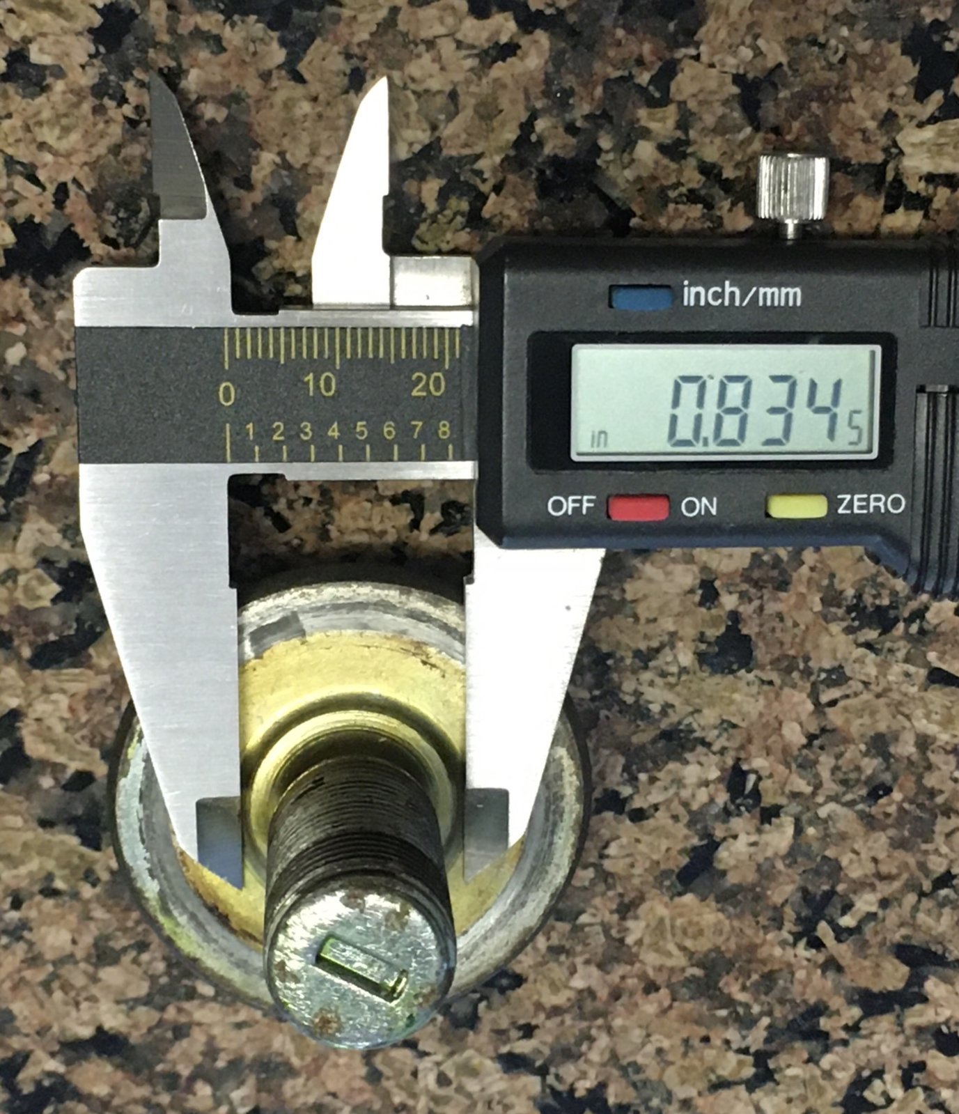

    B8C59F89-615E-493E-A09D-AA2E29B10EA6.jpg B3B243F1-8547-4123-872B-54A504EBC26A.jpg B2DB0629-80DE-42B6-86A4-B924172260CB.jpg A1B9523E-1D9E-48BE-89ED-AA54C009B346.jpg DBB75B49-DF20-46C0-9BEC-F25D6C1BDAAD.jpg 6780F25C-7501-4E01-AFC5-EB76CCA62E8B.jpg

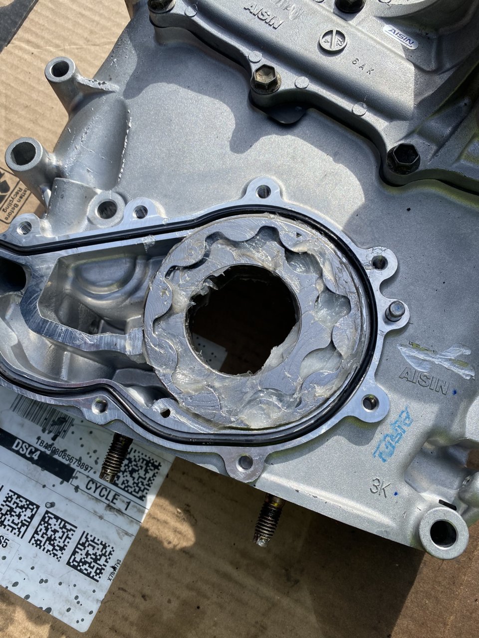

    5565C2A1-8C40-47BE-A3AC-F5778DDC49E9.jpg Because I didn’t realize that Amazon had sent the wrong seal, I unnecessarily removed my oil pump cover for better access to press it in.
    This meant I needed a new cover gasket, which wasn’t stocked by any local parts stores. No local dealers had it either, and couldn’t order without prepayment. But they couldn’t do credit cards over the phone because their computer systems were being restored after a cyber attack.
    Finally found one in Cedar Park, about 1-1/2 hours away, willing to order without payment. However, when we drove up there to pick it up, they found that it hadn’t been shipped. More calling around finally located one 2-1/2 hours south in San Antonio. So after a day of driving around, I was finally ready to reassemble last night.
    None of these dealers had the HB retaining bolt, so the original went back in.
    Control Car, I stole your idea to mark the position. About to go out and finish up. Bought all new belts as well.
