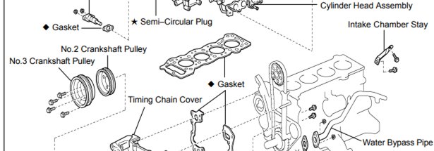

    I'm thinking I may remove at least the fan to get more room, doesnt look like its possible otherwise. also, for the new HB, the OEM is pricey. Looking on rockauto they range from $35 to $108, all of which are more reasonable than OE. But then looking at the part on the truck, there are other pulleys attached to the HB, which my understanding is that they are just bolted onto the HB, and can be installed right onto the new one.
    But then i look at the part on ebay, and they sell some HBs that have all pulleys as a set:
    Now, I'm confused. Do I need to buy the set like I see on ebay or just the one pulley?

    anyone know the part number for the crankshaft pulley bolt?
