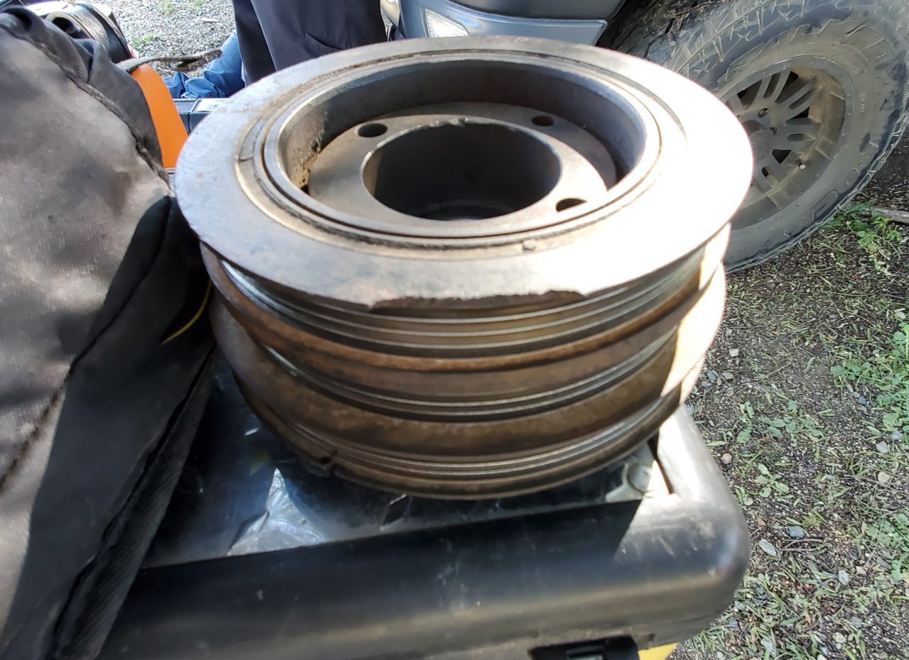

    I tried renting one from O'Reilly's and was told it didn't at all work/fit/was right one...
    And apparently had to order a new harmonic balancer/Crankshaft pulley, due to original being damaged.

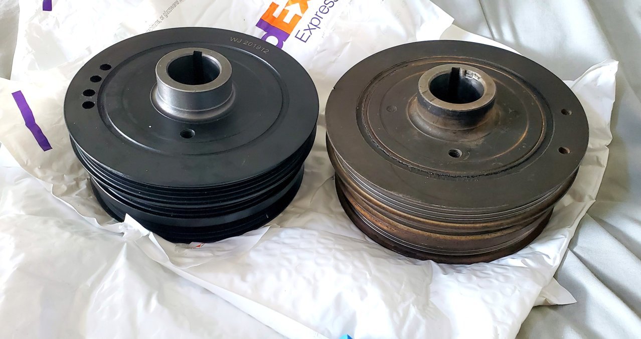

    Awesome thanks for the info Floridaze! We'll see how it goes. This is what the original looked like... :facepalm:

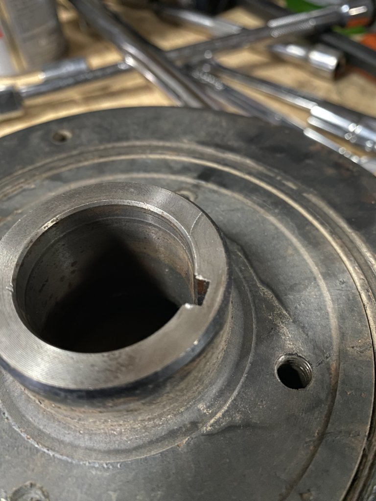

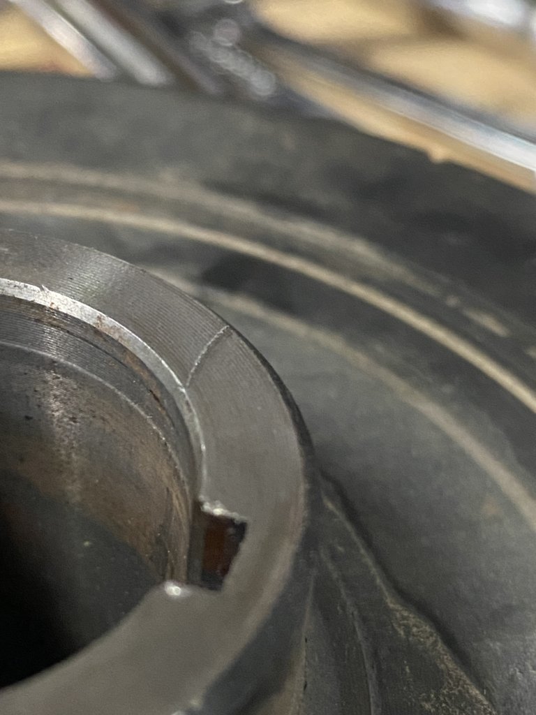

    I just got done doing my timing belt on my 5vz and noticed more crank wobble on the balancer then there should be so I tore it all back apart and saw nothing but this small mark on the balanced? Think it’s big enough to be the culprit and order a new oner? Would you go oem or aftermarket aluminum like lce which is same price

    Mine just slid on, I don't remember having any issues with it.
    Just remember to put some oil on were it slides into the seal.
    Also, use a new bolt and have fun with that.

    What is the issue with that one?
    Looks like a small scratch

    Yea but it was on the mating service and at 215+ ft points that little ding prolly made a difference. I three am lce lightweight on it since these are internally balanced I see no reason not to. Cheaper and lighter actually runs smoother than before
