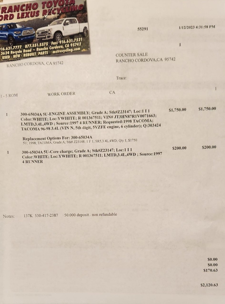

    Im replacing my blown motor with another from a wrecking yard. When I pulled the motor I noticed that the wiring harnesses are different.
    My truck is a manual and I'm assuming the motor I bought came from a automatic.
    Can I use this new wiring harness or will it not be compatible?
    My truck is a manual 1998
    Came from a 1997 4Runner
