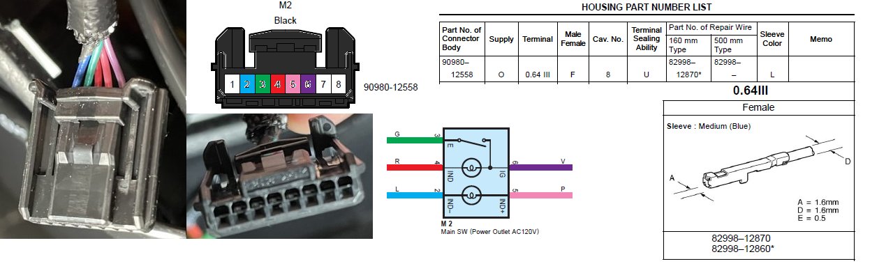

    Any one know where I could get an extended harness to move the bed outlet power switch from the left panel to the center switch panel? Alternately, does anyone have part numbers for the connectors to make one?

    No luck (yet) in finding the mating connector. Staggered Posi-taps to the wires.
