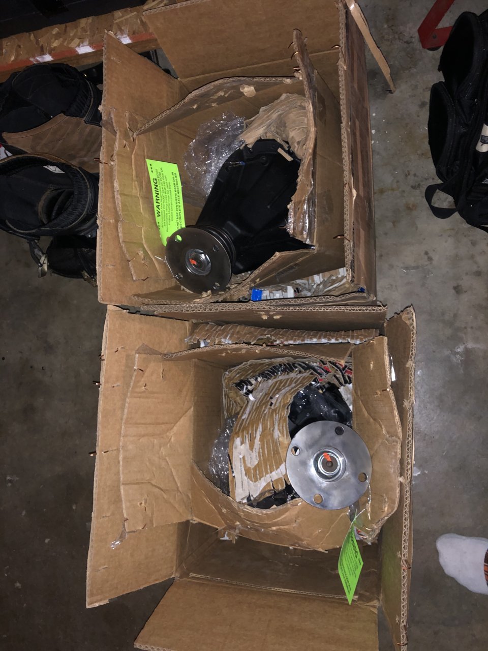

    Just got my 2 diffs delivered today from ECGS with Harrops front and rear. Hoping that these lockers also solve the driver side CV shaft slop/play on the front diff that they sell the bushing fix for. Haven't found much info on this specific issue. Anyone running them on a 3rd gen know if it fixed your driver side cv shaft play?

  11. Jan 8, 2020 at 1:52 AM
    #91
    G.T.
    Jul 14, 2010
    #40169
    19,785
    G.T.
    CONUS
    Won’t need that solid spacer with the locker in place.

    If you're able to, can you take some pictures of the third and clamshell out of the boxes. TIA!

    California
    2019 Tacoma SR5 4x4
    I’ll get you some more pics for sure. Lemme know if there’s anything else specifically u want me to check before I put them in and I’ll try my best.

    I got complete 3rd member and clamshell built and sent out to me from East Coast Gear Supply. I will be installing them myself. infact the current ones have already been removed. Waiting until Sat to install and wire them up. The rear is extremely easy to remove. if you have any motor vehicle skills and basic tools, you could do the diff swap.

    Nothing specific, just some overall shots of the third and clamshell. It’s nothing I haven’t seen on here before but I just like to check out the work ECGS has done. Hope the install goes smooth on the weekend. I have OTRATTW switches for my lockers and hope they are easy to wire up.
