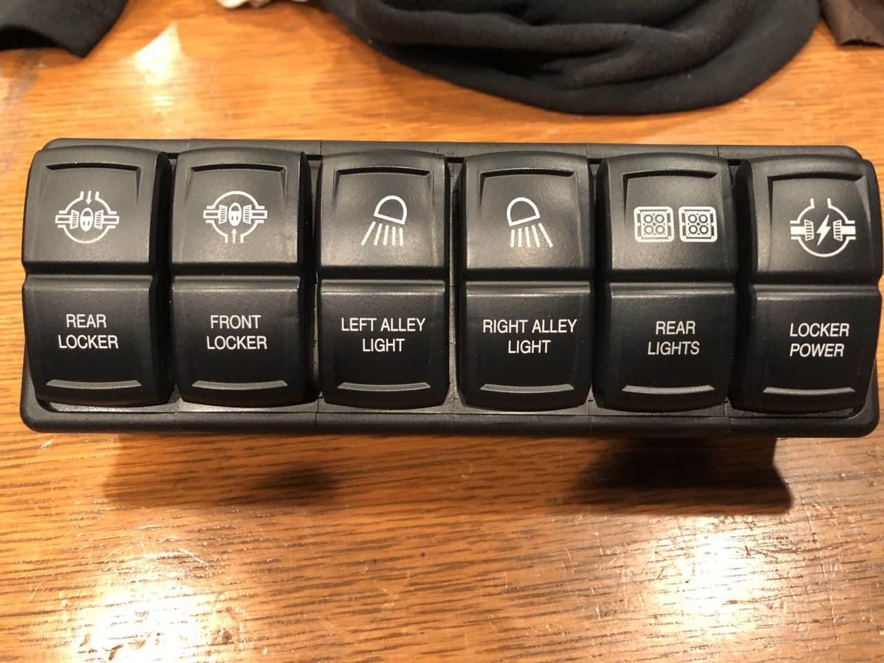

    Looks like you have Air On Board switches. I have https://www.otrattw.net/home.php .
    I’m also using a locker “power” master switch as a safety so the lockers don’t get turned on accidentally. They’re going to be at opposite ends of my switch panel.

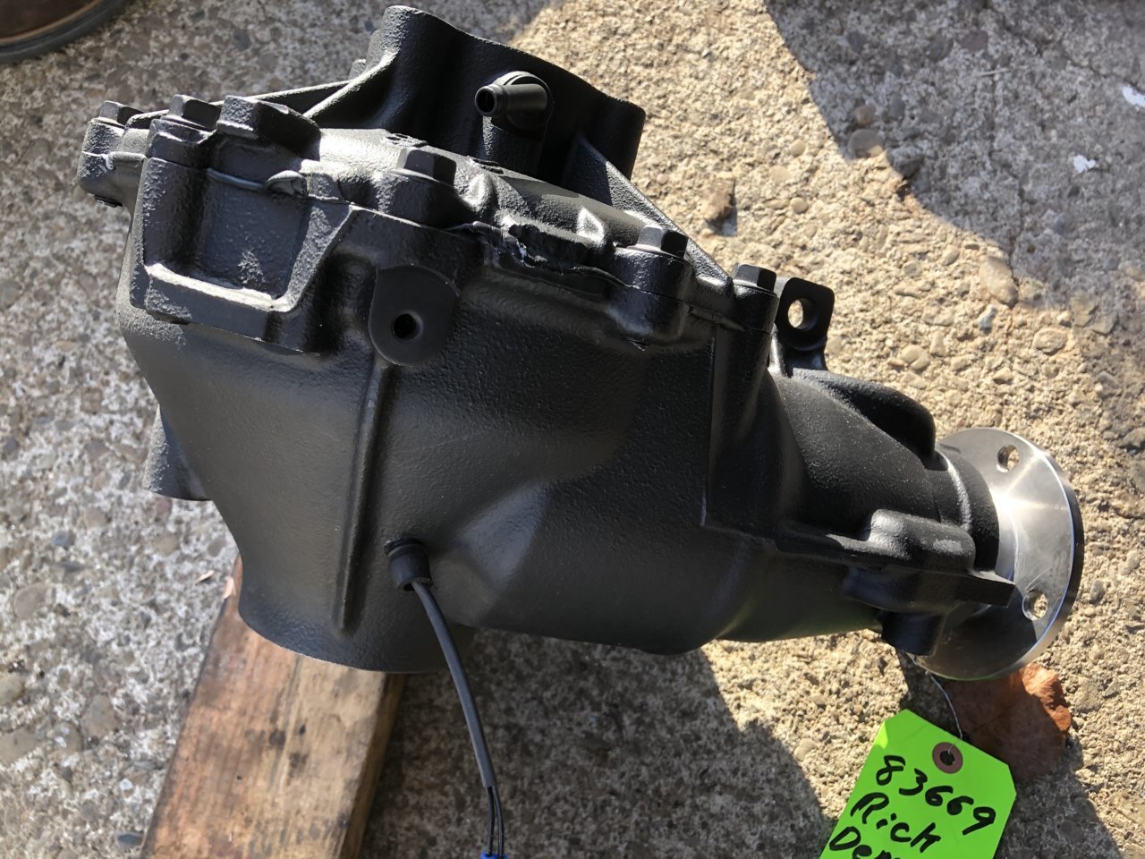

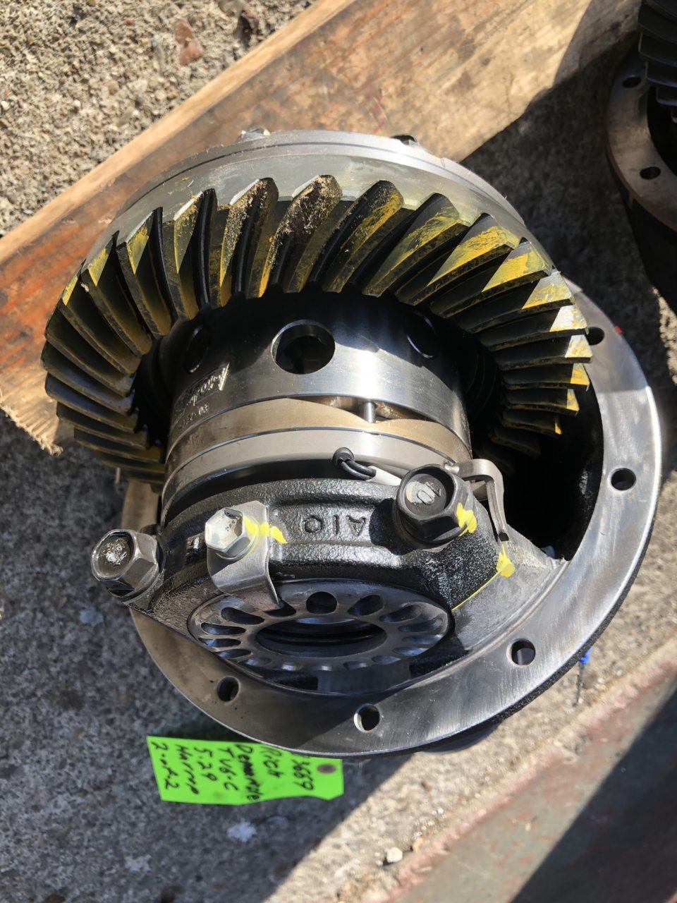

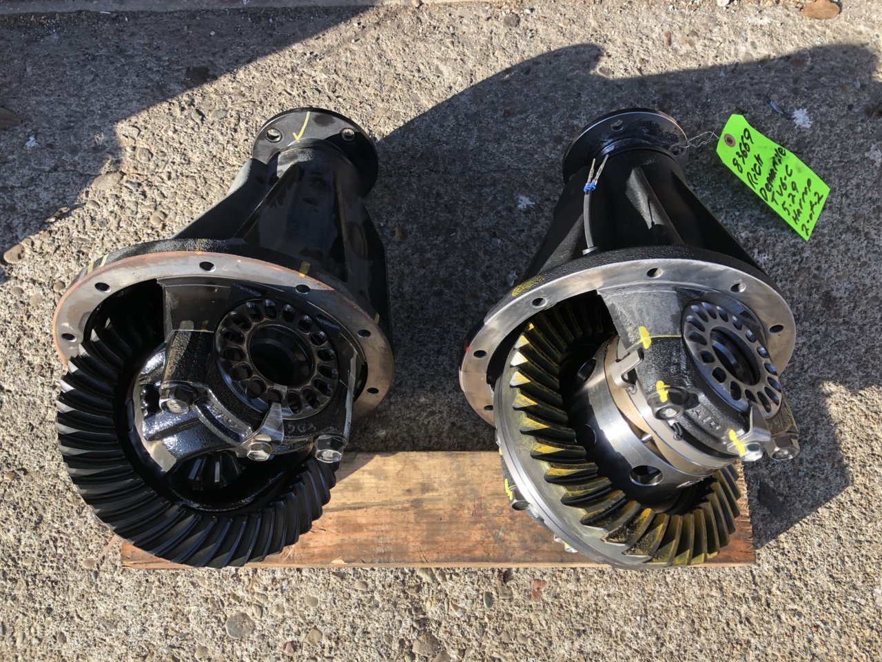

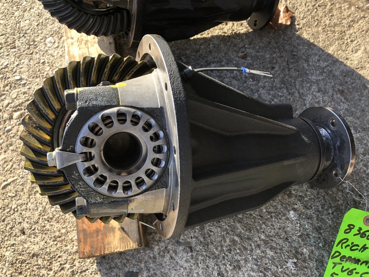

    here’s some photos from tonight. Should be finished up Tommorrow.

    Thanks for the pictures!! Those look very well put together and super clean. Does ECGS seal the Harrop plug hole where it comes out of the 3rd/clamshell?
    Good luck with the install and break in. Let us know how the gears and Harrop feel.

    yea I checked that too. They did a good job sealing up that plug hole.

    Got the diffs installed yesterday and spent today wiring up the lockers. I wired a safety switch that needs to be pressed to enable the front and rear locker switches. I havnt tested the lockers yet but checked the plugs with a meter and switches and relays are all working properly.

    My switches from air on board are a dead on match to my blue dash lights in my 2019. I highly recommend them.
