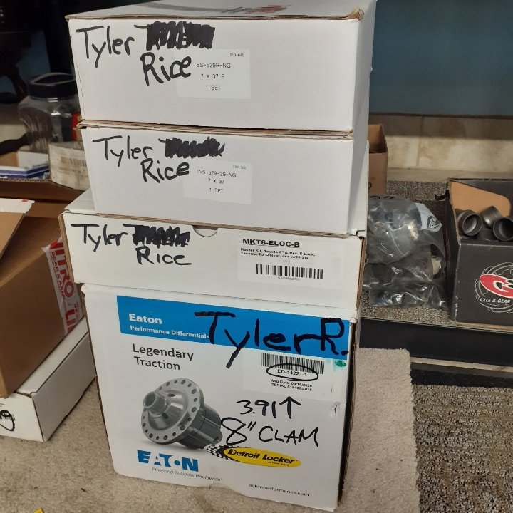

    I have 5:29 nitro gears and front Eaton e locker Getting all lined up for my truck here in November. I can’t wait. Will update once I’ve got it all installed.

    Did you ever regear with Zuk? He has my gears now and he’s doing mine next month. I’m 20mins from him

    Zuk already has my gears and locker. He’s 20 mins from me and has a legendary reputation. As soon as I have time to pull my diffs I’m dropping them off to him! Very excited. He convinced me on 5:29. I can’t wait to be overgeared after being under geared for so long

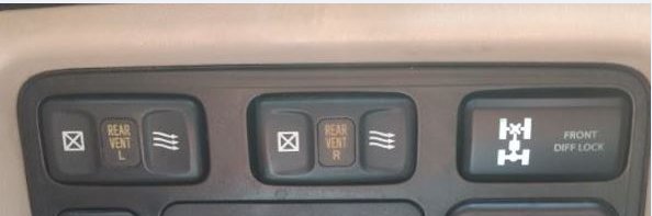

    I had Zuk build my front Harrop eLocker. One of the best mods I've ever made. Quite, engages in 1/4 turn. One-touch operation. Simple design. I had a special button made for it to fit the existing switch panel. It just works and I don't have to think about it.
