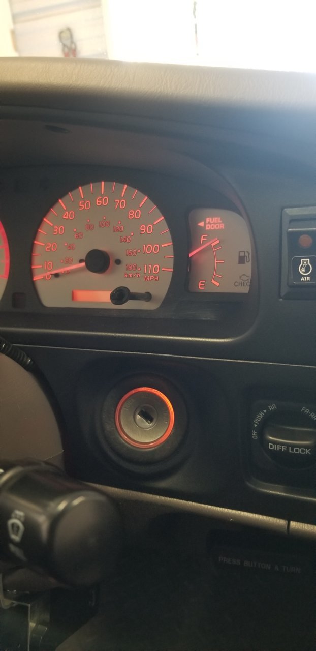

    The Harrop/eaton switch and relay are actually really nice.

    Actually that is nice, I could only find big ass ugly toggles. My diffs are being built now so haven't received them yet, but was looking ahead. Thanks, that actually is clean and will look nice up by the rear locker switch. Clean looking truck.
