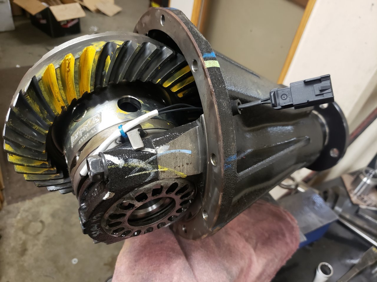

    This is what you want. We can help with the purchase if you would like. We have installed quite a few.15801534707211623635681245682569.jpg

    This one is from a 2019 sport auto with 4.88's at the same time.
